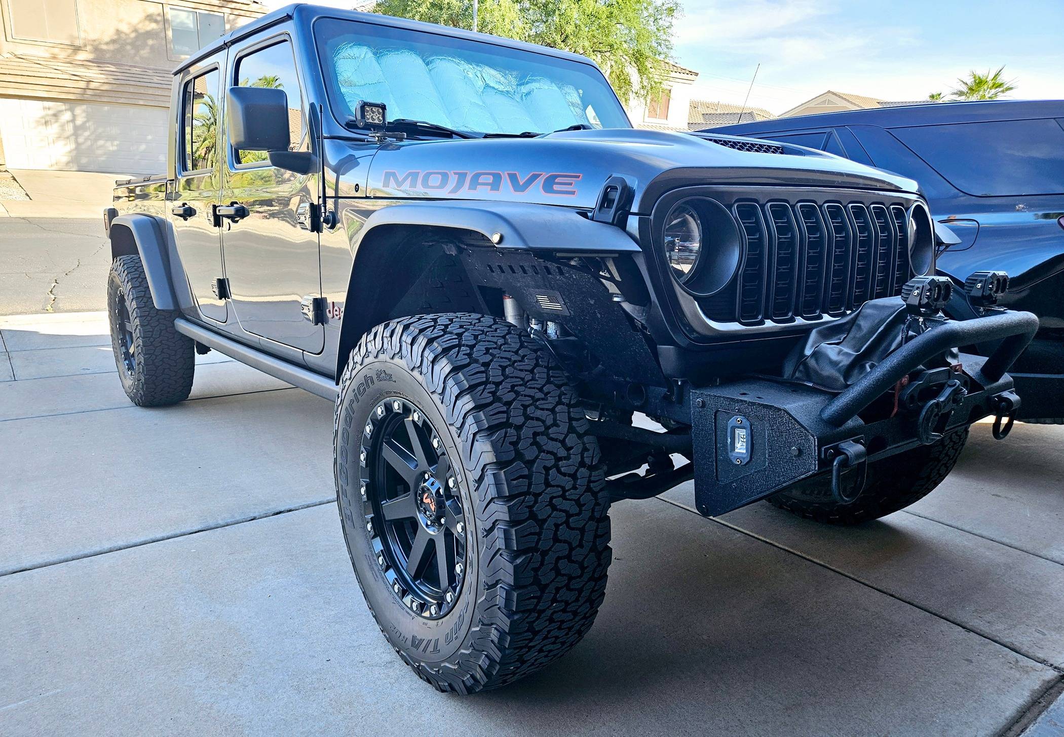

I bought this kit off Amazon, exactly enough to do my '24 grill swap. Came out great.

Must have been a bad batch, not a single issue with this brand/batch. Everything laid smooth and flashed really quickly.
