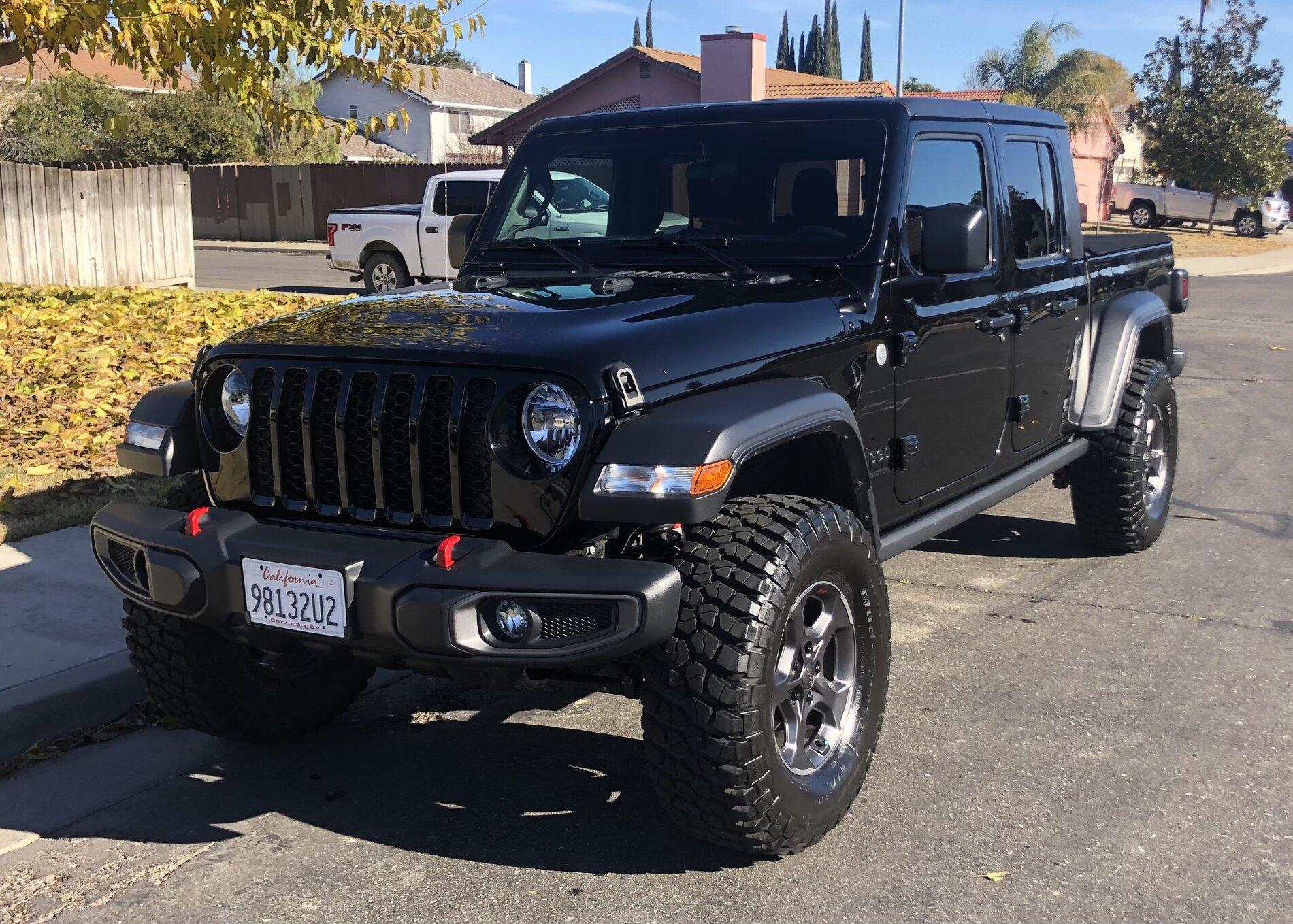

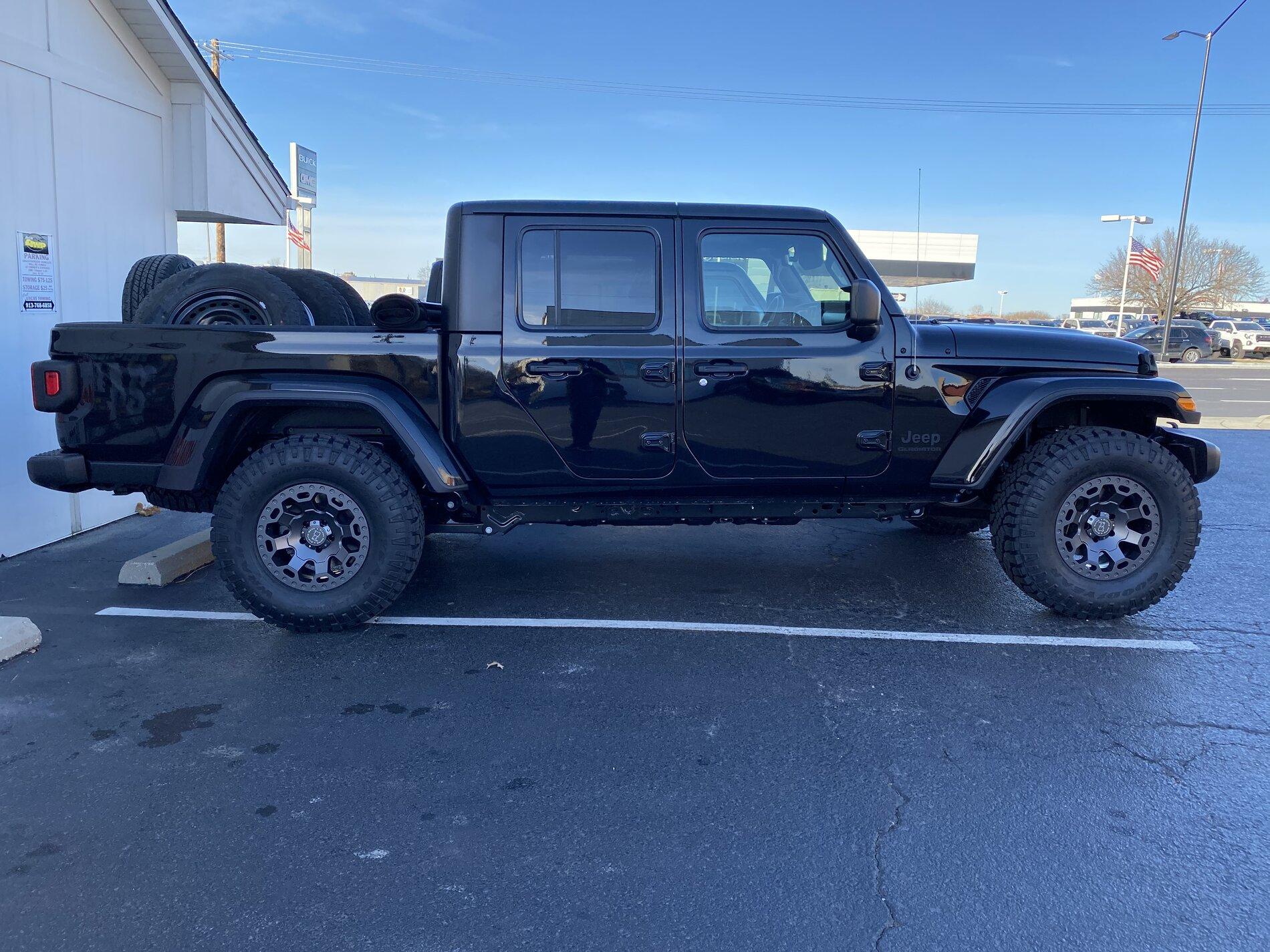

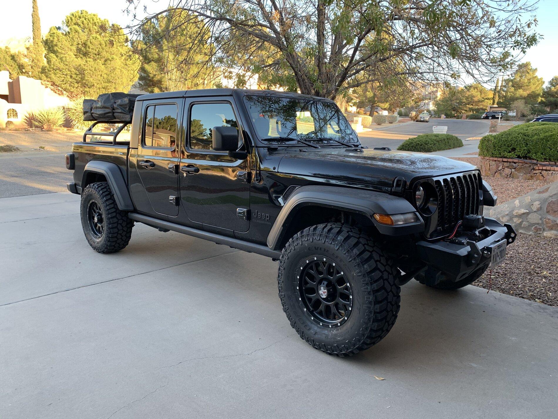

yes it levels it out perfectly on a max tow. Towed a travel trailer thousands of miles like this without issue. Eventually got some rubicon front coils that I installed the same spacer above to give me 3.5” in the front with the Fox shocks. The fox shocks alone in the rear gave me 1 1/4” (retained my max tow rear springs) so only needed a 3/4”spacer to the rear to level. First pics is with just the 1.5” spacer up front (was running 33’s at that point). Second pic was before I added the 3/4” spacer to the rear, and 3rd pic is the with it (and 1.5” wheel spacers). Cheers

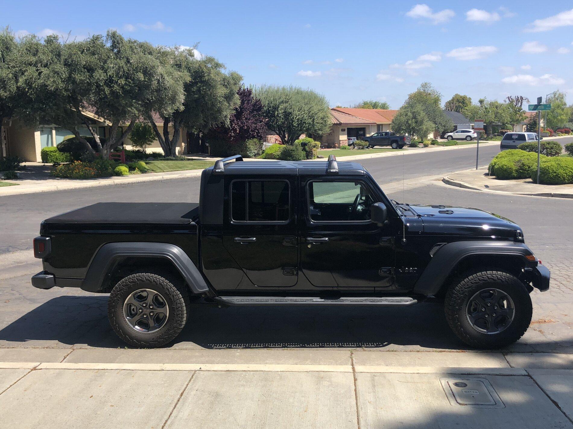

I’d say it even’s out just fine honestly. It’s also going to depend on front end weight vs load weight.

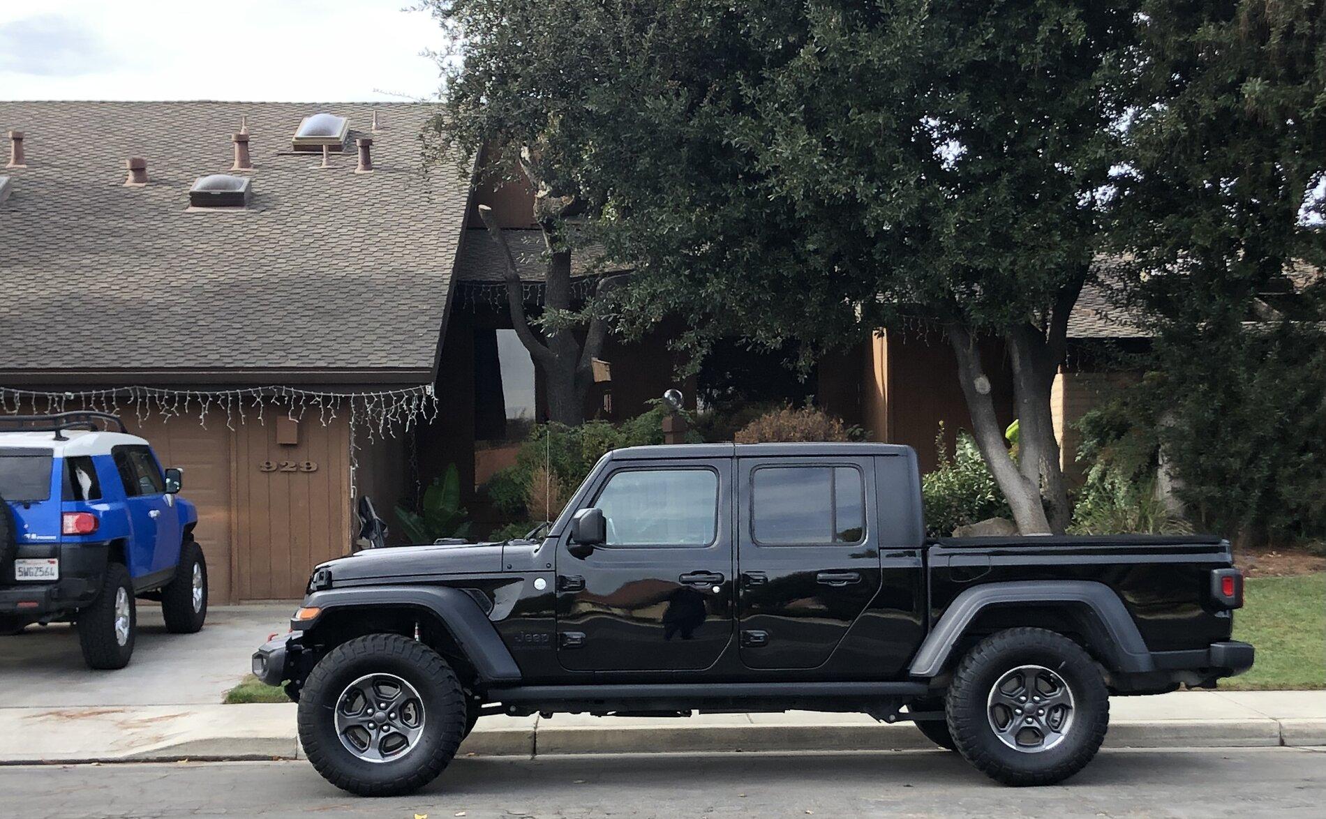

Black Rhino Warlords 17x9 (-12mm) with Duratracs 35x17x12.5 with Teraflex 1.5 front level Sport S/MaxTow. Also put airlifts in the back if I ever need some Tow support. Perfect level and love it!
