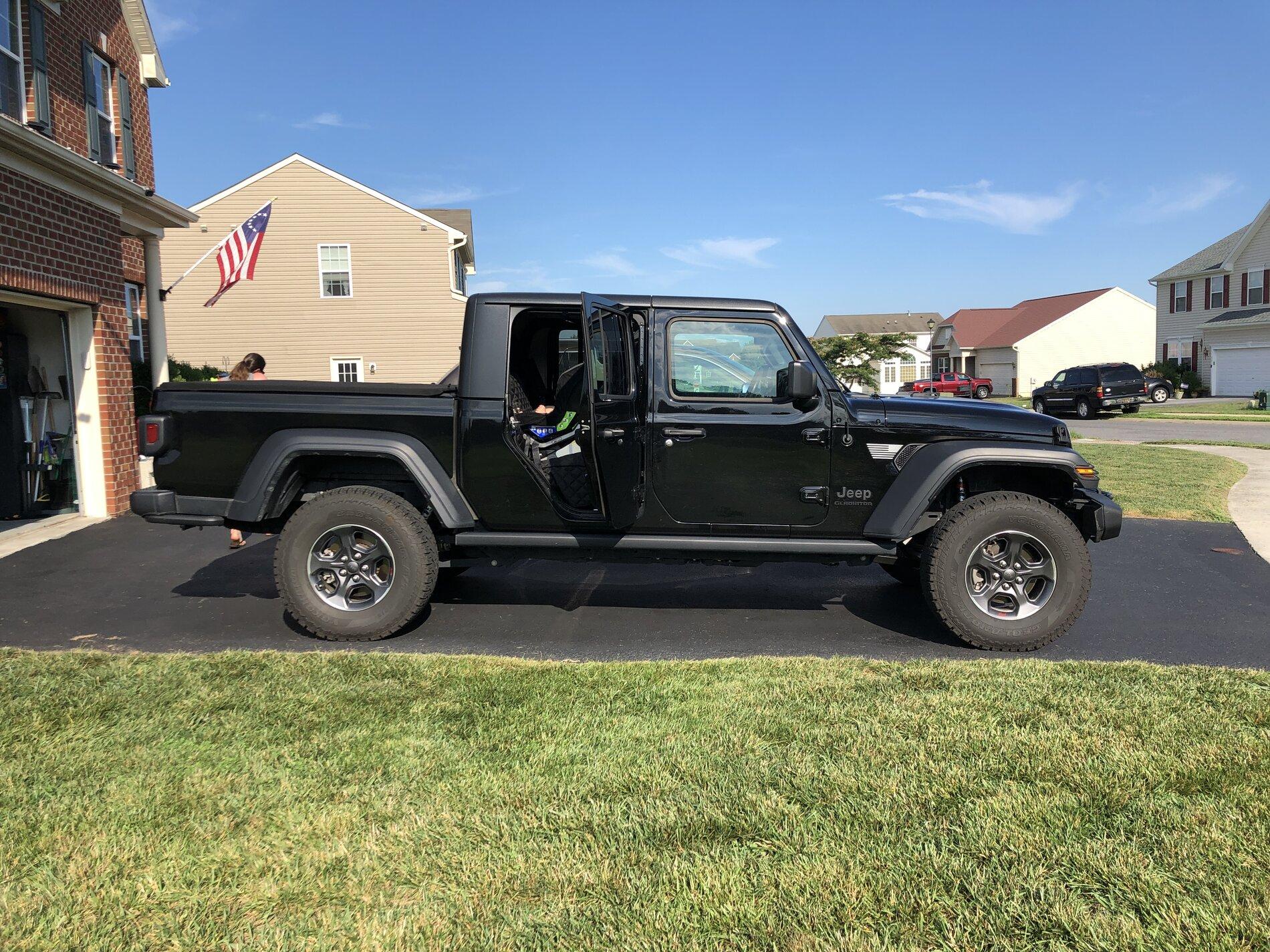

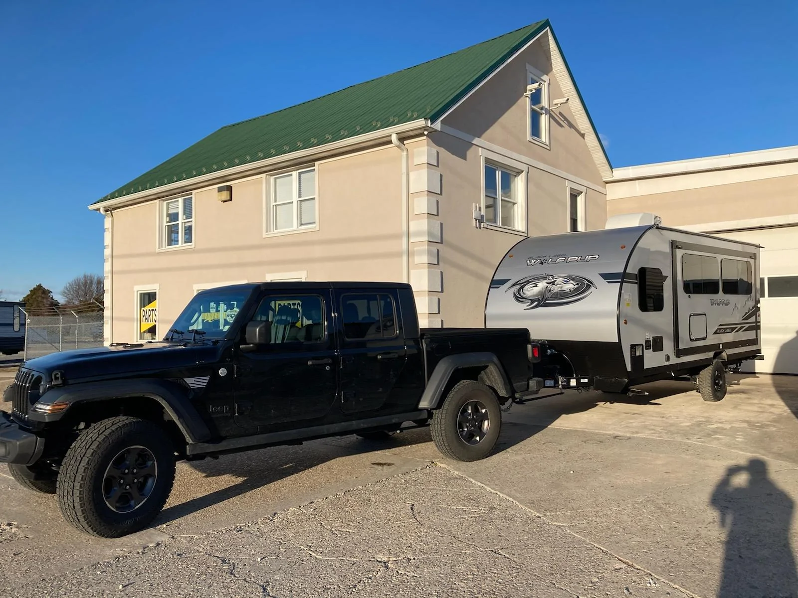

I have the iron rock 2in and love it.
The spacers keep the rake but its not as noticeable to me as it is when its stock.
Just got my camper. 430lbs tongue weight, 3800lbs trailer, with weight distribution hitch. Sits just right as far as im concerned

Looks good! How's the ride? Did you get new shocks or just use the extentions?

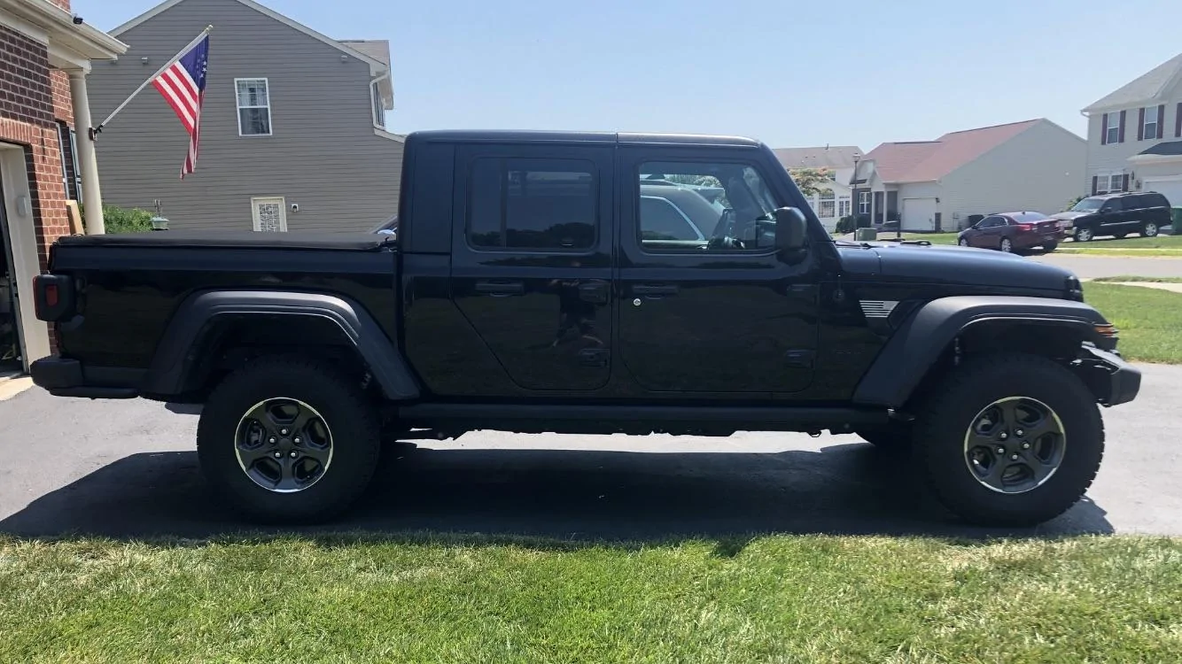

Is this 2” front and rear? Also what size tire you running?
Yep, 2in front and rear. I added an additional 1/4in spacer in the front though.
285/75/17 yokohama geolander g015’s

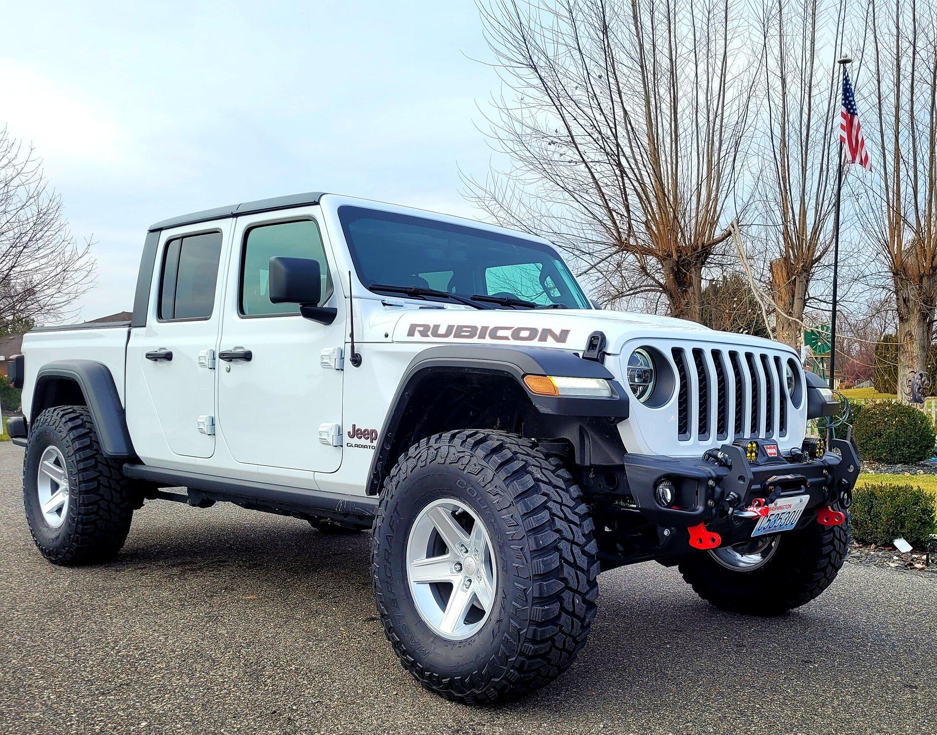

I had a Teraflex 1.5" front (poly) and swapped it out for a RC 2.5" (steel) spacer lift. I wanted to gain back what a winch and bumper took away.
I can't tell the difference poly vs steel. The spring still rides on the factory rubber isolator.
Also running the Mopar 2" lift lower front control arms and Daystar rear .75" spacers. Still has a little rake to it.
Still debating on a complete lift. But, this thing rides and drives great, and it will be very very easy to take it back to stock if I ever need to.

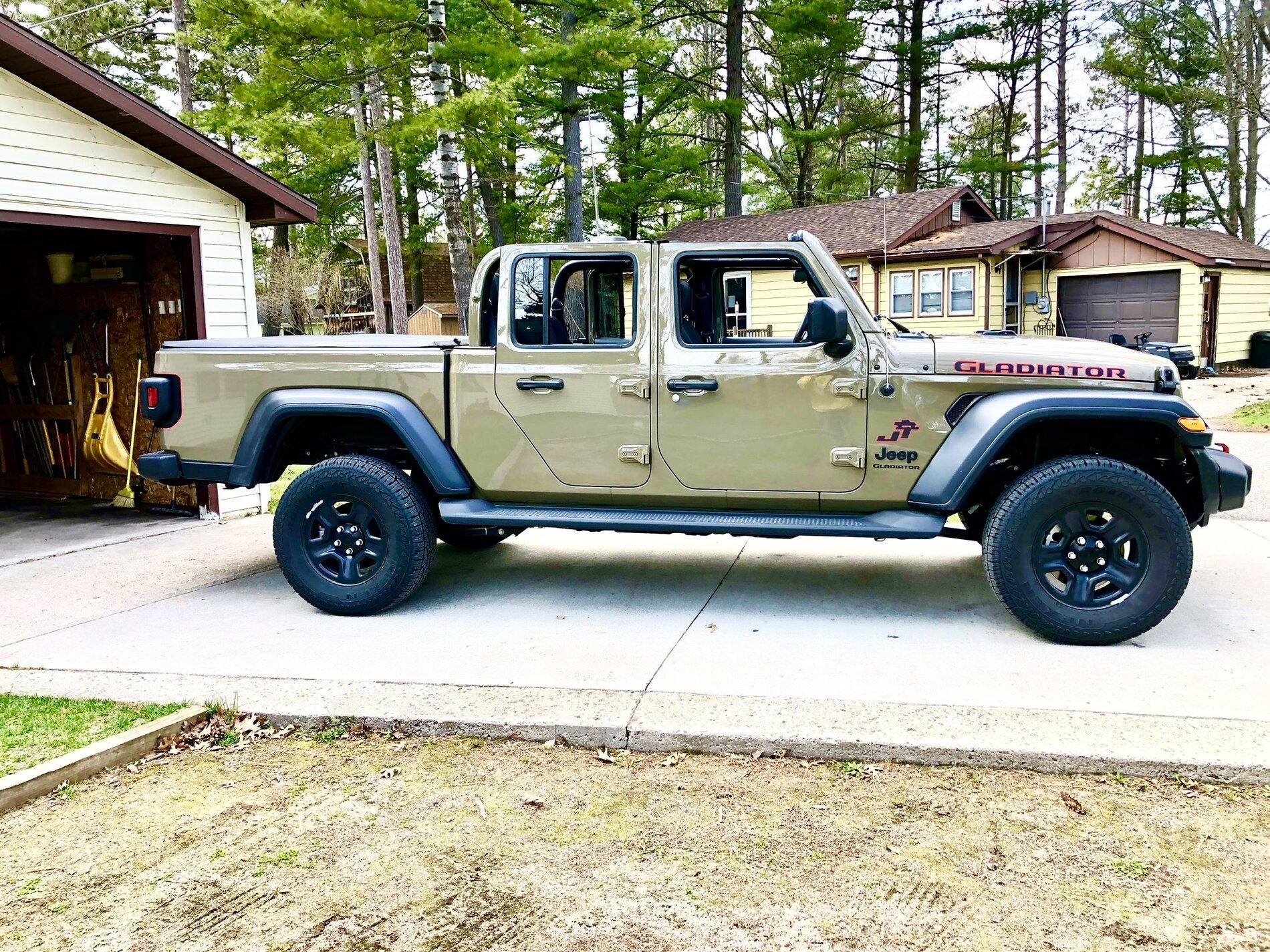

Jeep Gladiator Spacer lift qiestion D9D75010-3A8F-4750-A39A-55A1681F69C4
II
I did the Iron Rock 2” and love it. Pictured with 285-70-17s. Just remember to loosen track bars and sway bar links on install and retighten to factory specs when all four wheels back on the ground.
