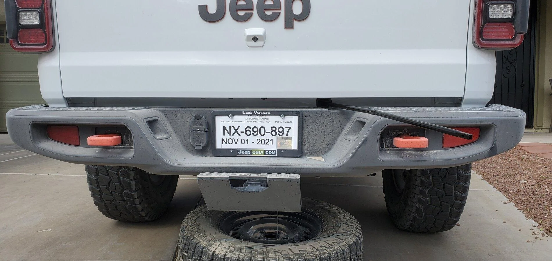

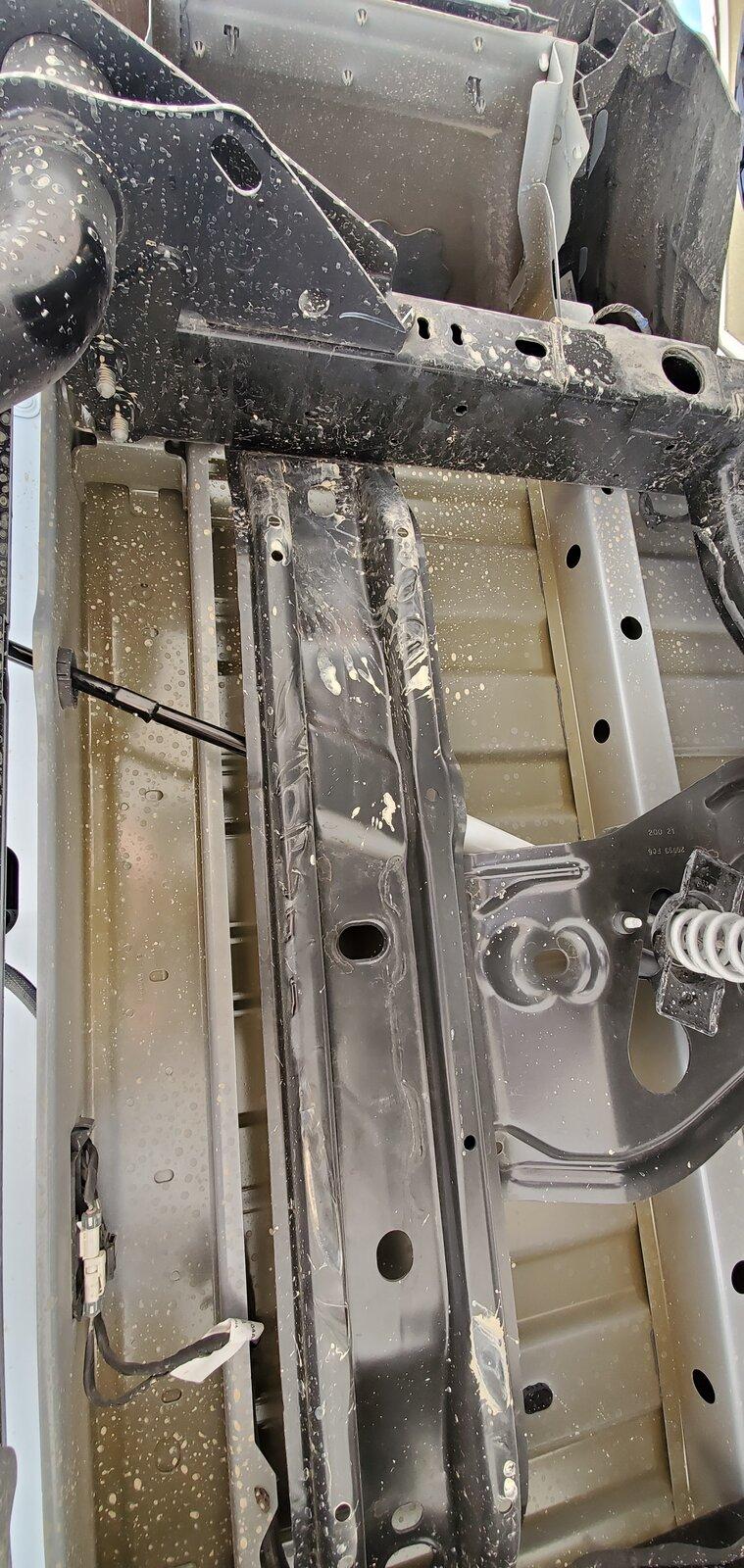

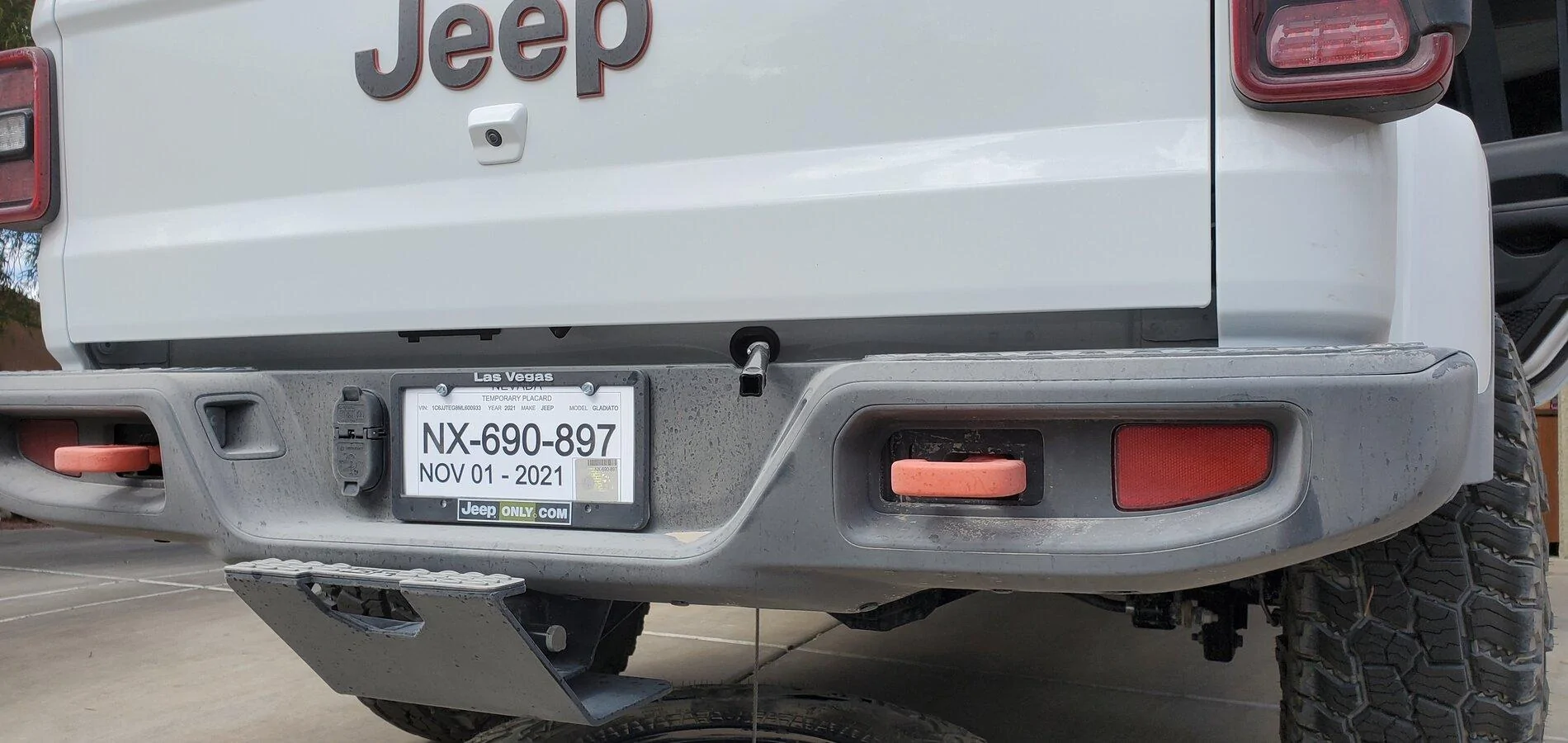

Hope these help.... I went down to remove mine, selling factory wheels n tires. And sure enough.... its at an angle to the left. Hope the pics help somewhat.
