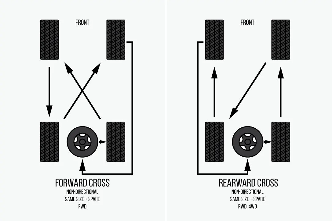

For those who matched to spare do you rotate it into the tire rotation pattern? Installed a tpms?
TPMS-yes. The Jeep will pick up the sensor when it starts turning.
Reward Cross rotation as shown in the pics above
