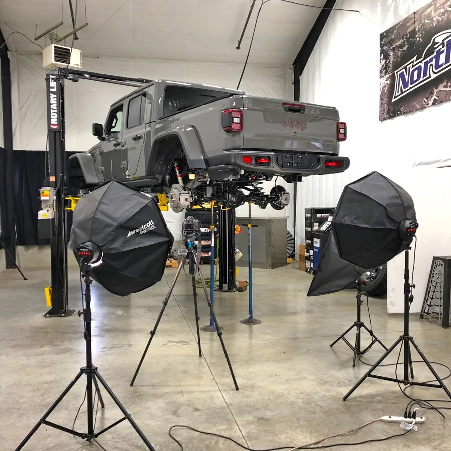

We recently built up a Gladiator for a local customer. The cool thing is he wasn't in a hurry, so we had the time to do the build up in the studio and take some video of the various products going into it for our YouTube channel (https://www.youtube.com/northridgenation).
Within a few hours of receiving it, it was on rack and strip down was started:
List of parts for this build:

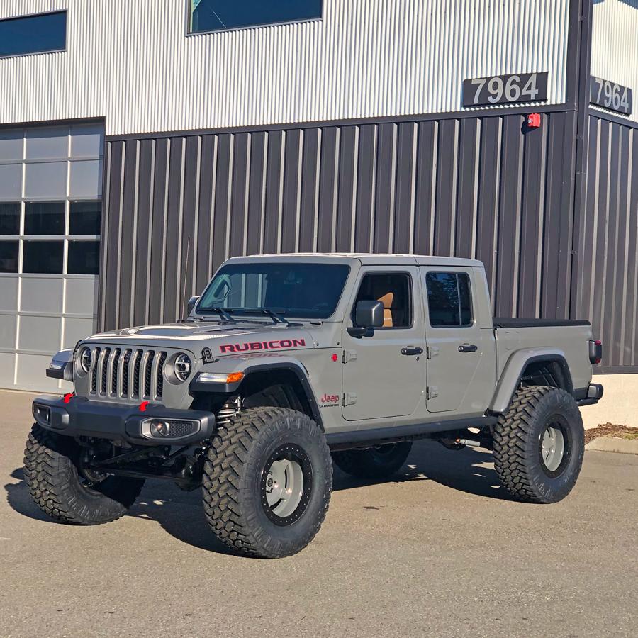

Of course we had to lift it, so we tried out the brand new Rubicon Express 4.5" lift:
Videos are still in the editing stage, will be posting them up soon!
Until then, here is a teaser pic of the Gladiator after the lift and tires:

With a big suspension, we needed some big wheels and tires to go with it, so we mounted up a set of 40x15.50x20 Nitto Trail Grappler Mts on a set of 20x10 ATX Slab Beadlocks.
Where do you find tires that big? https://www.northridge4x4.com/part/tires/n206-850-nitto-trail-grappler-m-t-40x15-50r20lt-tire
For that custom touch, the customer had the Slab beadlocks color-matched in the Sting-Gray body color. We weren't sure how they going to look at first, but once we got them on the Gladiator, they color-matched wheels really added to the look.
Unfortunately the Slabs beadlocks are no longer available from ATX, this Gladiator owner bought the last seven we had. Why seven? He plans on building a trailer to match. We'll definitely post up pics if he does.
