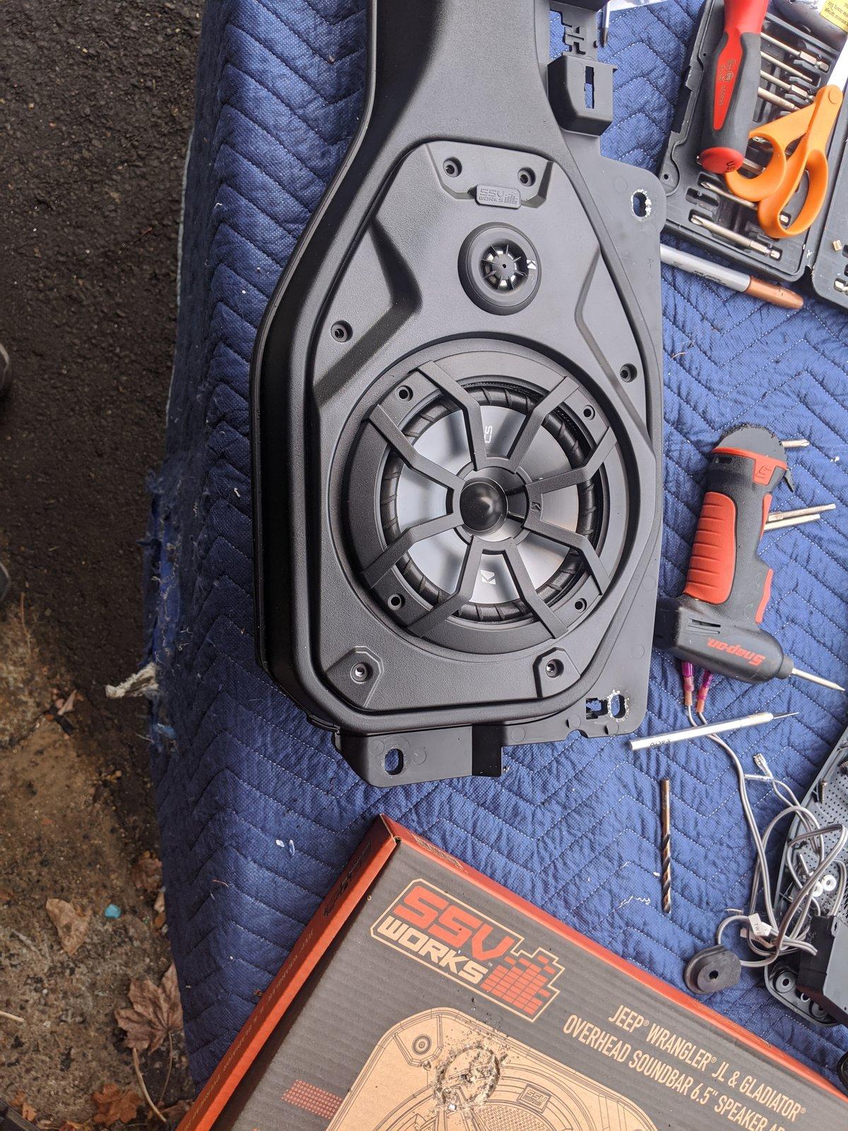

Im running components front and sound bar, I have the metra housing in the dash and just made brackets for the tweeters in the upper dash.
Originally I made my own adapters to run the components in the sound bar. They worked great and fit everything under the stock grills. But when these adapters came out I grabbed a set because they looked cool.. very happy with them

Which kickers are you running here? Are they marine grade?
BigRed97
Tim
Sep 25, 2019
491
273
Boston, MA
Gladiator Sport S
They are CS series ...I had taken them out of my JK before trading it in. Not marine grade but I'm not worried about them getting wet. And if they do some day I'll put in marine speakers

Oh and the sound bar adapters are from SSV ... Didn't even realize the box was in the pic

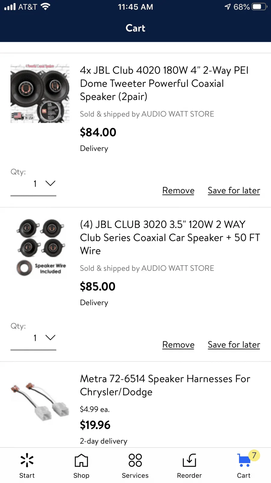

I’m placing this order today. Hope to notice a difference over the stock speakers.
Jeep Gladiator Speakers 0D1B42F4-E2B9-4430-ADE3-E0AAB953D018
