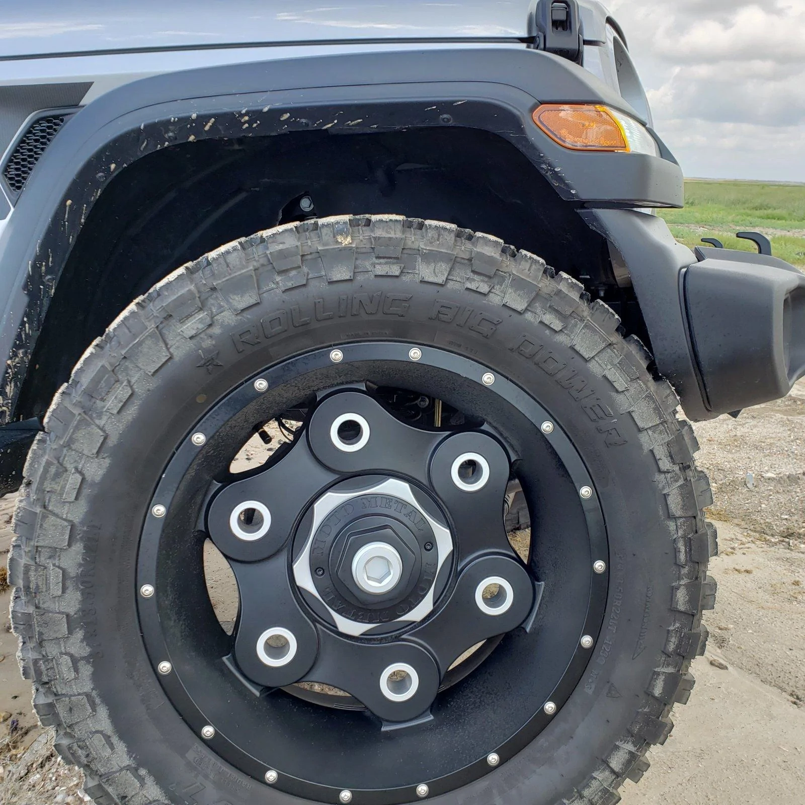

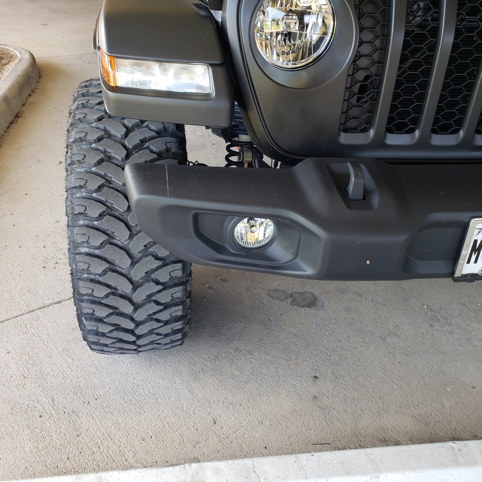

The high line fenders that come stock on a Rubicon are available after market for ~$600-700. I believe that and removing the air dam is all you would need to run 35's. See below for air dam reference: 1st pic with and 2nd pic without.

Thanks. Looks better without it anyway. I think the Rubi sits an inch or two higher also, are you saying no lift required for 35's with just the Rubi fenders?
