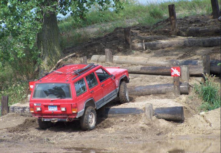

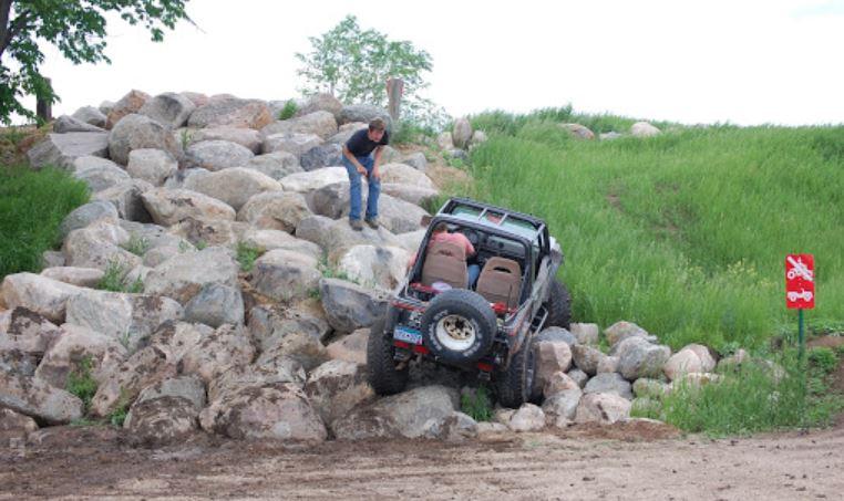

This is a bit of a departure from the original post but we're still in the suspension forum...
I never took my previous F-150 off-road more than gravel roads to fishing holes. Other than that, I've owned sedans. These obstacles are at my local off-road park. I want to be able to climb the logs and I'm just curious what you guys think it'd take to get up the rocks in a Gladiator.

Appleton, I've climbed up those rocks in my JKUR. With the added length of the JT I'd say 2.5 lift and 35s will make that climb more comfortable than 33s. I will post a pic of my JT Sport S (non max tow 6spd) on a rubi suspension with rubi sized take off tires (33s). So far I've gone through some trails in CO (Imogene pass, Ophir, Engineer) and its done great with some minor rubbing on the rear bumper, LCAs, and rock rails. My plan is also to go 2" of lift and 35s. I've also added front and rear steel bumpers for clearance and protection.
