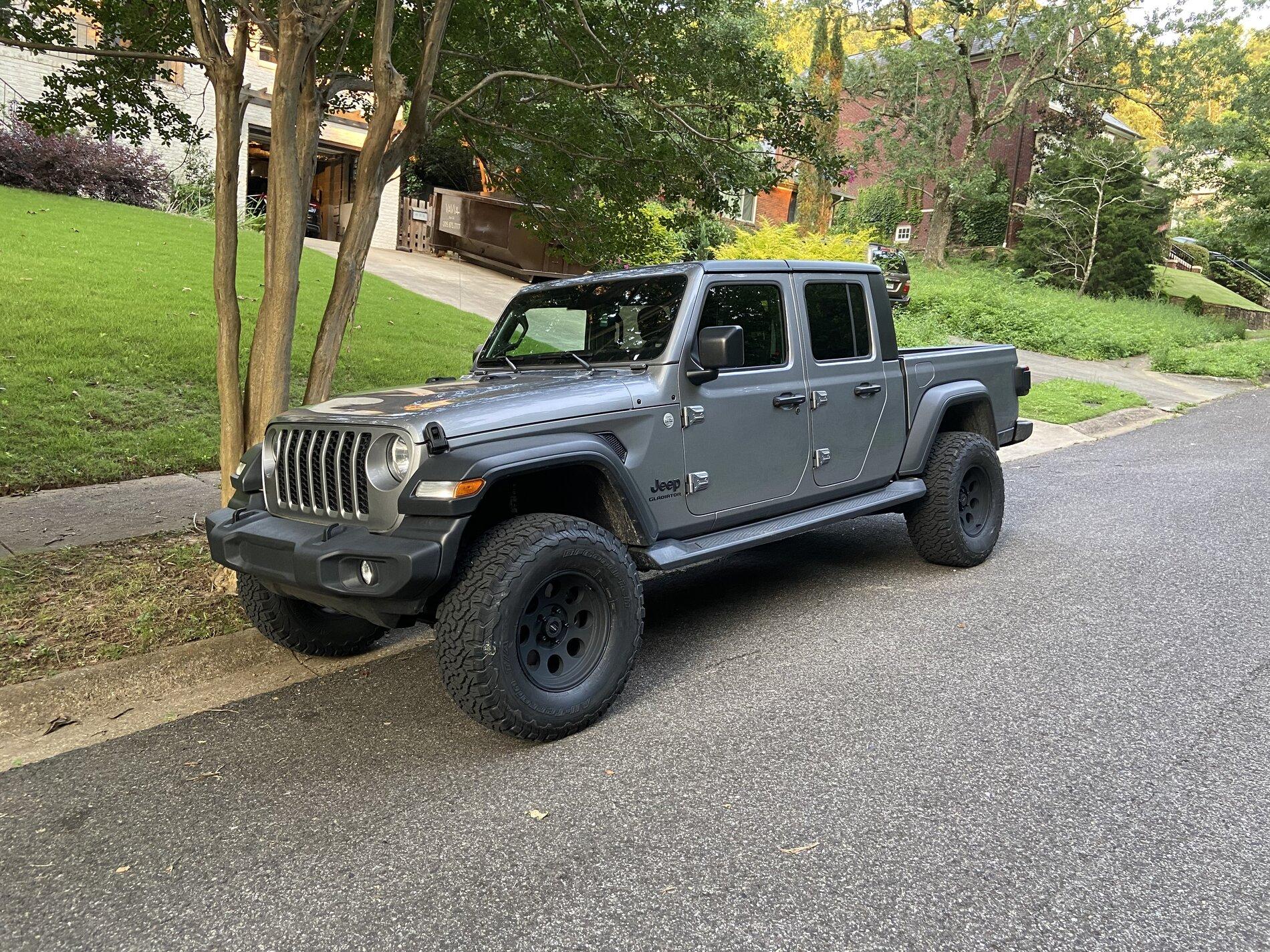

Wrapped up first part of the build - pro comp 7069 wheels, 315 ko2s, mopar 2” lift with daystar leveling kit in the front. I added steer smart drag link and adjustable track bar in the front, Rancho geometry brackets, and rubicon express adjustable track bar in the back (all done with some serious help from friends and family - learned a ton but imminently doable with a good set of tools).
Next steps are to dremel off the bumper end pieces to get rid of rubbing, figure out what I’m gonna get to recalibrate the computer for the odometer/speedometer etc…(recommendations welcome), get some adjustable rear control arms to address the pinion angle (pretty surprised the mopar kit just leaves you at 4 degrees in the rear?!?), and adjust the front headlight angle, and upgrade the sway bar end links. I’ve got a deposit down on an RSI Smartcap which is supposed to show up in July (fingers crossed) - once it arrives I’m planning to rent a camp trailer for a weekend trip to North Carolina and see whether it feels like the investment to regear to 4.56 is warranted… but feels pretty good to get it sitting right and looking right!

You might want to also consider some sway bar disconnects and air compressor.
When trail riding washboarded and rutted roads, airing down and disconnecting the sway bar are the first things I do. I use that more than the lockers on mine.
Thanks for the advice! - I've got the rubicon express sway bar disconnect kit ready to install once I get a free afternoon. Any advice on best air compressor to go with?

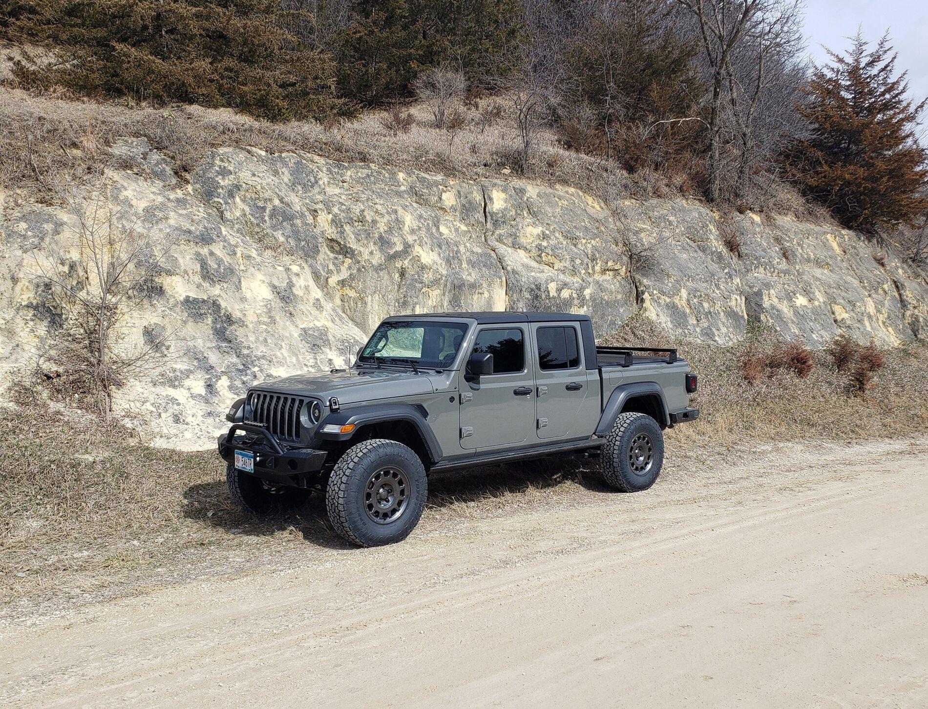

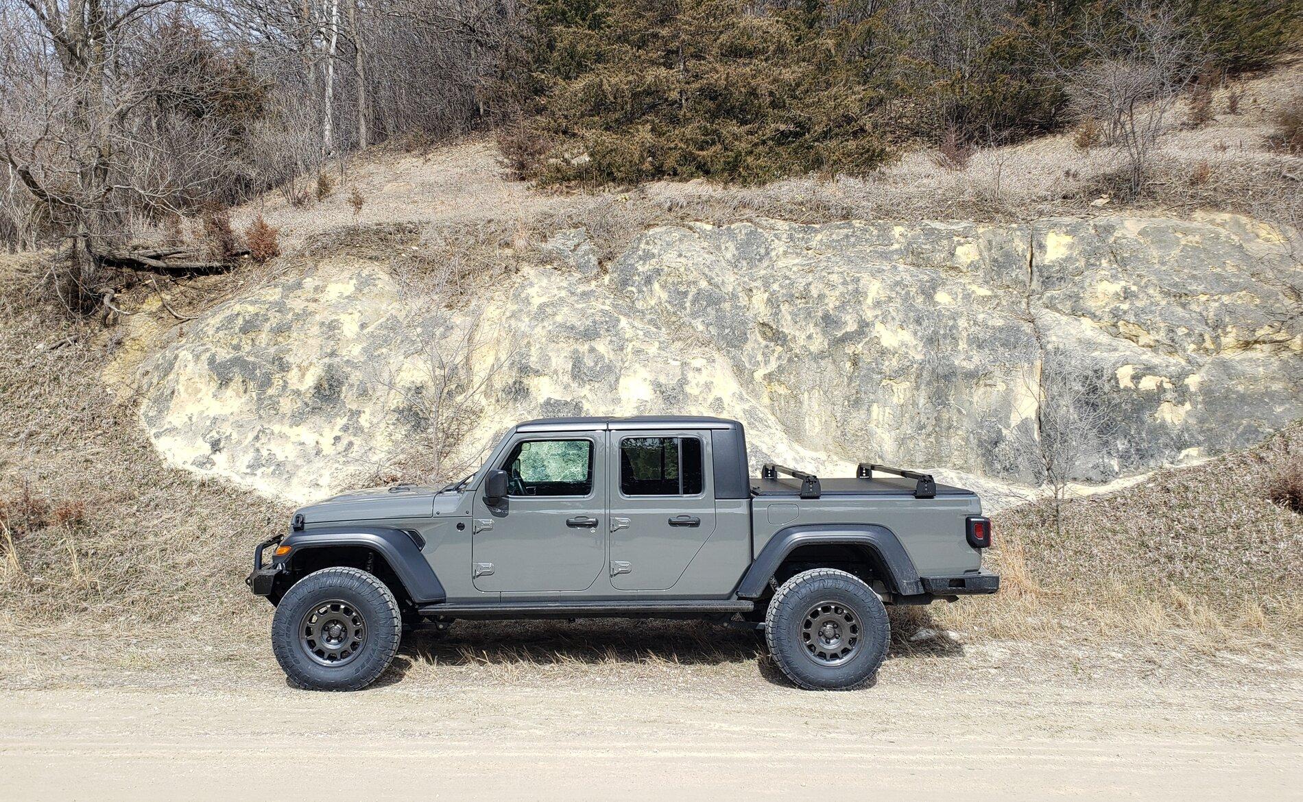

2020 Sport S 6MT (no max tow available w/ manual trans)
SUSPENSION
- 2" MOPAR
- Teraflex adj front TB, EVO adj rear TB
- Teraflex 1" leveling spacer (counter my bumper/winch combo)
- AEV geo correction brackets
- Matched the shocks w/ a Fox steering stabilizer
- JKS quick discos (swaybar)
A few notes about my experience upgrading the suspension. I first tried the Rancho geo correction brackets and used the longer LCAs that came with the MOPAR kit. There was too much caster with that combo, so I recommend sticking with your stock LCAs if you do geo correction brackets. Also, I swapped my Rancho geo correction brackets for AEVs. I don't think there is a giant difference in their performance but the AEVs do look much better built, like something that would come from the factory. Yes, they are more expensive but if you are keeping this truck for a while I'd say buy once cry once, I recommend the AEV geo correction brackets. The sway discos help immensely offroad. There are many brands at varying price points. My JKS work fine but they can be a pain if you are not on level ground and you will grease up your hands.
WHEELS/TIRES
- AEV Salta XR 17x8.5 +25mm offset
- Toyo ATIII 35/11.5R17
The wheel fitment is perfect in my opinion. The tire sits right in line with the fender, does not poke out, and does not rub. I went with Toyo ATIII because they are C rated (didn't want a stiff ride), came in 11.5 (didn't want a wide tire daily driving), and 3peak winter certified (live in MN). They are louder than my previous KO2s but have been an excellent tire so far. The wheel/tire set up weighs in around 97lbs, only 3lbs per wheel/tire heavier than my old combo. I ran a quadratec hardrock wheel with +10mm offset and 285/70R17 KO2s prior to lifting the truck. It stuck out about 1"-1.5" past the fenders.
BEDRACK
- KBVoodoo crossbars
- BuiltRight utility rail
I went with this combo to mimic the MOPAR trail rail system, be used with a tonneau, and easily removable for access to the bed. Tent on top, gear in the bed.
MISC.
- AEV procal
For tire calibration and regearing. Simple, cheap, wont mess with the dealer.
FUTURE NEEDS
- regear 4.56
- LCA skids, diff skid
I am regearing to 4.56 after my last trip. On road and off it's clear the 6MT needs some taller gears to be efficient.
I know you have started your build, sorry for seeing this a little late. Hopefully it is still helpful and may help someone else in the future.

Looks great @RodRecket ! Will definitely consider switching over to your wheel/tire once I wear these out - would have preferred to keep them in tight. I'm about 3" out from under the fender now. Trying to figure out if rockblox or similar + a wider fender (looking at rugged ridge tube fenders) will help mitigate the mistakes i've already made :(
One question on your build - what drawbacks did you experience with having too much caster? Was it ride? Wear?
RodRecket
Sep 13, 2019
995
1,260
Minnesota
2021 AEV JT370
I didn't really notice anything while driving in the short amount of time between swapping LCAs but I know 7.3 degrees of caster (what I got with geo brackets and longer LCAs) is out of spec. I figure the specs are provided for a reason, plus the geo brackets are designed for stock length so it made sense to me to switch back to stock length.

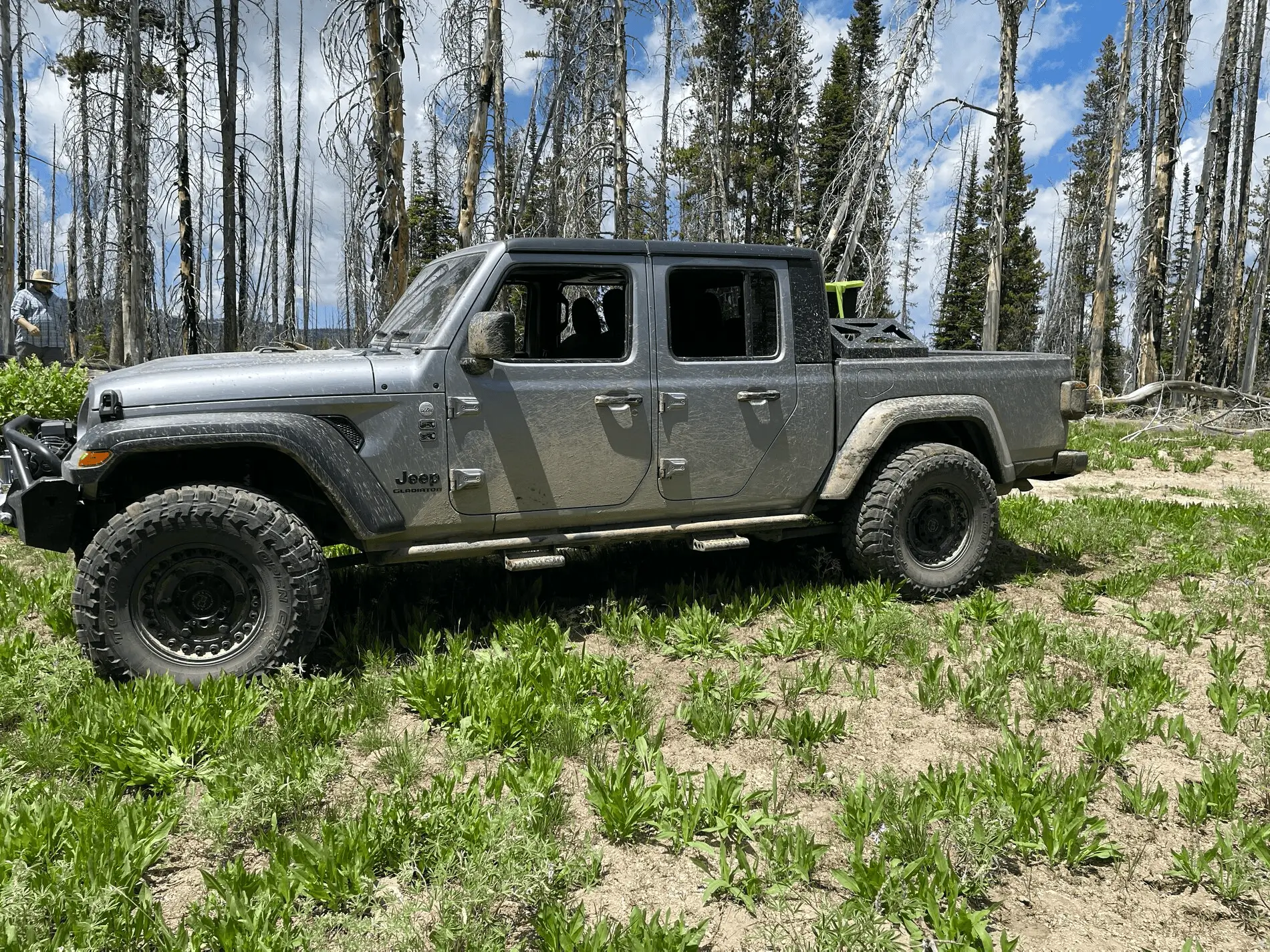

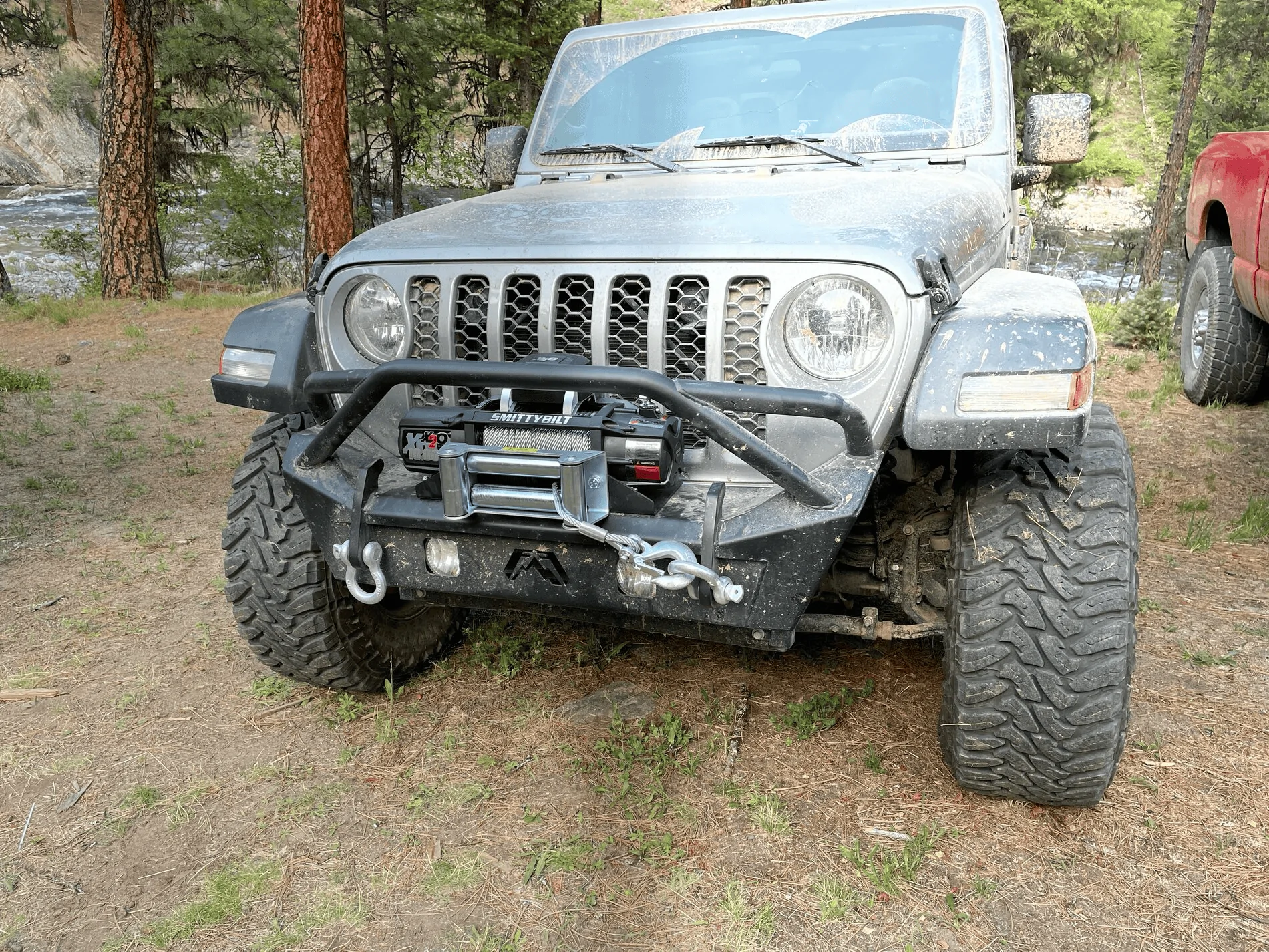

This is just a Rubicon take off suspension and a Teraflex leveling kit
I have Teraflex sway bar disconnects among some other stuff
I'm getting a 3.5 Rubicon Express lift in the next month or so
Black Rhino wheels with -24 offset and 35x12.5R17 Toyo MTs- I don't know if you'll want to stick out this far

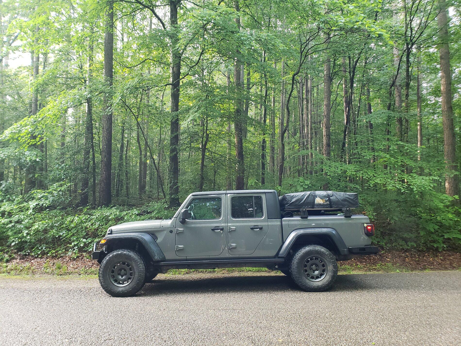

Great build! I'm considering the same wheel/tire setup. Like you, I'm really digging the clean, within the fender look of the AEV wheels. My question is, the Salta XRs you have are they in matte black or onyx? I don't typically love the blacked out wheel look so I'm leaning more toward onyx but I wonder if it works with Sting Gray. In some photos the Onyx color almost appears to have an ever so slight green undertone. Pictures can be deceiving though.
