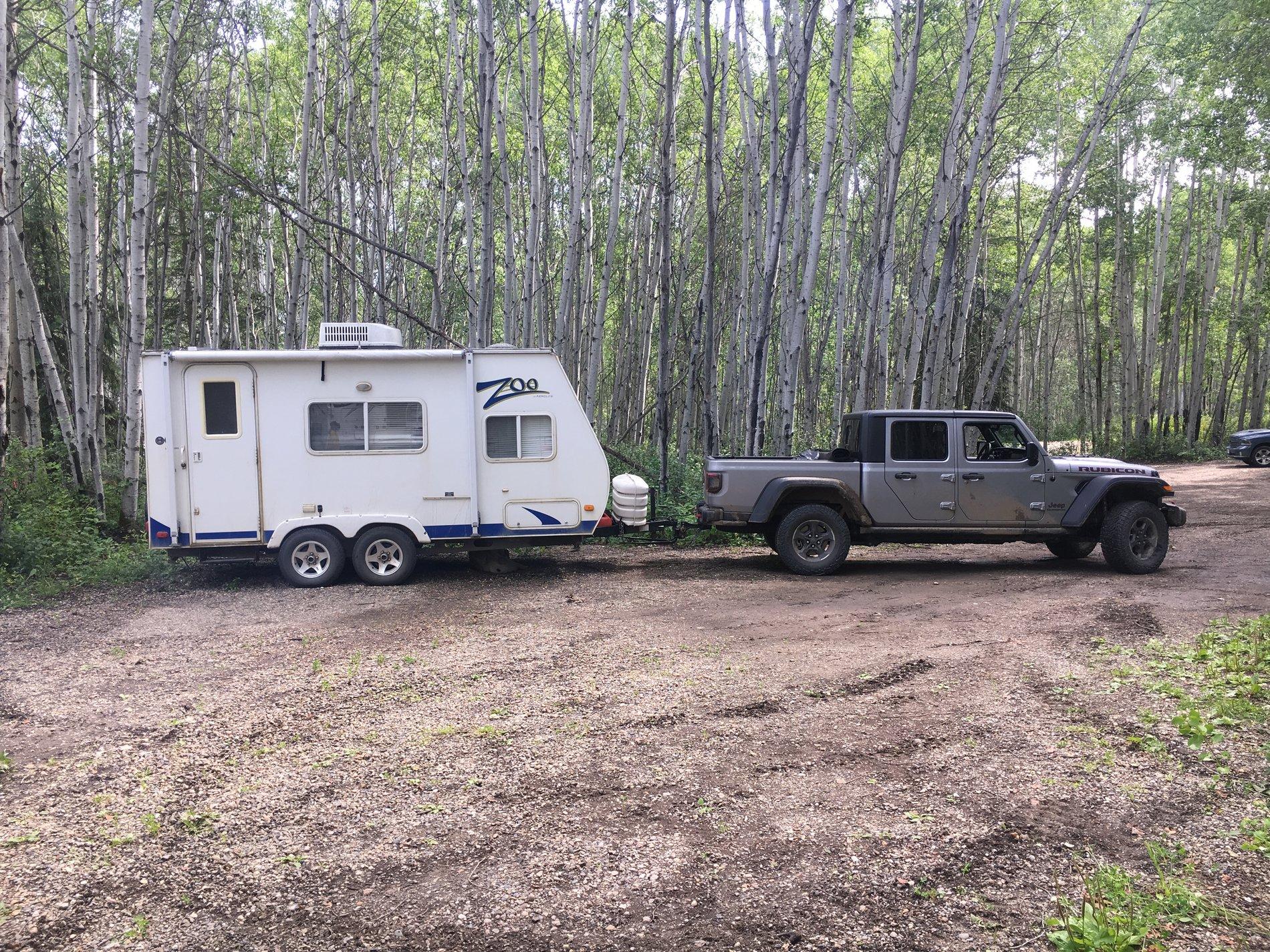

Alaska-HWY JK
Jun 26, 2019
151
131
BC
2005 Rubicon LJ 2007 JKU 2020 Rubicon Gladiator
Just over 4200 lbs. 20 gal water, 2 x20 lbs C3, fridge full, gear and beer. I’m wanting a bit bigger but sceptical about getting in the 5000 lbs range. We only drag it about 70 miles. I’d like to try a bit further this summer if I get weather and time. Pulls better than my JK on 37’s with 5.13s but not great. Can’t imagine 35’s or 37’s without a regear. This trailer is 2900 lbs dry.
