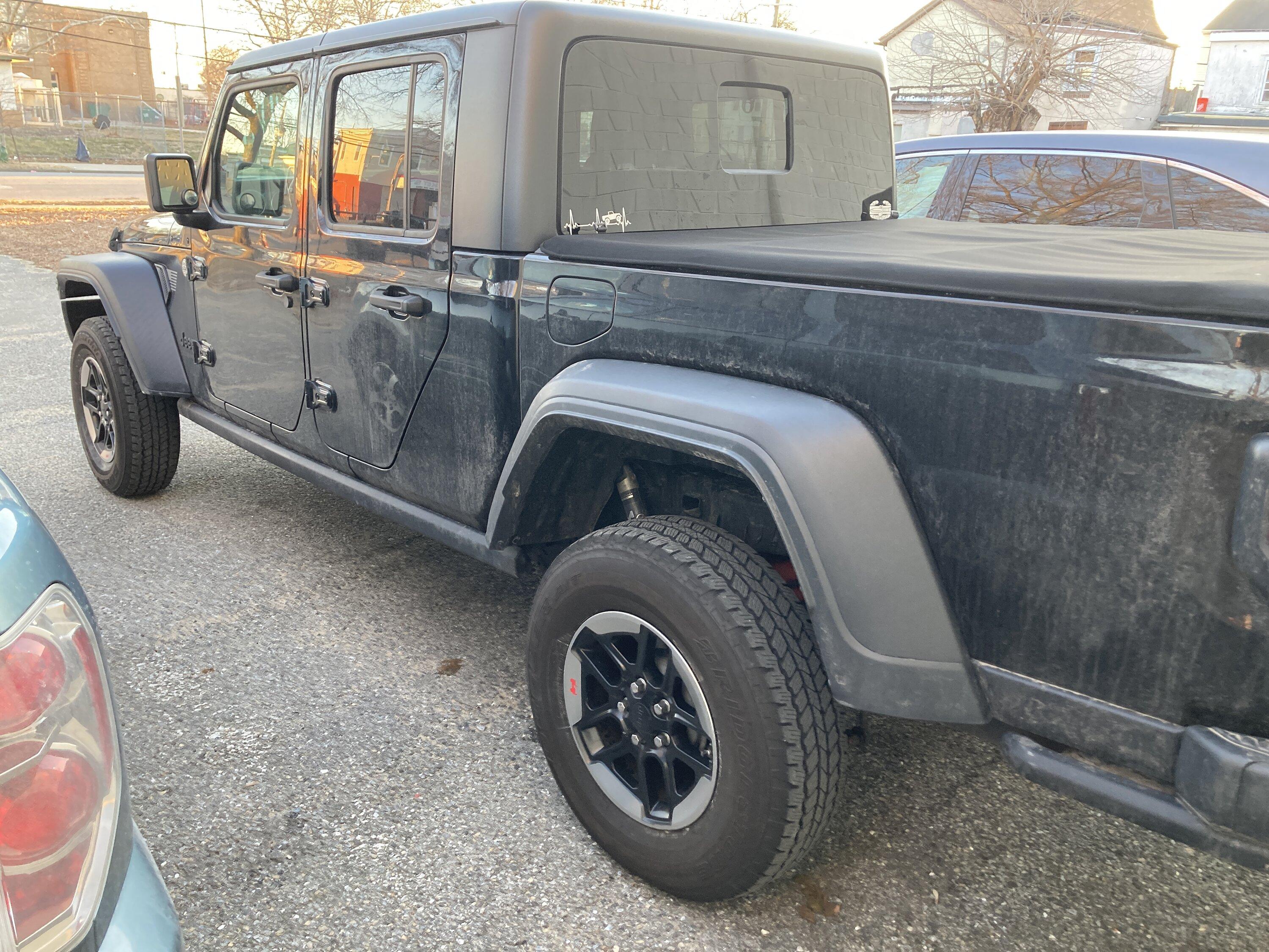

Look for a set of Mojave or Rubicon take off wheels and tires, they fit perfect on a max tow. Here's mine after I put Mojave takeoffs on it.

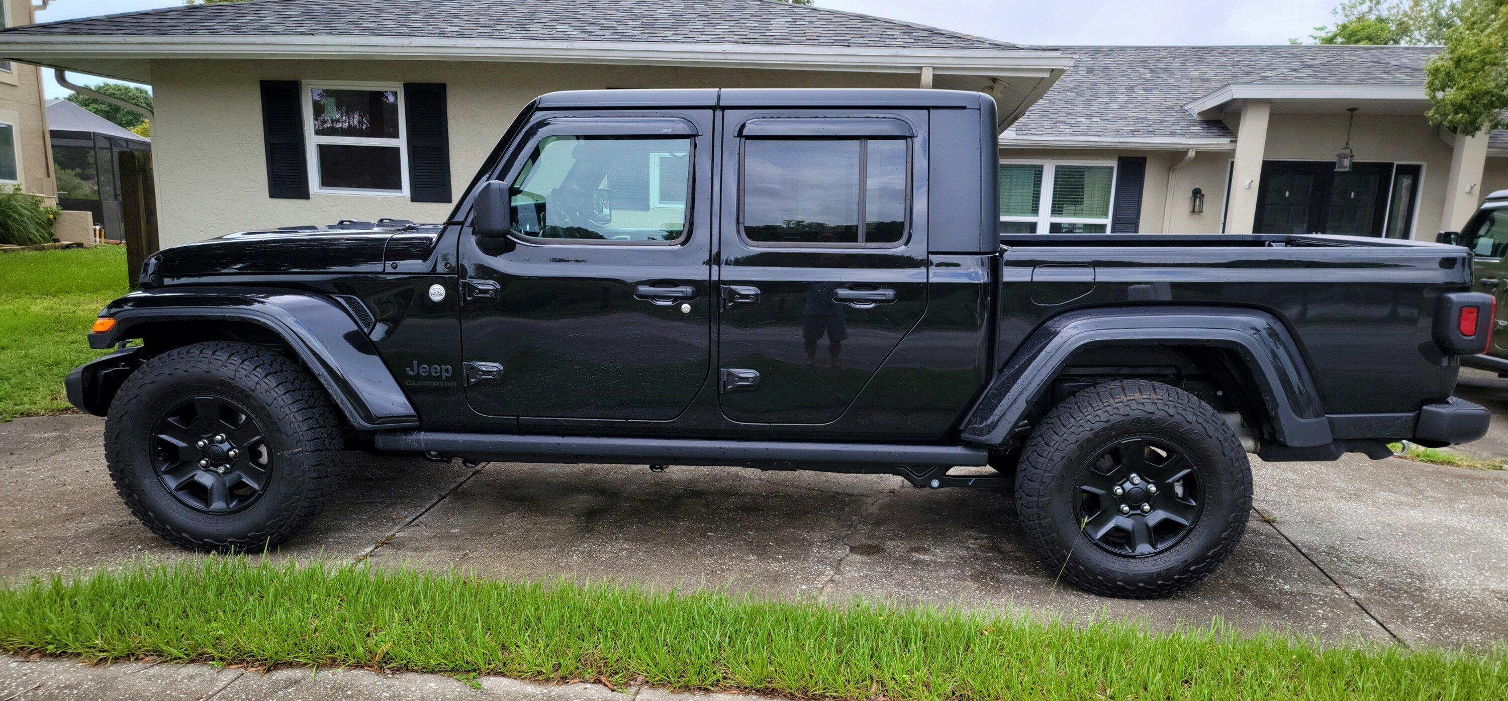

I'd just put 285/70R17s on it (factory Rubicon size) and call it a day. If you are concerned that's too big, throw some 255/75R17's on it. That's the factory Willys size, and it slightly larger than the Sport S tires. Buy something all terrain so its a little more aggressive.
As for GVWR concerns - unless you plan on pulling at 7,650 pounds every day, I'd go with the Rubi size tires. If you are concerned with those, throw the Willy's size on. If still concerned....buy an aggressive looking AT in the stock size.
I have a Max Tow on order and already have a set of factory Rubicon tires and wheels sitting at the house for it that I plan to run. Based on driving a Mojave (same gearing and tire size) I think I'll be very happy with it.

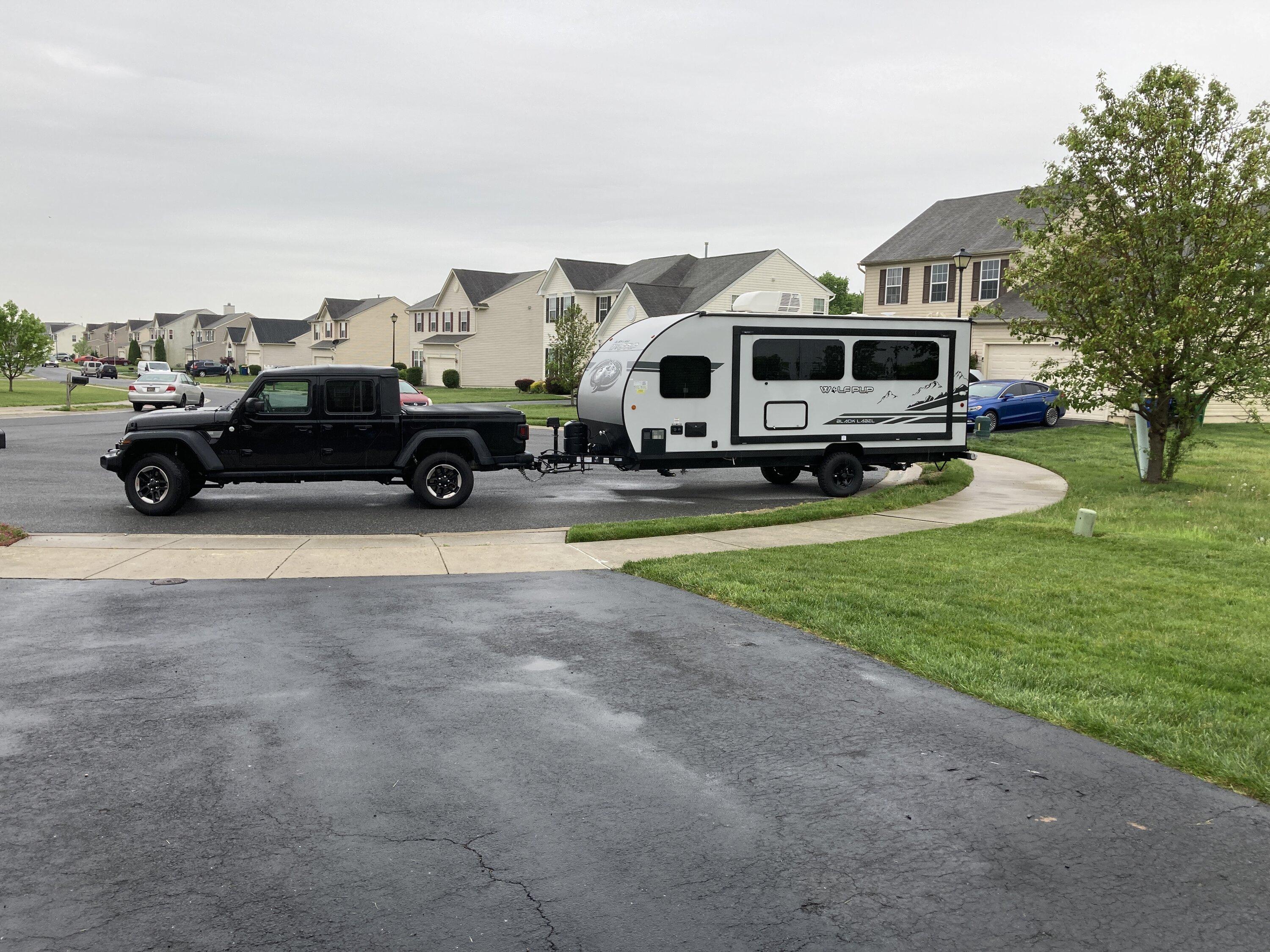

I pull my camper often and use 255/75/17 dueler AT tires on JL rubi wheels.
Great mpg and handling, and i didnt loose any power with the slightly larger tires. Fantastic tire in the sand, snow, and rain.
Tires are a million dollar question with a million answers. You need to find your own balance between form and function.

Thanks! I see you have the wolf pup. We are looking at the Geo Pro mr Ember and will be towing it a lot. Once retire we will tow it a hell of a lot :) Ensuring all the numbers balance with a travel trailer is like playing with Math on Mars to ensure you have oxygen!
What are all your numbers on the Pup including length etc (or just send floorplan number..18TO maybe?), what tongue weight are you running when all full up? My guess is we are looking at similar numbers to what you have is why I ask. Somewhere near 5K trailer GVWR around 22 feet?

Around 5,000lbds fully loaded, im usually closer to maybe 4,500ish. So a ball park hitch weight of 500lbs. 24ft if i have the rear storage rack down.
The jt pulls it easily! I had 285/85/17 tires before and though it pulled fine. I felt the power loss with that size. When i swapped down to the 255/75/17 it was a night and day difference in power for pulling and driving. I see 7th a LOT and 8th pretty often when using cruise control.
I fell into the “i MUST have 10ply tires to tow” trap at first. The jt is rated for its maximum towing with 112T tires…i have 115T on there now and they are more than enough.
