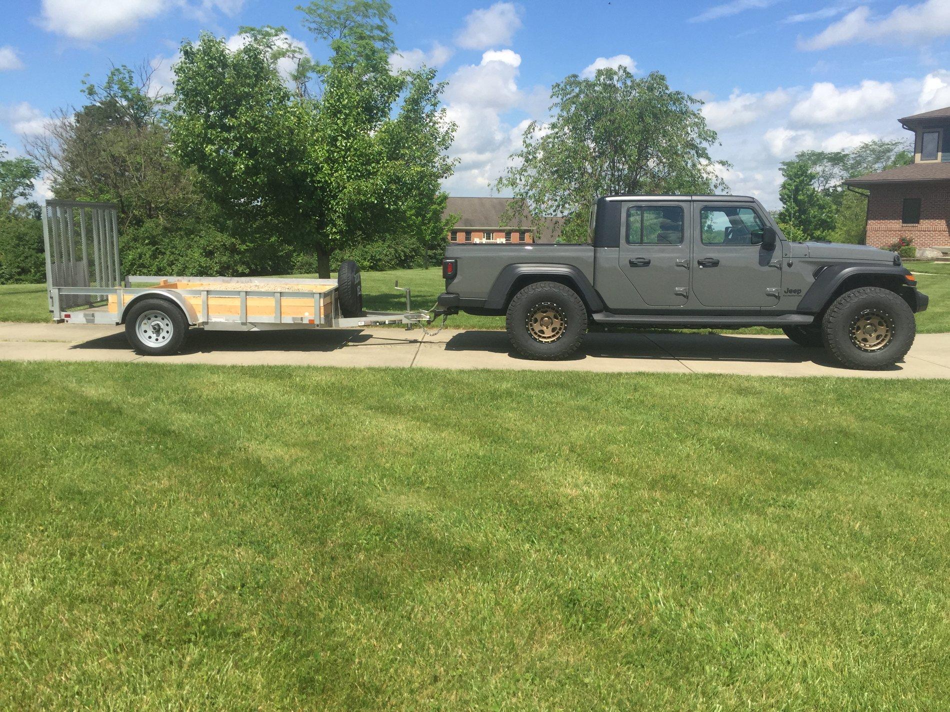

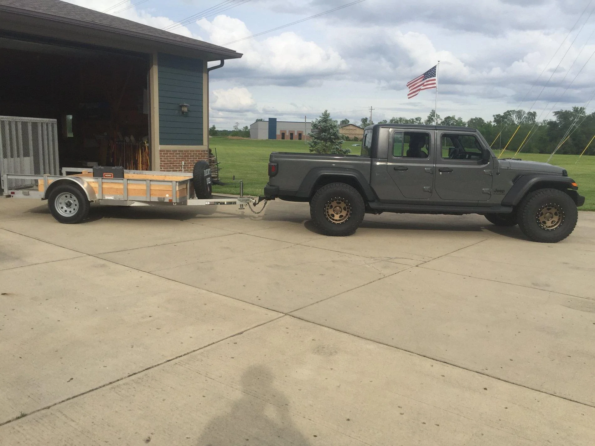

Just to throw my 2c in. I'm running 37's with the Max Tow and can feel a difference in the JT's acceleration from a standstill vs the stock wheels and tires when hauling. Last couple of days, I've been hauling landscape material topping out at 2k due to trailer limitations. Out of curiosity sake, I also hauled a load with my stock wheels and tires and I can definitely feel the difference between the two setups. My plan ultimately is just to swap out the wheels and tires when I pull our yet to be purchased RV. Pics show trailer loaded w 2k vs unloaded.
That being said, with no loaded trailer, the JT accelerates far better than I expected with the new 37's. I've had a couple of JK's that I ran 35's on and they were complete dogs.

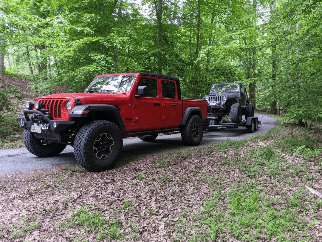

My wife towed my TJ Rubi (Total weight of TJ and Trailer roughly 5200lbs) to Windrock TN. from Stafford VA and back at the beginning of the month with the Sport S, 3.73s on 37's while I followed in the Silverado towing her JKU. She slowed down to 55 anytime the Tranny reached 230 Degrees per my instruction, But that was only twice on the whole 15 hour roundtrip run, The rest of the run was 70~75mph with no problems.
It does have a RedArc Brake Controller and a Weight distributing hitch, She said it wasn't uncomfortable or unstable at all.
