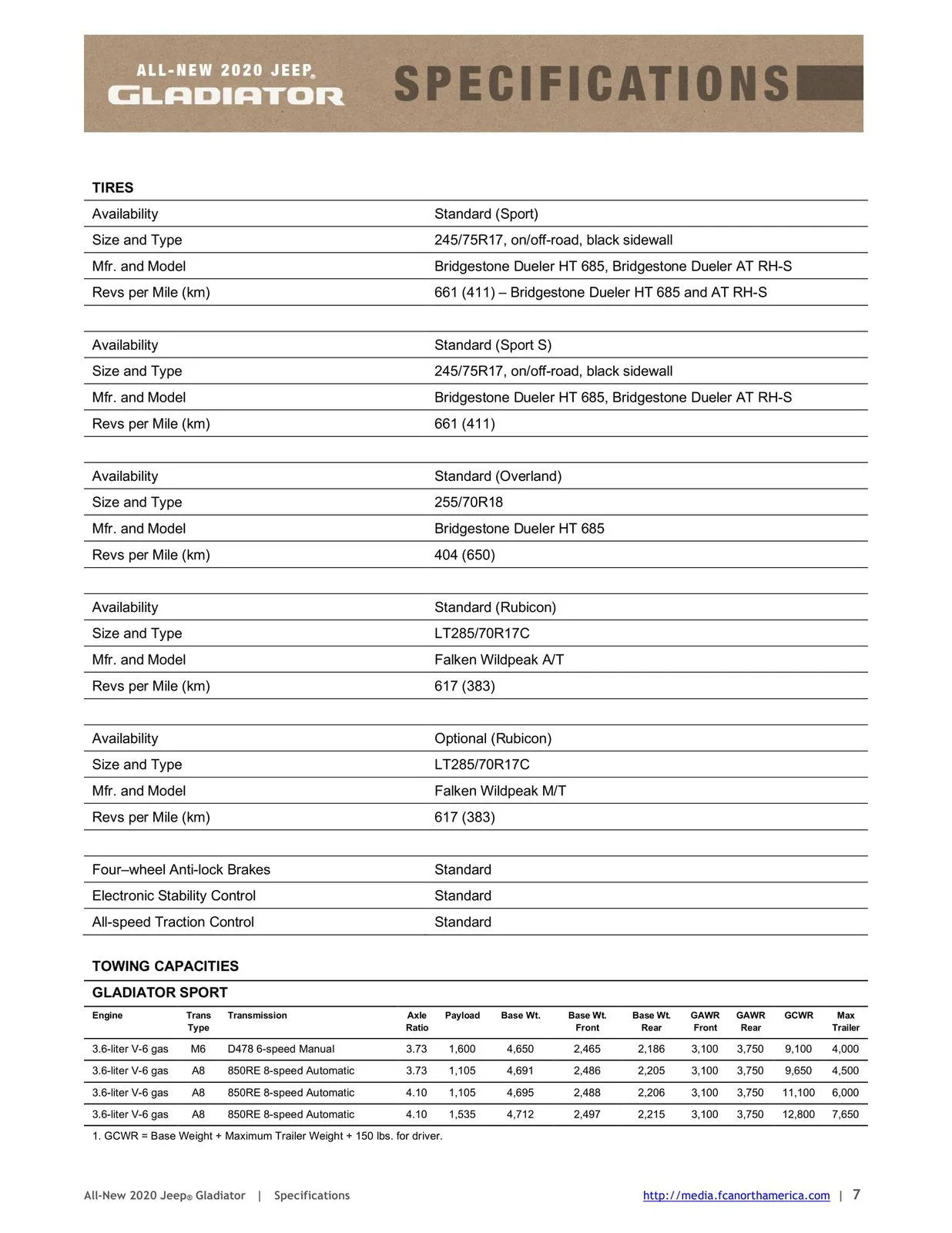

I apologize if this question has been asked and answered, but any educated guesses as to why the Sport has two different towing/payload set of specs with both automatic and 4.10 axle ratios? Im interested in the max towing/payload version, and I don’t want to make a mistake when I build my order.

Perhaps it's a Standard tow package vs Max tow package? The resulting difference might occur in a sport regular width truck vs a sport wide track. Although the 4:10 implies wide track, so not sure.

The truck comes standard with a class II bumper hitch which I think is just a hole in the bumper to insert a hitch ball into. Or you can order the tow package which comes with an under the bumper receiver hitch and will get you the max towing capacity.
