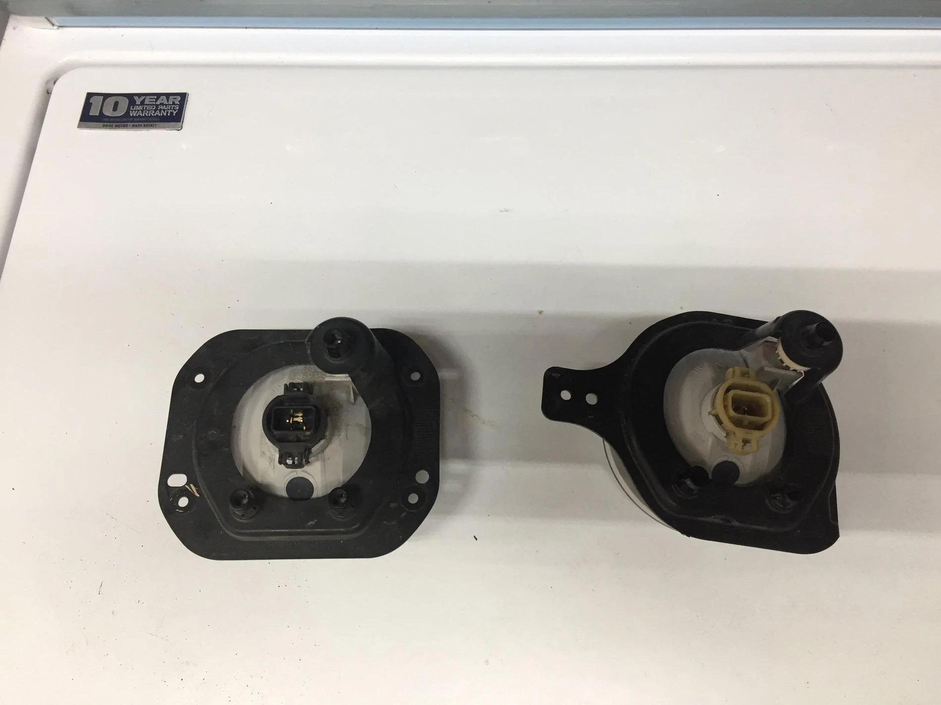

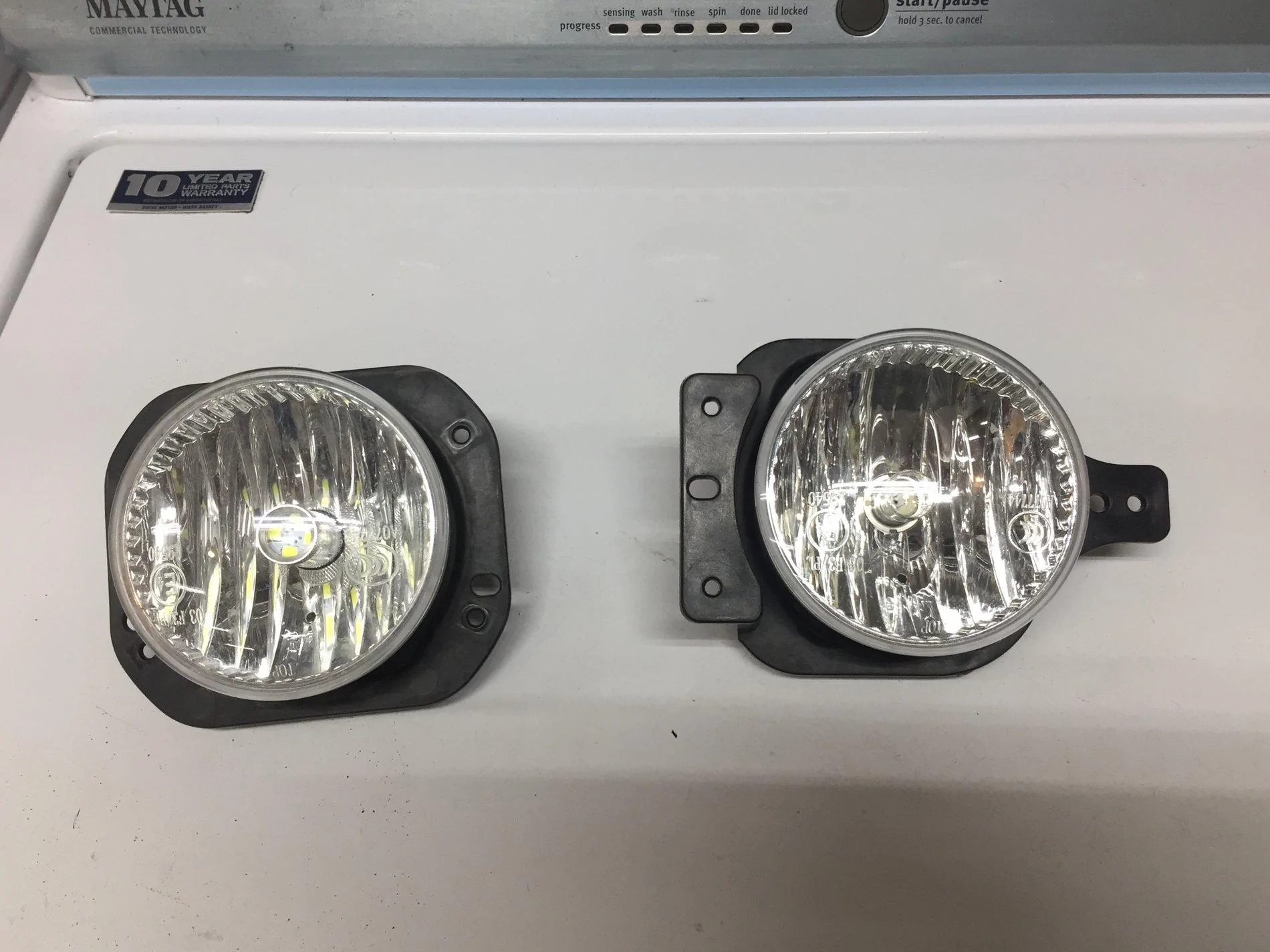

Sorry to revive the old thread,
I was searching a bit and didn't find a clear answer but yes, the sport = 3 mounting holes and the Rubicon front bumper's fog lights are held on by 4.
Is the difference simply just bracket or are the fog lights themselves different?
The light appears to be the same but the mounting bracket is different. I don’t think the bracket is available separately.
That is a Rubicon on the left and Sport on the right.
Other side.
Best bet is to watch the Member Market Place here and on the JL forum for OEM LED’s, they come up regularly and are a reasonably priced plug and play option.
