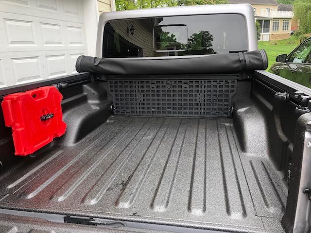

@cbl1 I see you have a roll up tonneau cover too. I want one as well and assume I should get the bed lined first. Does the cover use the threaded holes I see in the back wall of the bed? If so, how did you protect those holes from being filled with the Line-X when getting the bed sprayed?

Yes it is the two threaded holes on each side about 2 inches down. They plugged the holes so as not to fill. I had taken the top off at home so it was not on when took to Line-x. So I mentioned the holes to them and they said no problem. I would show them but I got the feeling they check for those things.

A point of advice. If you have the trail rails and have any intention of removing them later to put in a molle rack or anything mounting behind the trial rail - tell them not to put the adhesive behind the rails. ThAt adhesive they use was really strong and when I installed my Molle panel behind front rail it was extremely hard to pry the rail from the bed liner. I was very afraid I was going to bend the rail.
