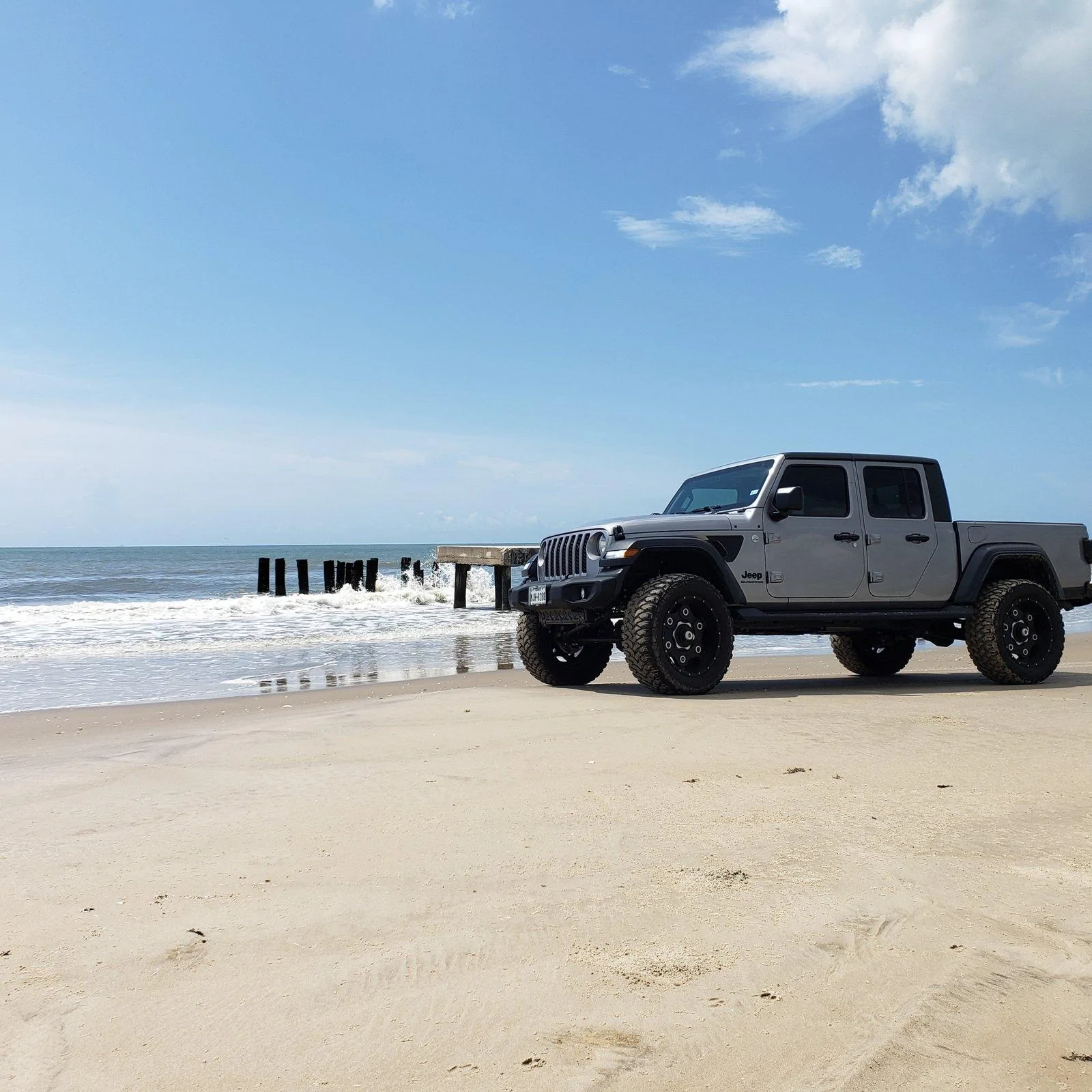

Disclaimer: I know it's a cheap lift.
I installed the Skyjacker 3.5" long arm coil spring lift with monotube shocks at ~700 miles on my Sport S Max Tow. I daily drive it and only do light offloading/beach crawling occasionally. I have been completely happy with this setup with one exception...the shocks squeak and it annoys the hell out of me. I have put roughly 5,000 miles on it with the lift and they started squeaking at ~4000. I have sprayed some WD40 on the shaft at the base of the shock and that stops it for a short time but I have had to continue doing this every couple of days. Is there a permanent fix for this? What shocks fit the Gladiator? I've searched a little and can't find many shocks that say they fit the Gladiator.
