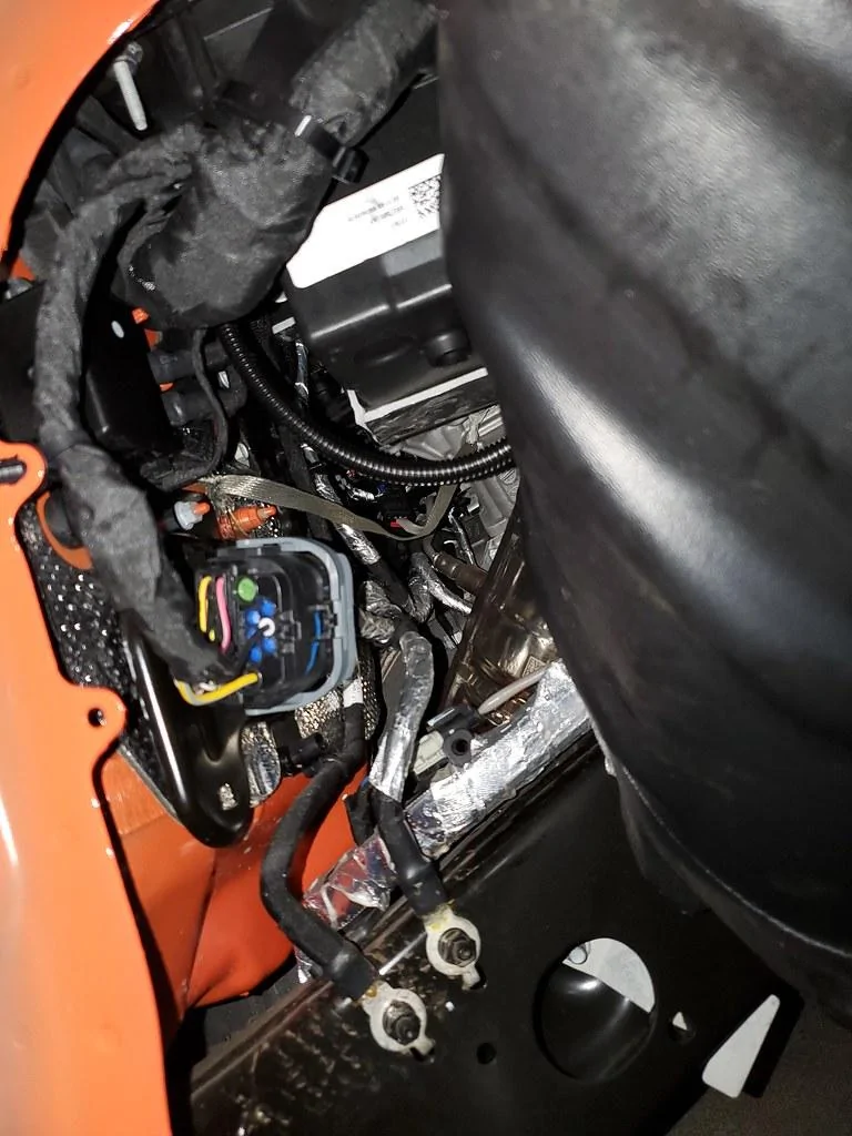

Pull back the front passenger wheel well liner to install the power wire. You will need to cut the large rubber grommet in the footwell. Feed a wire grabber tool through the hole and attach the wire. Pull it through.

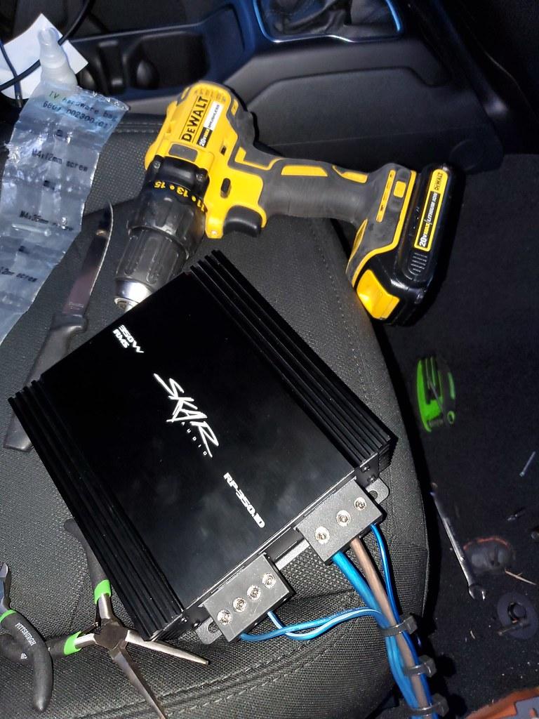

Install all the connections to the amp. Do this first or you wont be able to reach the wires behind the amp once its installed under the dash.

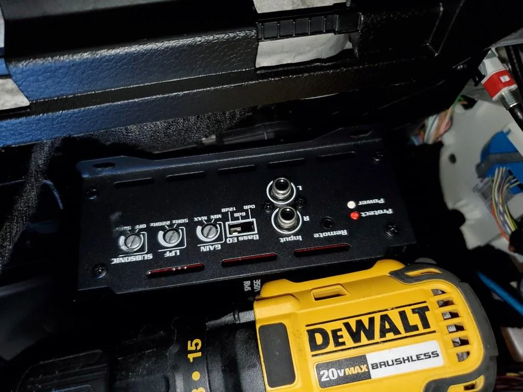

I used my dewalt to hold the amp in place while I lined up the screws. I used plastic spacers I had laying around to space the amp off the motor. Also you will need a longer screw here. I used some hardware I had laying around. Just a longer plastic self taping screw.

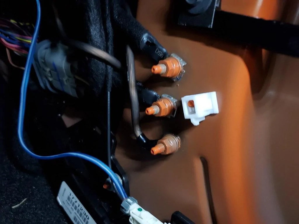

Jeep gave us lots of grounds to the chassis. Use the third one down to install the ground wire.

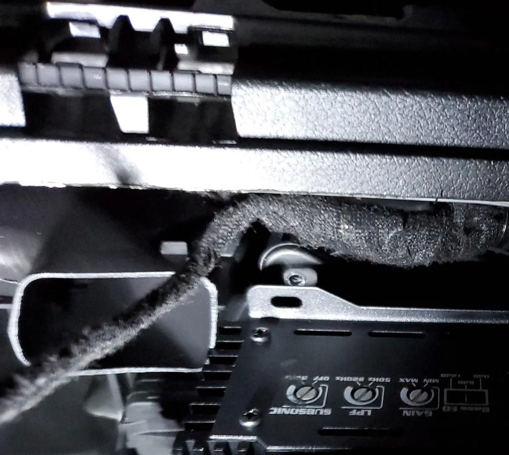

In the back of the amp. Reinstall the screw that held the light in using this for the rear amp screw.
You will need to remove the screw holding the fan motor in on the front and align the amp with the hole there. This will only work with the SKAR RP-350.1D Watt amp. The holes lined up perfectly.

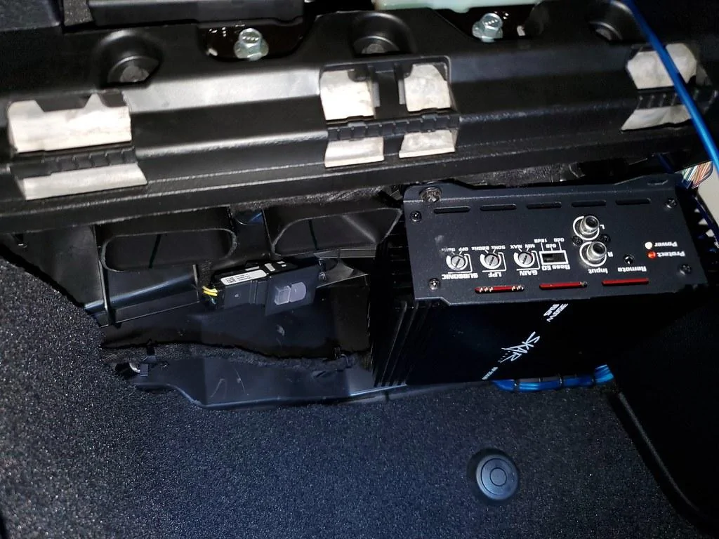

Run the wire to the back to power a 3 or 400 watt subwoofer.

Remount the light to the screw hold that was holding the wiring. Reinstall panels.

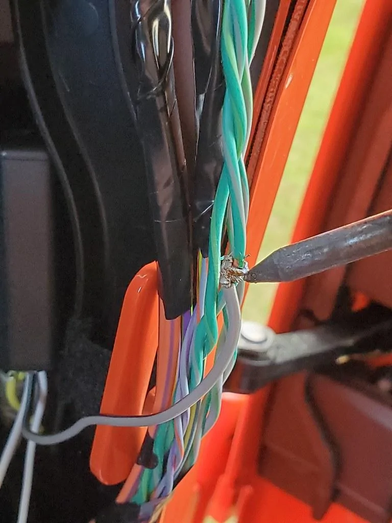

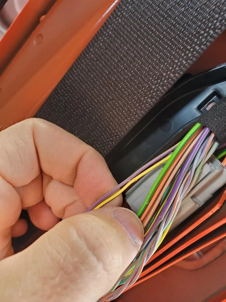

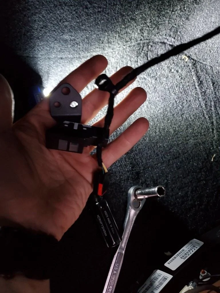

I tested all the wires with my multi meter. There is NOT a remote switch back here but there is power (12v) constant. The other wires were 3 volts which means they are CAN BUS, dont mess with 3 volt wires, they run to the vehicle Network system.
Jeep Gladiator Stealth Amp Sub Install (under dash) 49690095422_f0b0356c1e_b

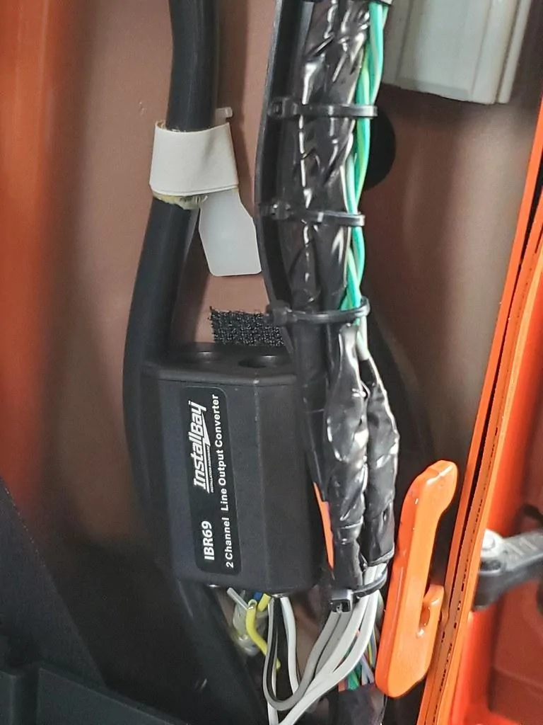

I soldered the wires to the LOC (line out converter). I just removed about an 1/8 inch of insulation and soldered the LOC onto the two twisted pair.
Jeep Gladiator Stealth Amp Sub Install (under dash) 49689786256_9864211571_b

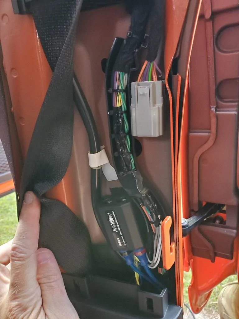

I secured the Line out converter with velcro I had on hand, Slid it into place before I put the wires in the tray.
Jeep Gladiator Stealth Amp Sub Install (under dash) 49689255438_4562c7de3a_b

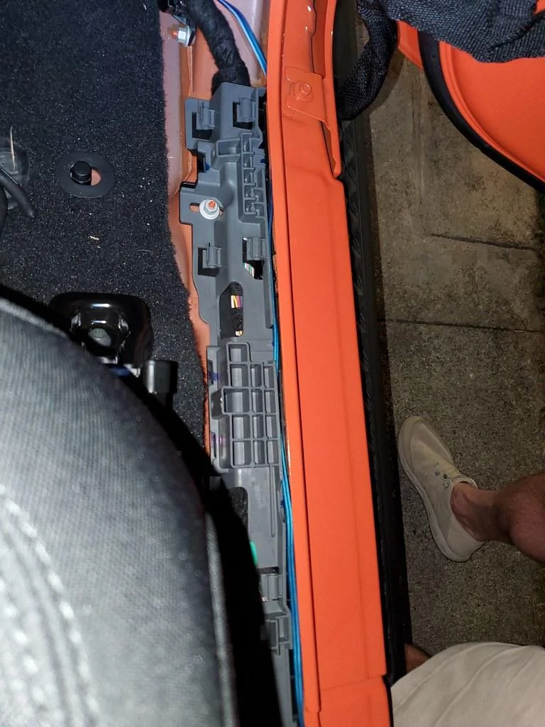

Wiring Harness put back in place. Its important to make sure everything in here is tight and out of the way of the seat belt moving around.
Jeep Gladiator Stealth Amp Sub Install (under dash) 49689254458_754cc3b6fb_b

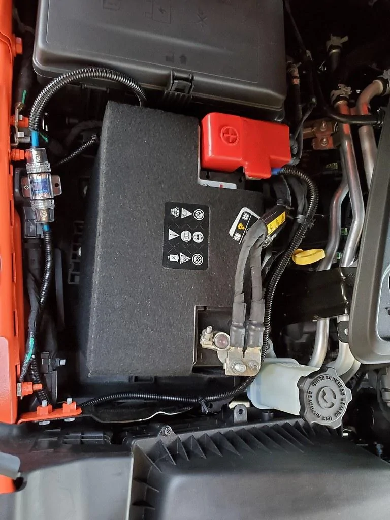

I finished wiring and split looming everything under the hood and in the chassis. There are plenty of options for powering the stereo int these trucks.

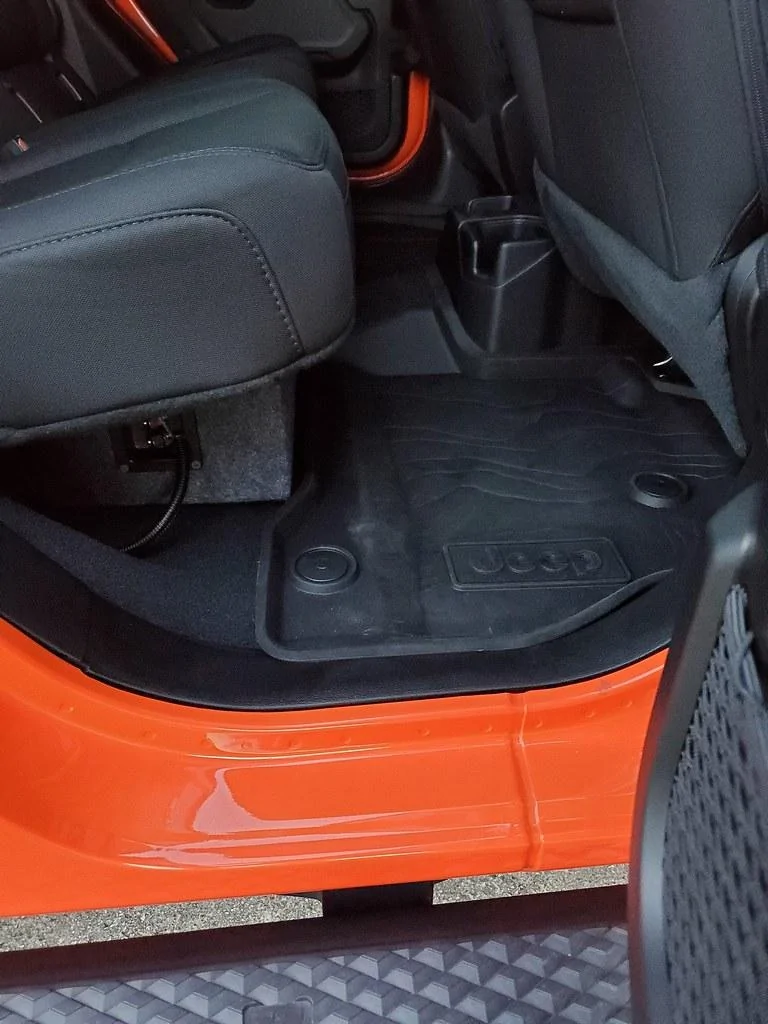

So we are pretty limited in space. I tossed out my gun box from the cargo management group and put this in its place. It bolts to the floor and is solid. I am going to paint the carpet black in the near future. The two subs I chose are 6.5" Skar EVL-65 units. They handle 400 watts each. These sound like a pair of 10's. I had a hard time going with small subs but these things beat hard enough to have people notice.

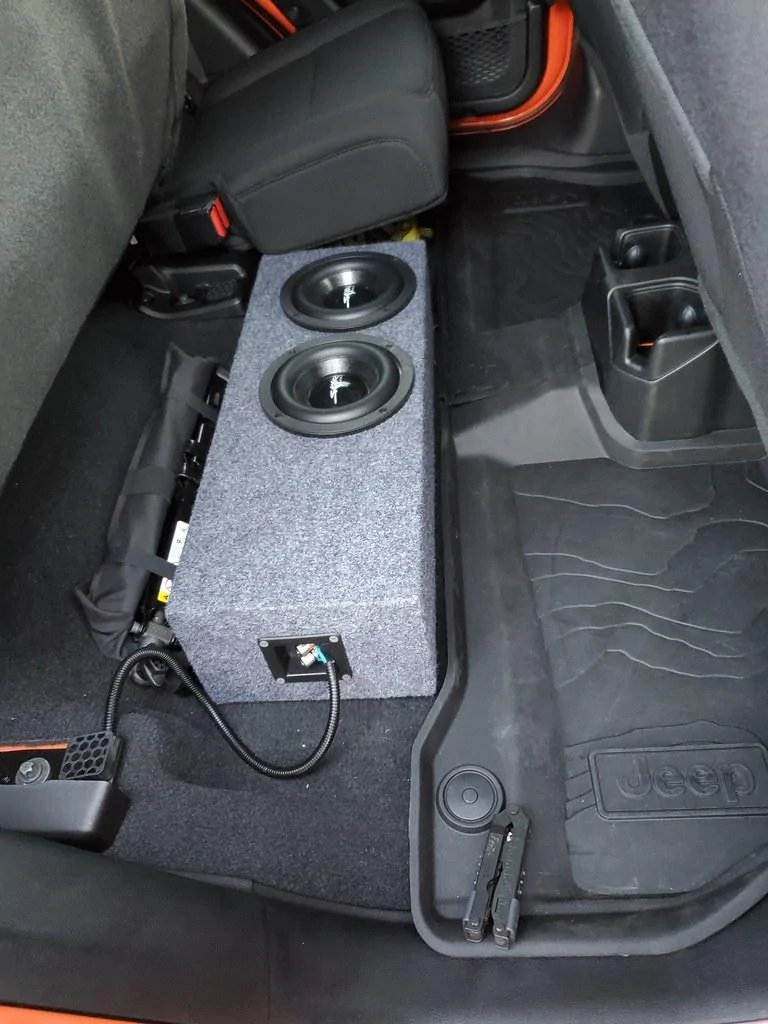

Finished! Here is the 2 ported subs under my rear seat. They are so loud that the neighbors came over and could not believe they were 2 6.5" Subwoofers. All my future builds are going to have to be thought out more extensively. These things are deep and loud.

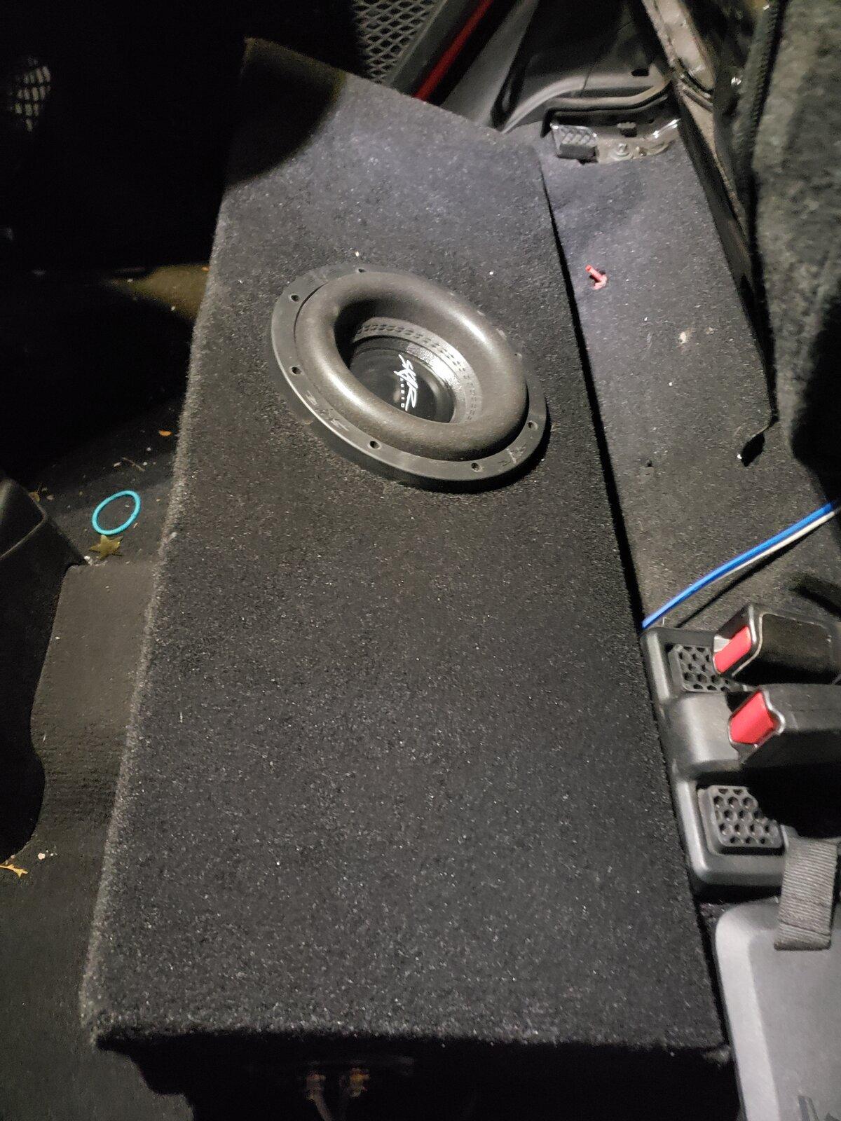

Just finished mine. Skar evl 8inch with skar 1200 amp. This thing hits. I wish I had designed it to fire forward but the sub was too big for the angle I put in the enclosure. I used the cigarette lighter for the remote and a kicker line out converter tapped into the speaker wire in the passnegerside b pillar. All in all pretty decent.
