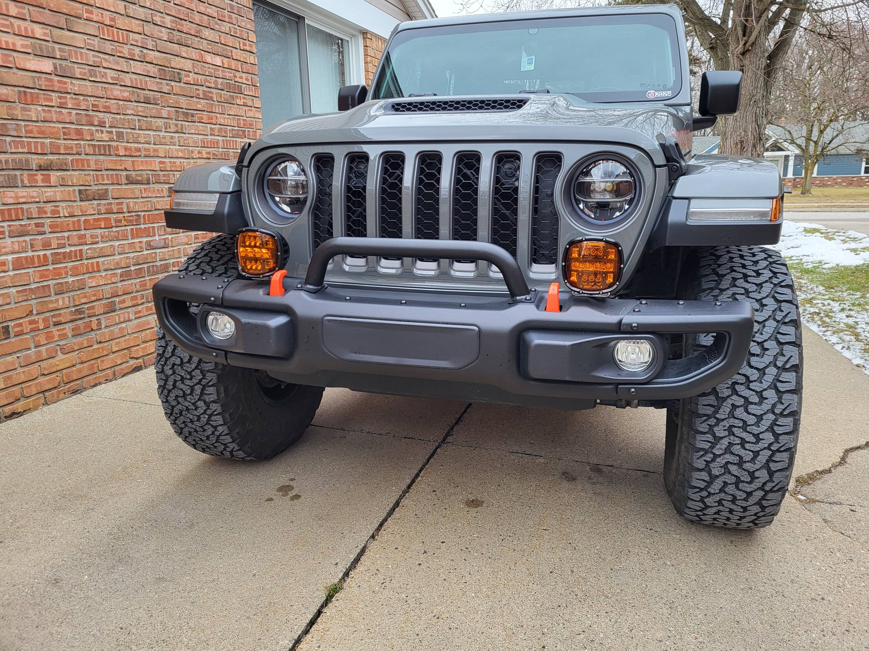

I installed a factory takeoff steel bumper and black rubicon skid pate with no problems or modifications. Used new fog light brackets from maximus. Utilized stock mounting holes from my stock mojave skid plates. (There is 2 empty holes for additional bolts for additional brackets, but i opted out of those because this skid plate is sturdy and doesn't look like its going anywhere.) Obviously for non mojaves you would need to purchase brackets, bolts and hex nuts to bolt up to the underside.
Jeep Gladiator Steel bumper for Gladiator Mojave? 1000002597

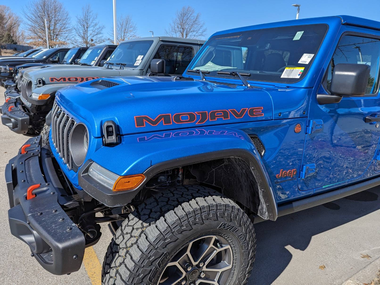

I saw no difference between the steel bumper I have on my Overland and the steel bumper from the factory on a 2024 Mojave X
Skid plate, perhaps, but bumper looked the same at a glance.
Jeep Gladiator Steel bumper for Gladiator Mojave? PXL_20240229_174318505
