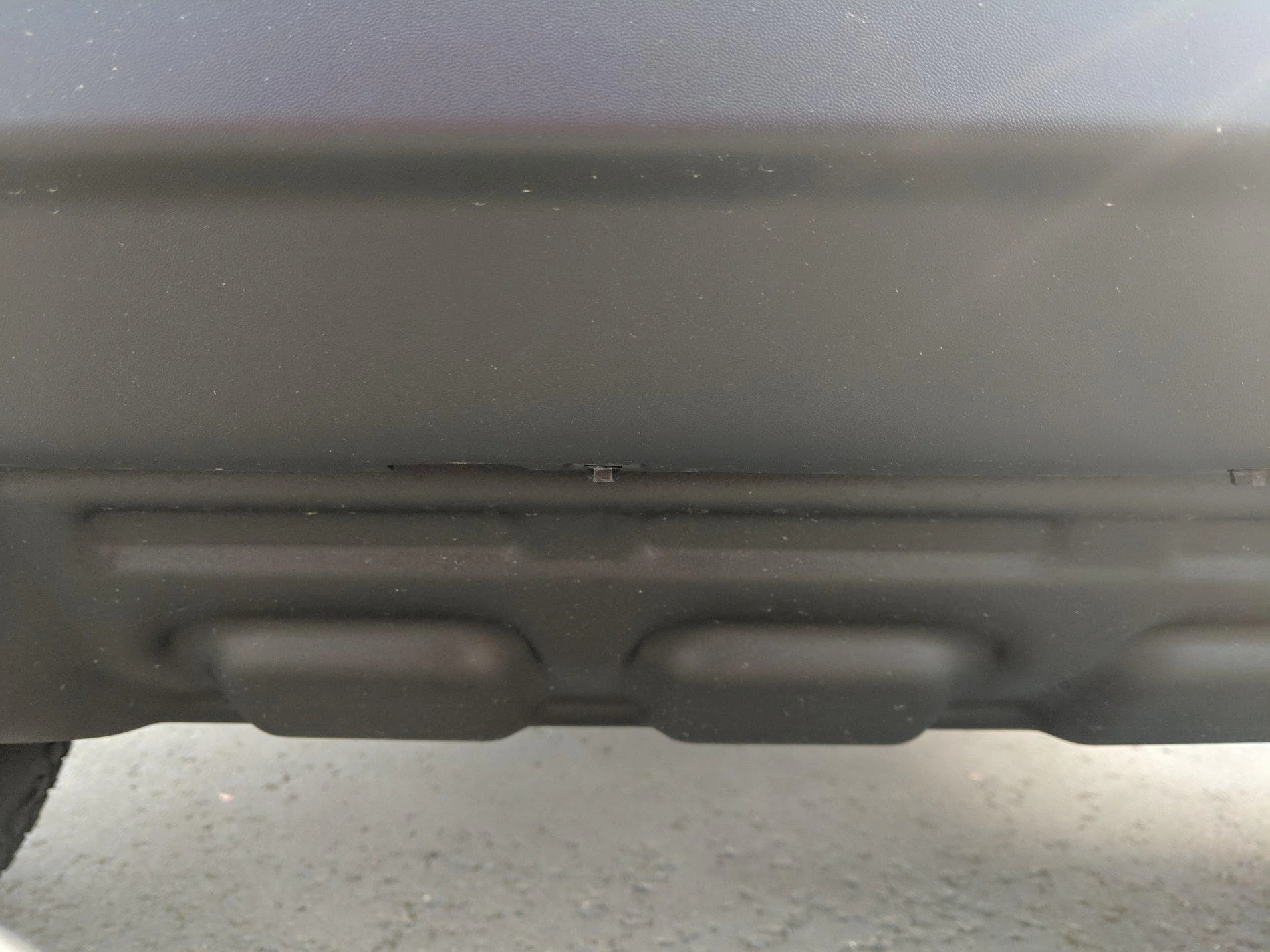

The JT Rubicon with the plastic bumper already has a steel skip plate up front. The only thing you need is the 3 piece or stubby MOPAR front bumper.
This is sort of bad information. The JT Rubicon DOES come with a steel skid plate.
However it DOES NOT come with the CORRECT steel skid plate (82215183) to use with the 3 piece steel winch capable bumper assembly (82215121AB)
Nonetheless, $776 shipped is a screaming good deal for that bumper, and thanks I ordered one.
Now to find a deal on the correct skid plate, gotta be one cheaper than $200

The existing steel skid plate that comes with the plastic piece of shit, does not have a facility by design to bolt to the steel three piece which is required to provide the strength needed to serve as a winch platform.
But yes please share anything you know or discover.
