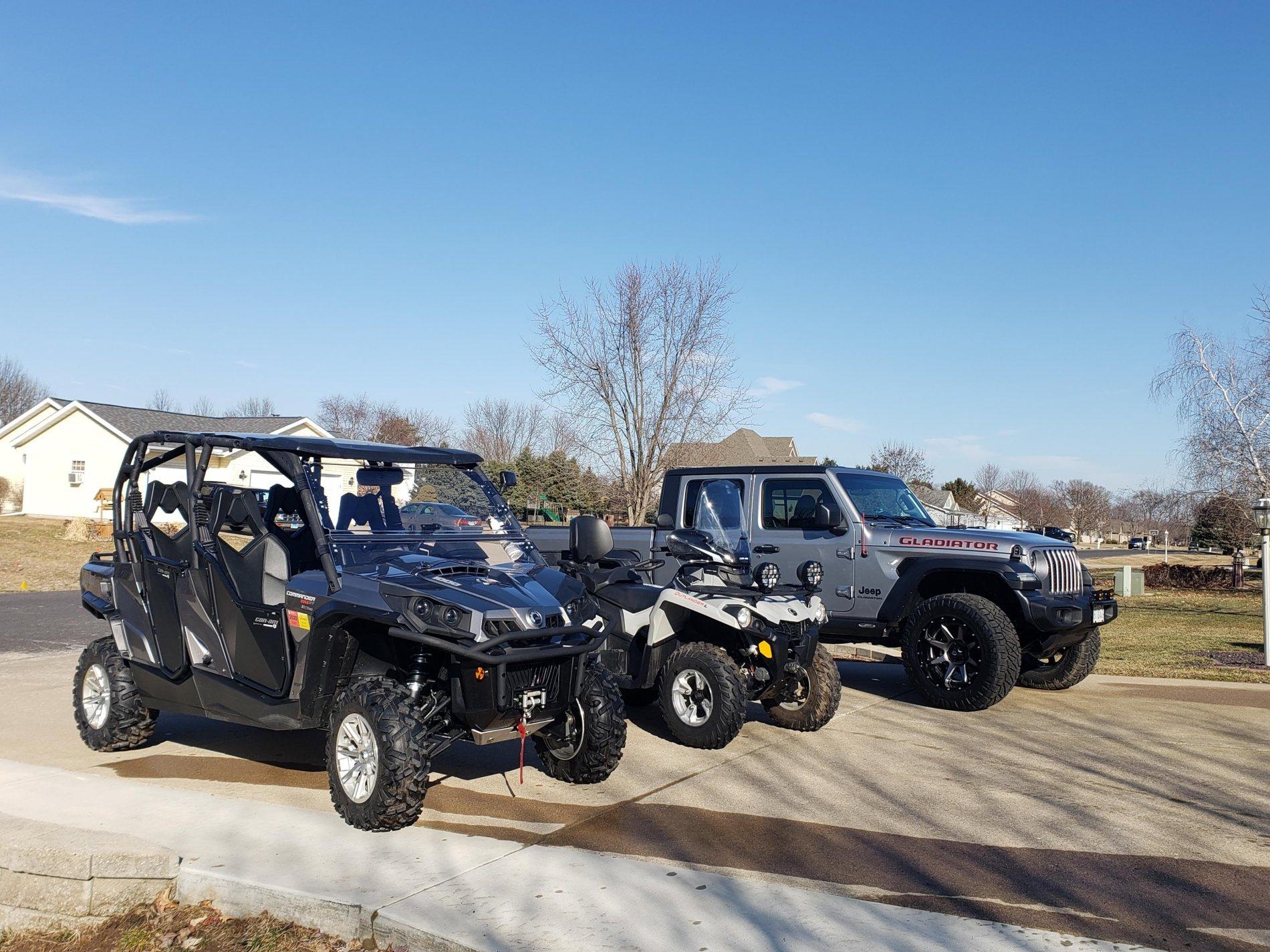

I put synthetic on my side by side and quad and have never regretted it one bit. They get used about once every outing for the last three years. In general I feel way more comfortable having the wife and kids help rig and place the cable, as I am not worried about them getting impaled. Also, even though it is not recommended. I have used my winch rope as a tow rope twice when in a pickle. I run a plow on the quad in the winter and the synthetic rope has never missed a beat. Seemed to good to be true at first but after three years of regular use, it does the job!
Jeep Gladiator Steel or Synthetic 20200223_150811
