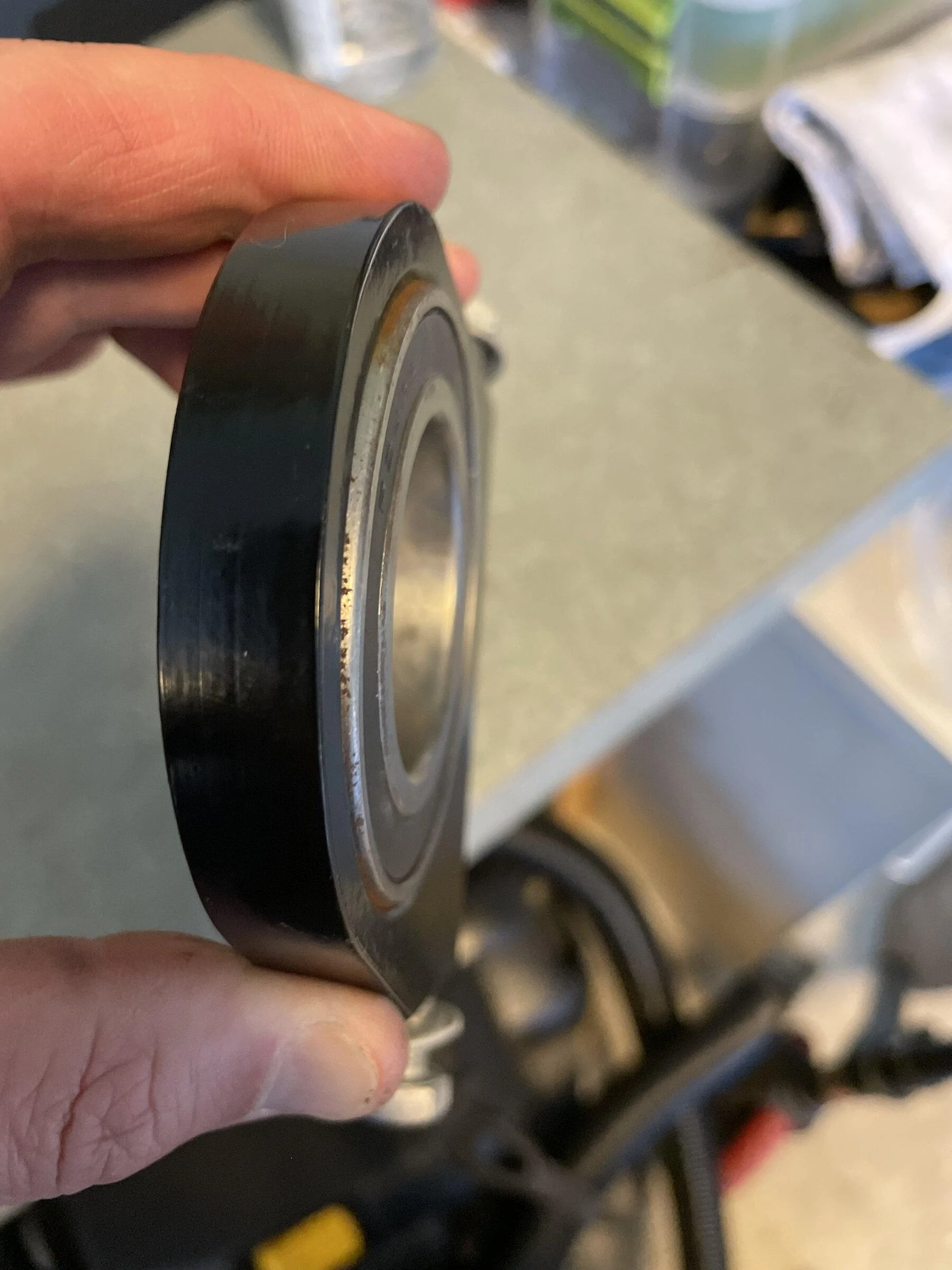

Not to bring up an old thread, but this just happened to me. Bearing seized up and I thought it was the ball joints. If you look at photo, the bearing is crooked now after removing the sector shaft brace part. It’s been a year, so not sure about warranty. I live in Maryland where we get salt, wonder if it had something to do with the bearing seizing up.
Jeep Gladiator Steer smarts sector shaft brace gone bad D5D3331E-051E-4B55-A68F-96CDE2005762
If you read the instructions, the bearing is pressed in that way on purpose. They specifically say not to try and correct the angle.
