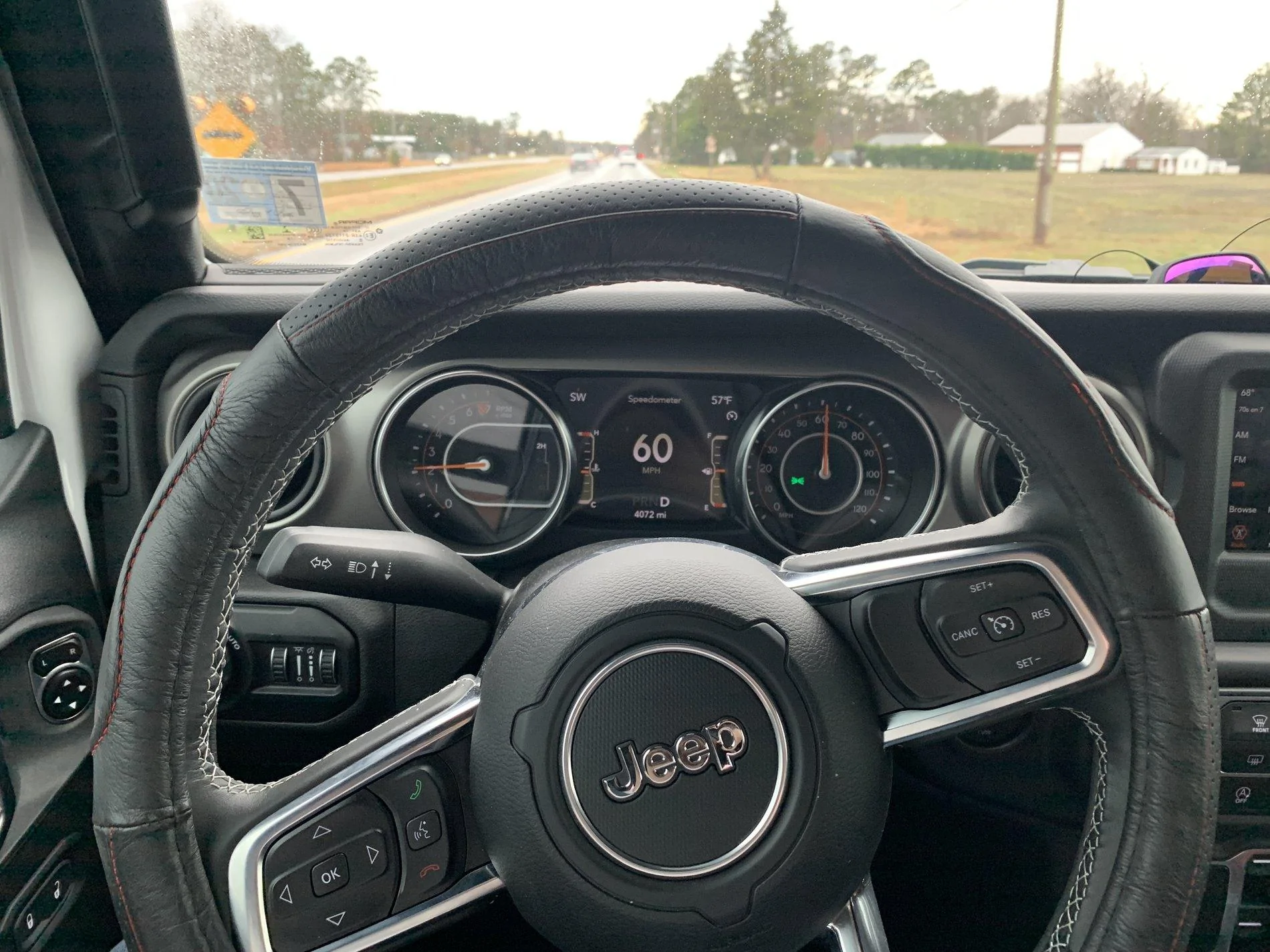

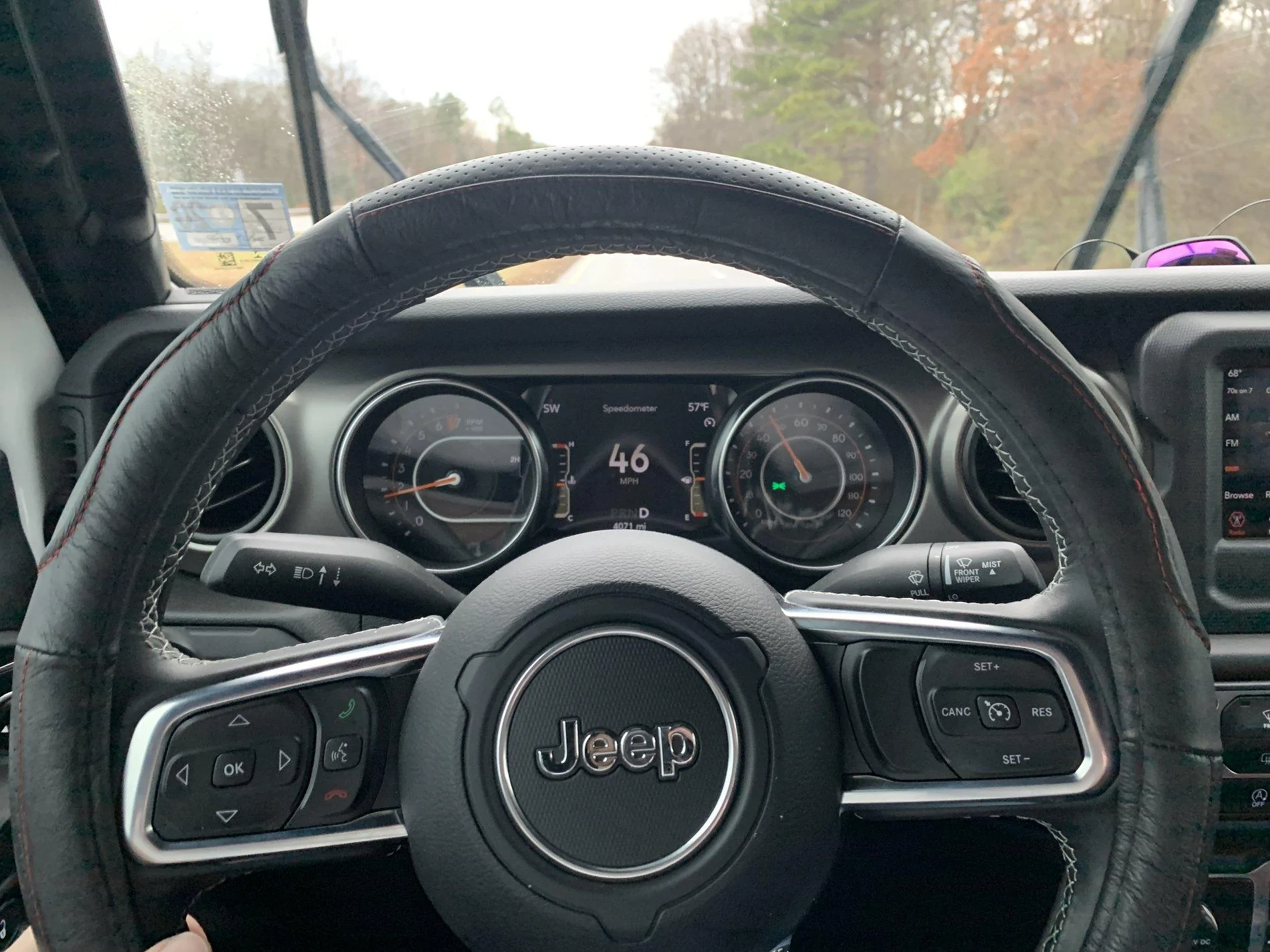

This morning I drove with the ATS, set it at 16 clicks (as recommend from another forum member) and honestly couldn’t tell any difference, except my steering pulled to the right, and I had over steer to the left (attached pictures, first is right lane, second is left lane). I then set it to “0” clicks, drove about 10 miles, and it felt very similar. I then set it to max clicks (tightest mode) and could barely tell the difference. I then repeated this for just highway driving, same results.
I was expecting more tightness from the steering, but in my experience, it was barely noticeable. If anything on the highway I felt like I had more of a dead space in the steering that I didn’t have with the IFP.
Long story short, I’m really disappointed, and wish I would had gone with the nexus 2.2 adjustable. The reviews say the differences between the modes are really noticeable with the 2.2.
I’m going to just through the IFP back on and return the ATS. IFP is worth $143, the ATS is NOT worth $250 more, not even close. My recommendation ... go with the fox IFP, and save $250.

So I reinstalled the IFP, and honestly, the Jeep drives better than with the ATS in any setting. No looseness in steering, no crooked steering wheel, steering is tight over bumps.
