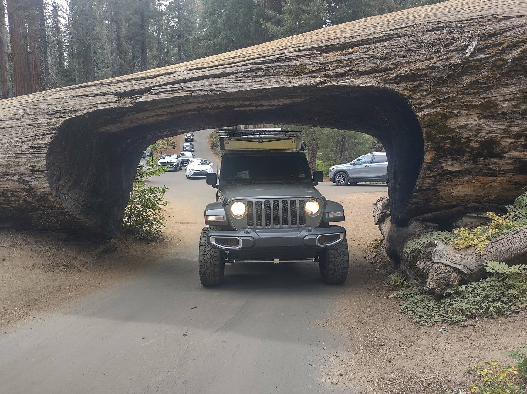

This is 8' and although it didn't look like it fit. I had to slide all the way to the left side to avoid rubbing my solar panels. Edit: 2.5 Clayton Overland lift and Rubicon take off tires.

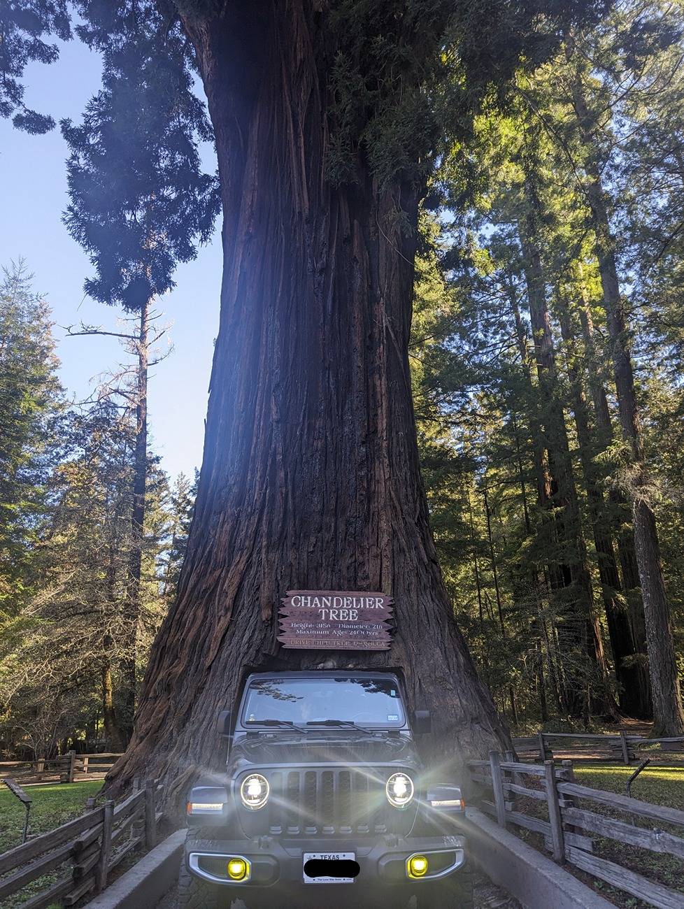

Stock sport S here, no lift but on 33s. I haven't found a spot it won't fit yet.
