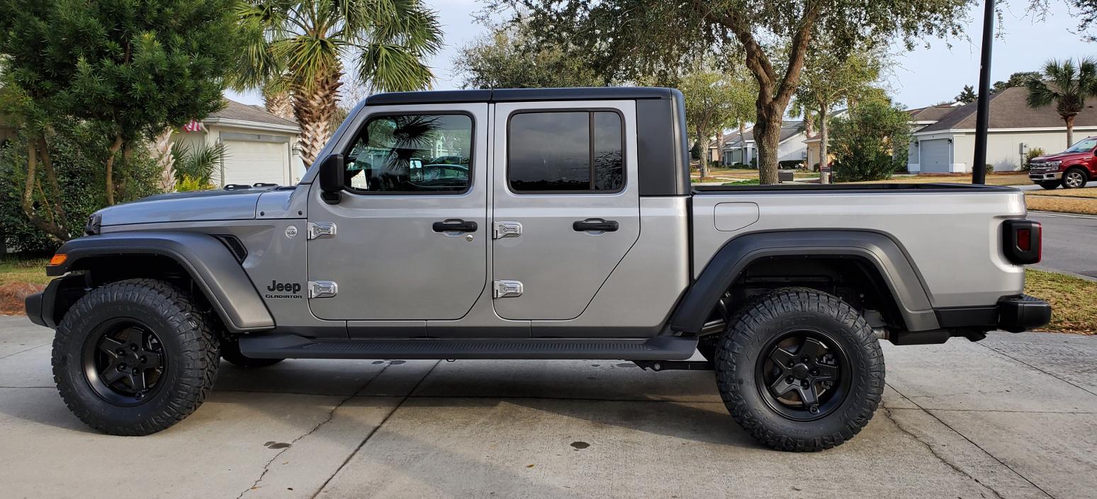

I spent a ton of time researching this topic. Ended up going with 285/70r17 in Ridge Grapplers. I wanted something with a more aggressive look, filled up the space a little more, capable when I need (grippy and gives room for articulation), but not overly loud or annoying when driving. For me, this tire nailed it on my stock Sport S. I personally think anything bigger looks silly on stock, but to each their own.

your set-up is what I am leaning toward for tire brand and size. Do you have a pic you could share of your tires on your Jeep?

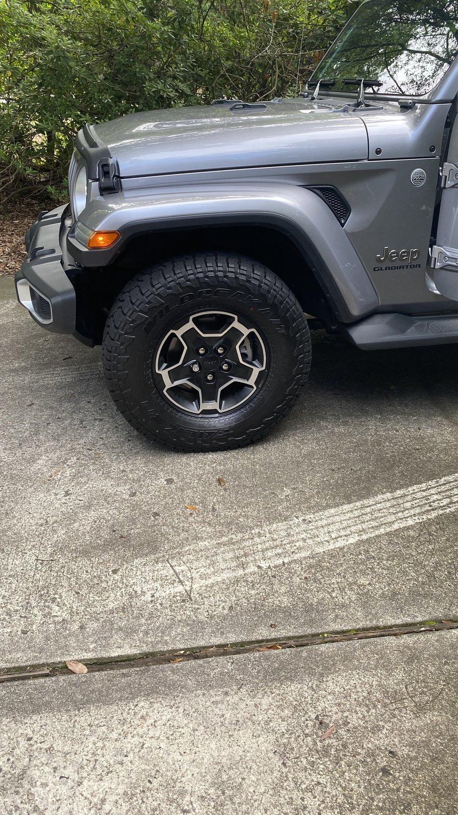

I found some Mojave take offs on here for $580 that are 285/75/17” with rims for my stock Overland. They fit like a glove.

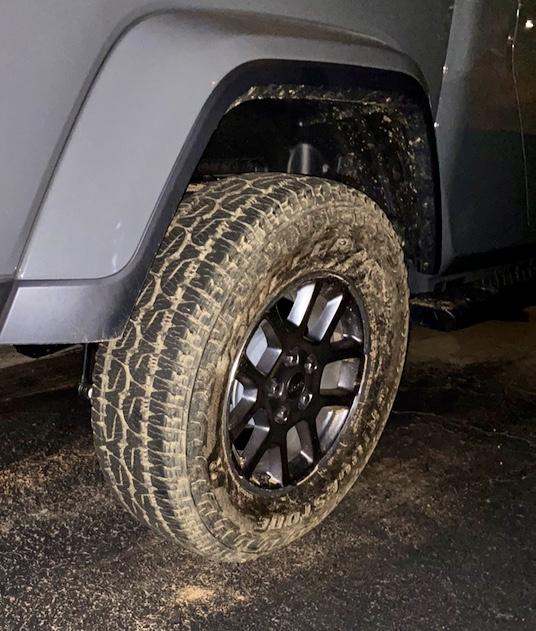

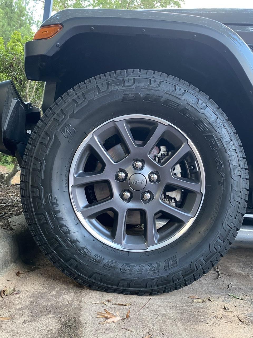

That looks great. I just kept the stock 18” wheels and put 275/70/18s Dueler A/T Revo 3s on it, which is roughly the same size (slightly bigger). I’m very happy with the look. Rear/Front Dirty/Clean

Looks good NC.......now that you have the 275's with stock rims on your Overland, can you tell if maybe you could have gone to a 285 or bigger without rubs?

Yes, easily could have. That's only a 33.5" tire. I thought about 285s, but the tire I chose, after a lot of research, doesn't offer it in 285/70/18, I would have had to go up to a 295/70/18, which is almost a 35 and I didn't want to push it.
FWIW, with an 18" wheel, those 275/70/18s are about 1/2" bigger than the Rubicon "33s", which aren't quite 33s in actuality.
