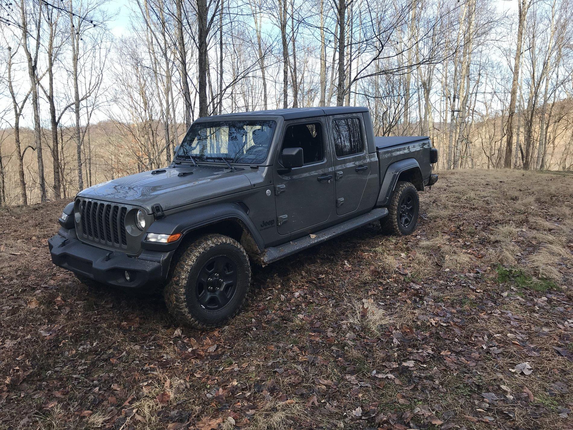

Rubicon tires on a Max Tow look great. That said, to me, 35s are better and adding rubicon fender flares is best.
32" Falken MTs (slightly smaller than stock Rubicon tires)

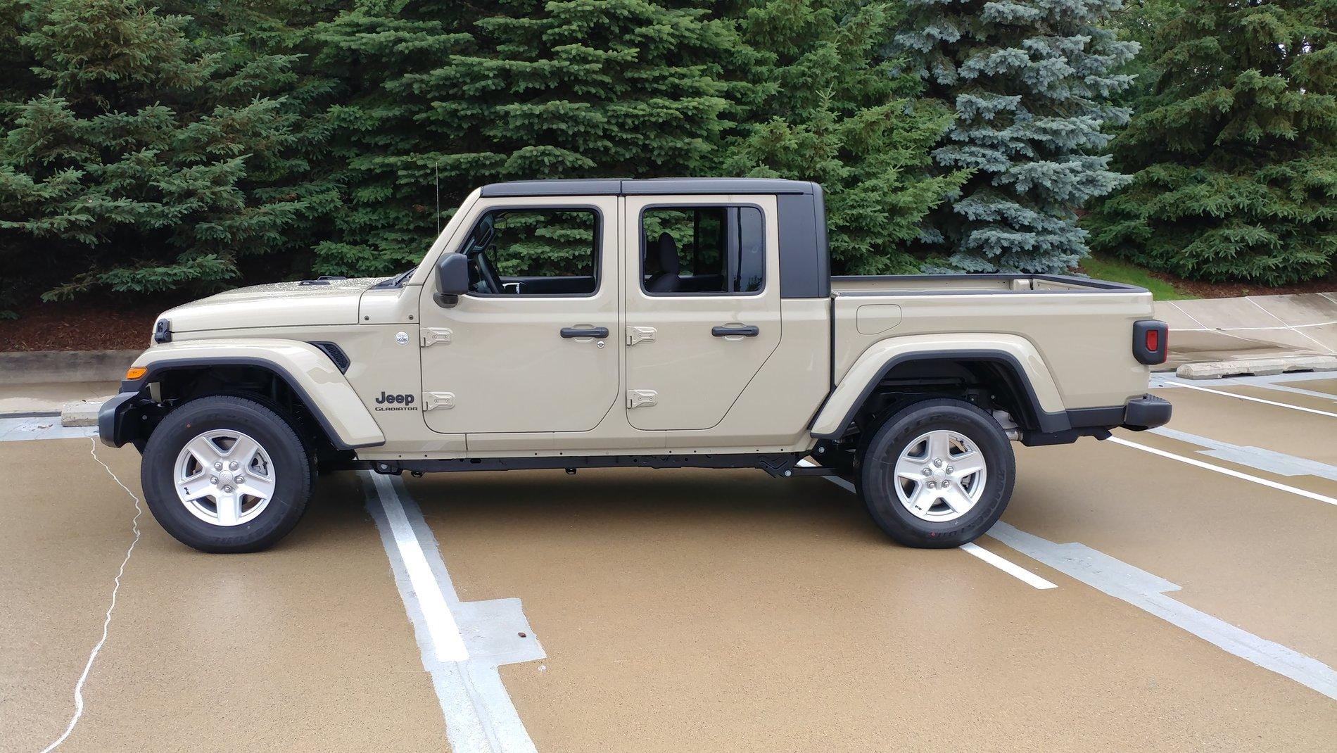

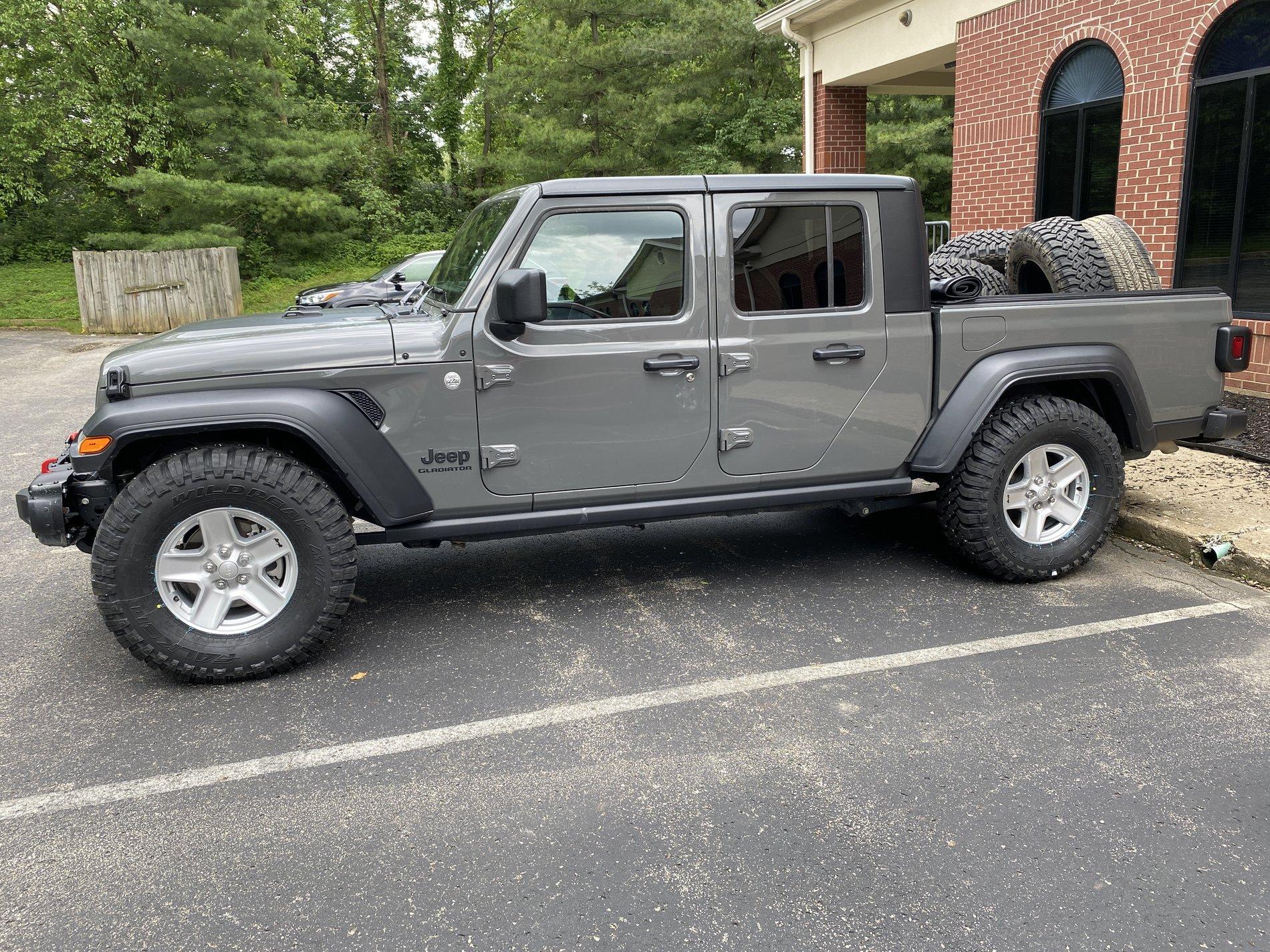

35s on stock Sport S Max Tow (not even spacers)

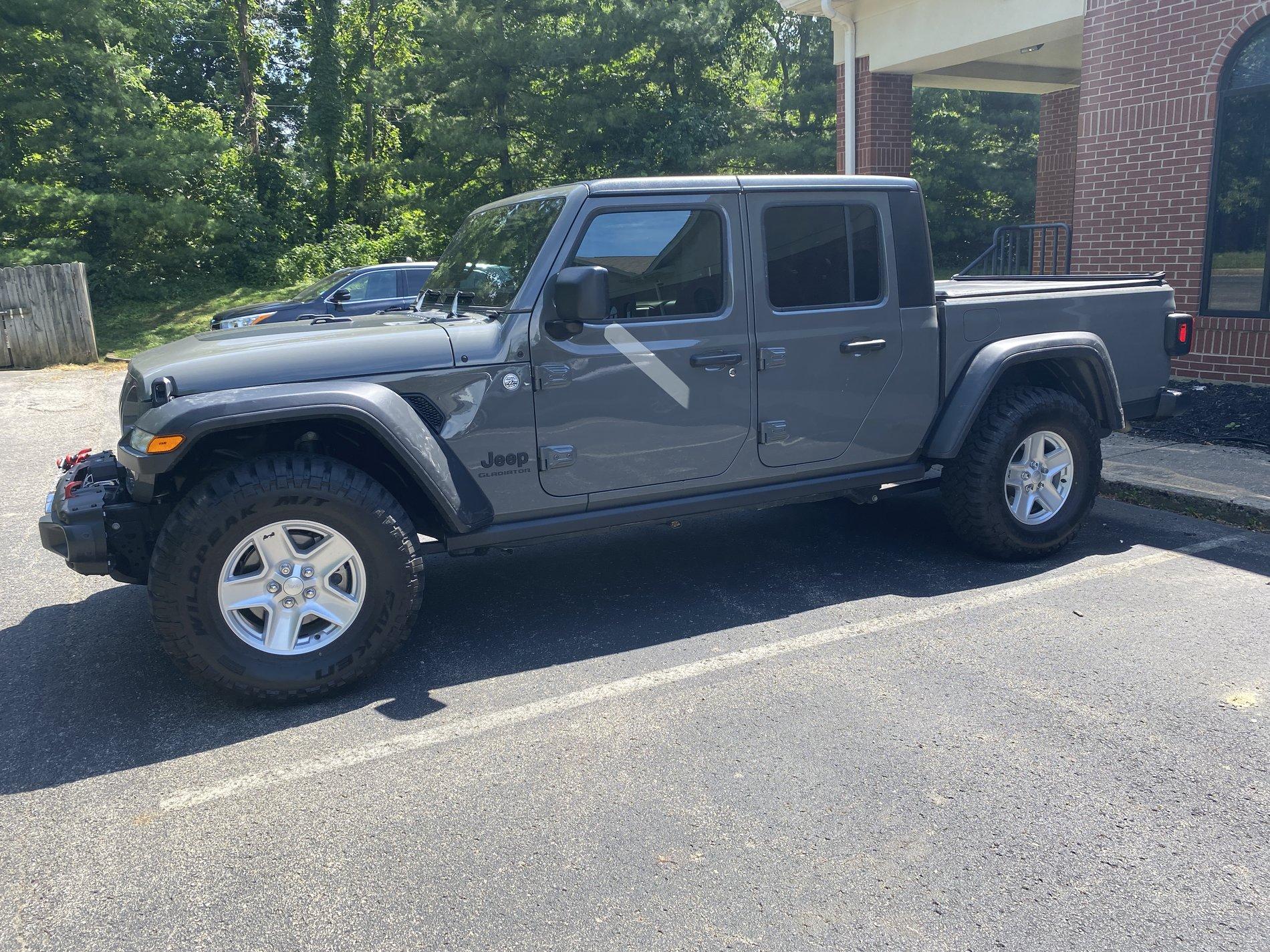

With Rubicon fender flares

Patriot looks great but that second pic with those tires are awesome looking. What are they? Also what is the difference in Sport S and Rubicon fenders?
Falken MT01 35x12.5x17
the rubicon flares add 2”’ of clearance and have different light brackets and liners
