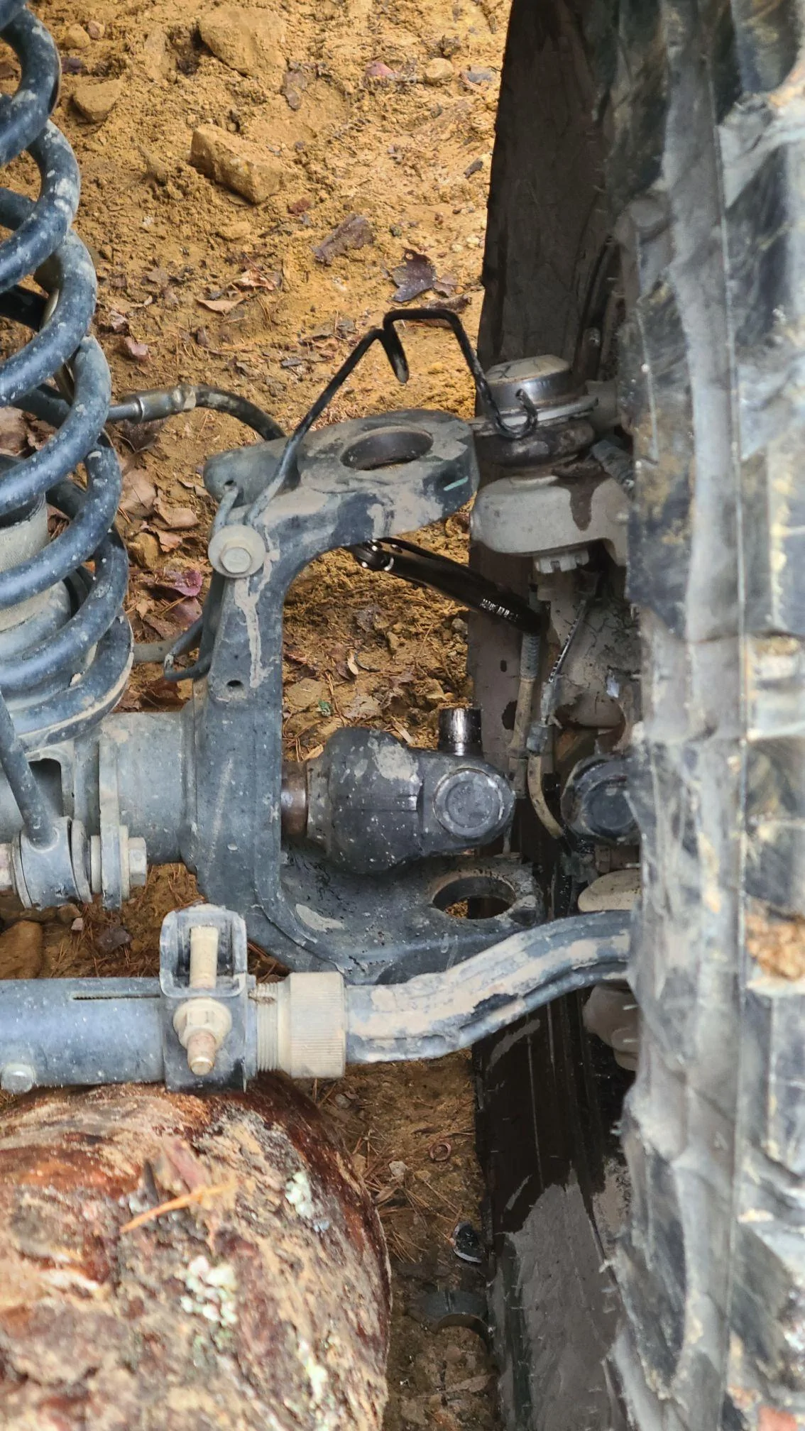

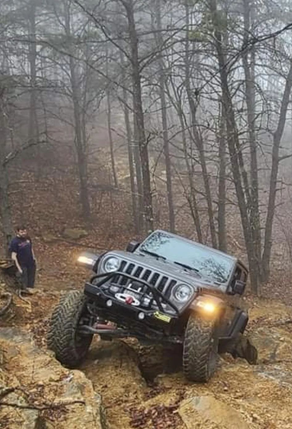

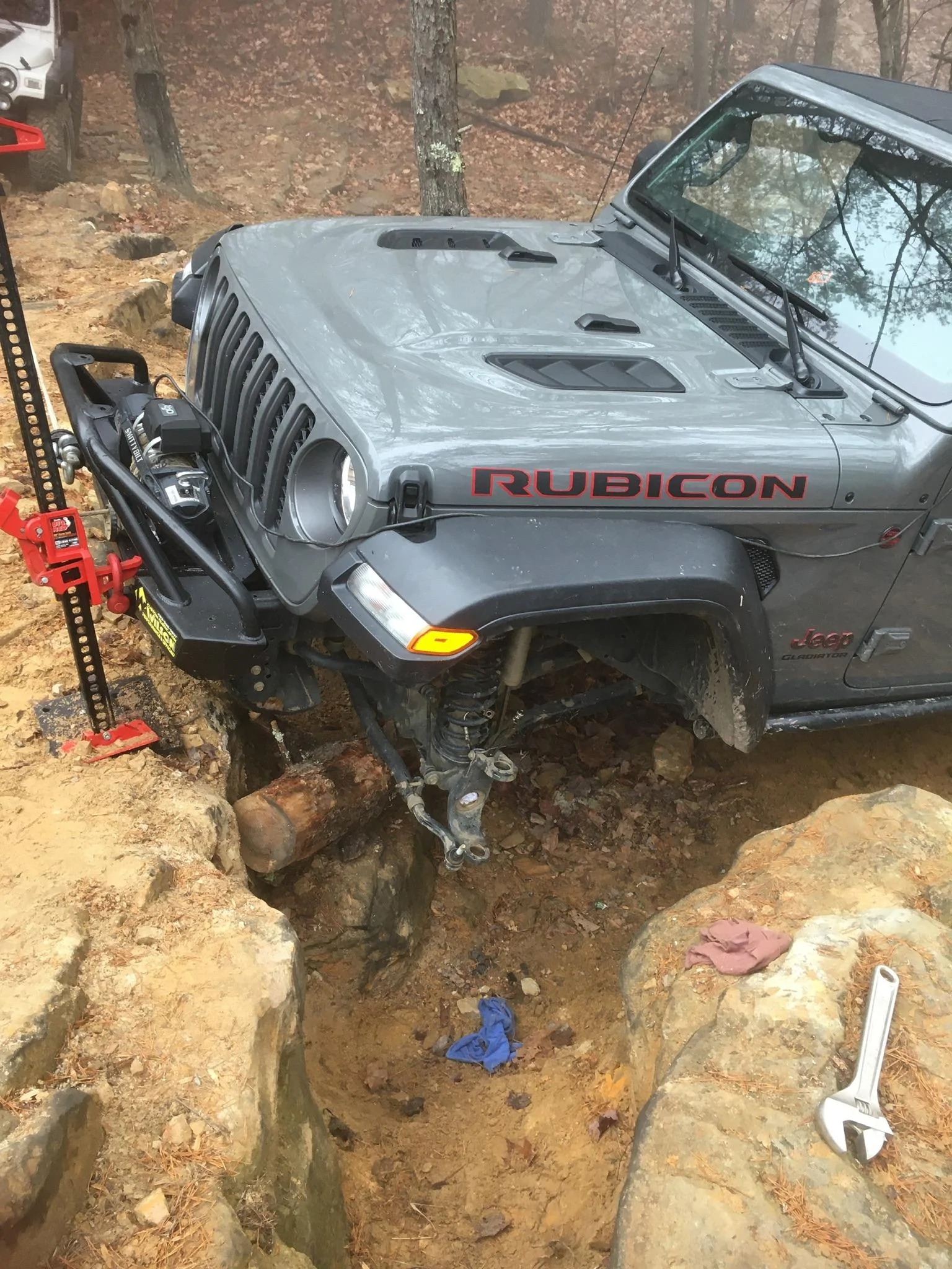

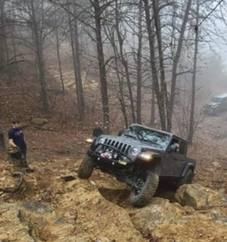

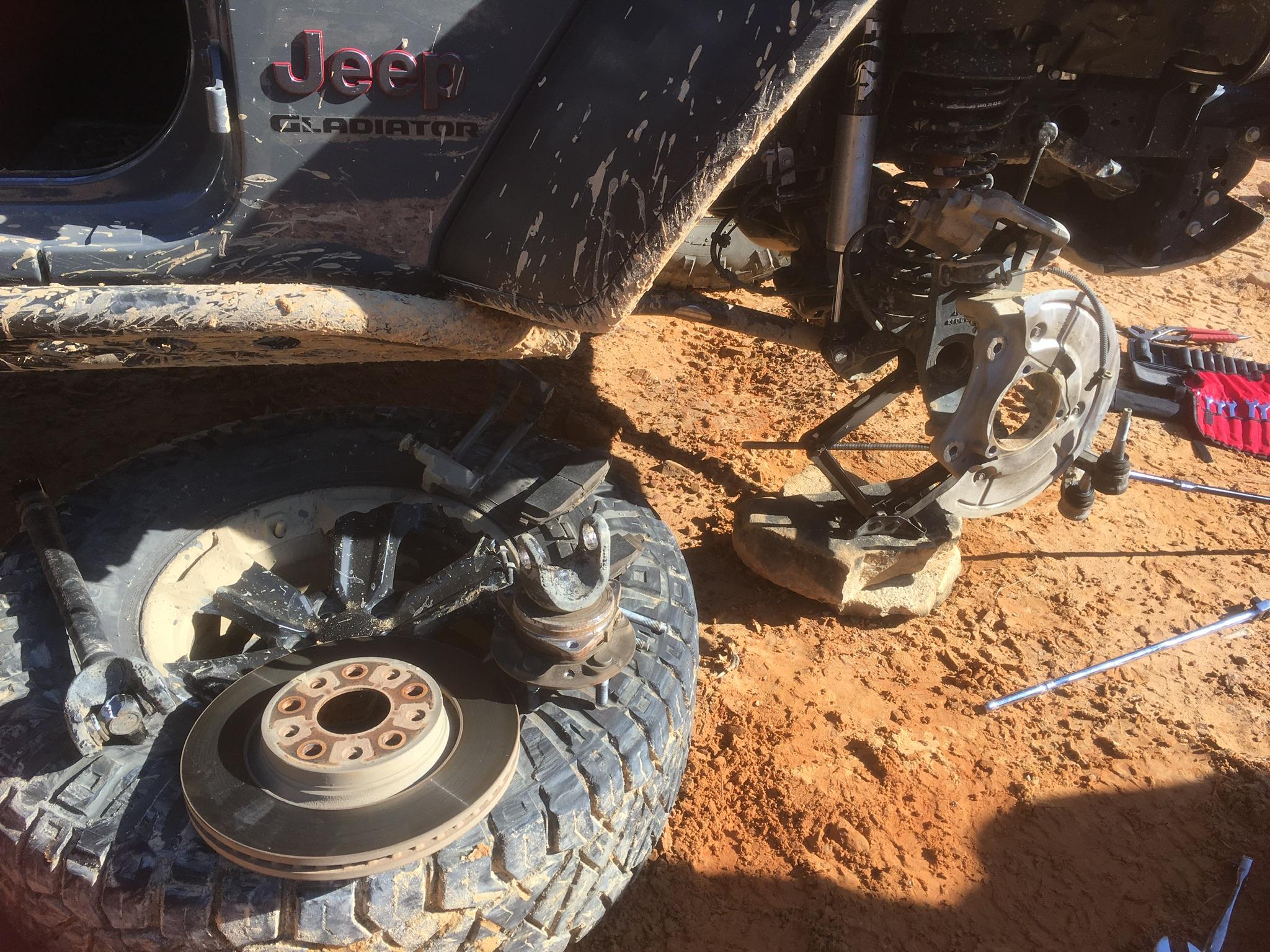

Looks like he was using a rock and a log to try and get up a ledge that was too tall for him, and things went badly. Possible 40s would have helped clear it. Hard to say.
The front made it up that ledge without problem. I wasn’t able to get the rear up without risking damage, so started trying to work myself out. I managed to get the back end over in front of a tree, kept trying to get myself out, and popped the u-joint. Instead of being (half) smart, and getting winched at that point, I continued to try to drive out of my predicament. The turning inner shaft forced against the stationary stub shaft, and the ball joints popped out. I slid that log under the axle after the fact as insurance in case the jack didn’t stay put. I ordered up a ball joint press and put it back together and drove out. I definitely learned from my mistakes that day. I had done that climb several times previously, but the traction was low that day.

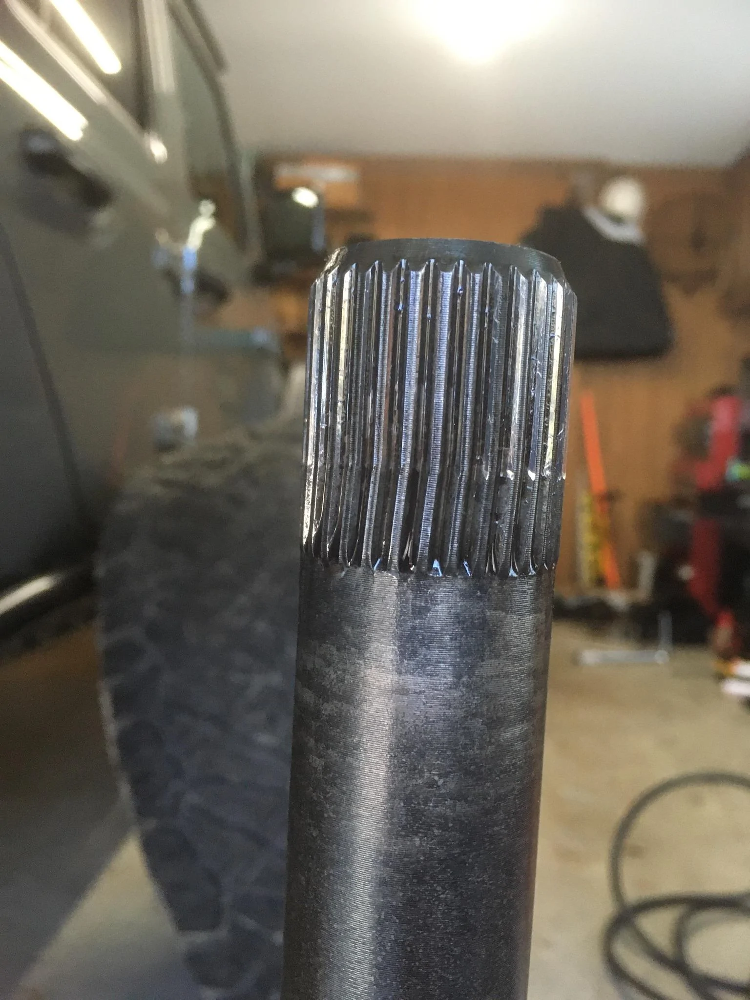

The 2nd two photos were a different day. There was a bounce that day, but it really wasn’t that bad. I think I had ejected a u-joint clip prior to that, and the joint walked and broke. The twisted splines are from the rear. I wouldn’t have known about those had I not upgraded to chromoly shafts.

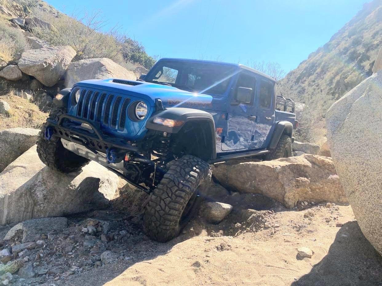

I won't say there isn't risk because there is always risk but these 3rd generation Dana 44's are much beefier than the gen 1 and 2 in older jeeps. I ran 37's on my 2016 JK for years running very difficult trails and never had an axle problem on the gen 2 44's. Now with my Gladiator Mojave I'm on 40" STT Pro's with the stock m210/m220 axle and feel confident in them. I'm in SoCal and certainly take a rock crawl approach. I'm not a rock bouncer or skinny pedal wheeler. Its early as I've only ran 2 difficult trails but no issues yet.
I know my answer isn't the popular opinion but your getting the answer from a guy who wheels with 40's and stock 44 axles. I would never talk someone out of going with stronger / bigger axles but I want to impart real world testing knowledge.
