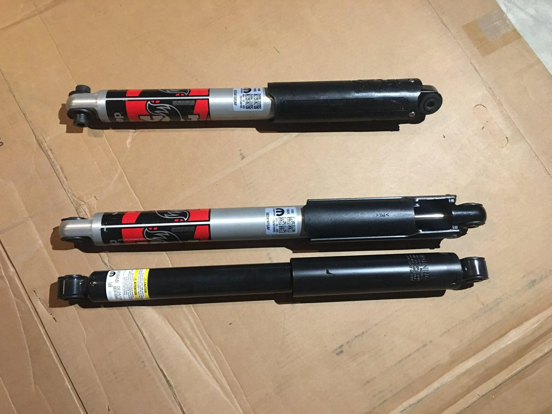

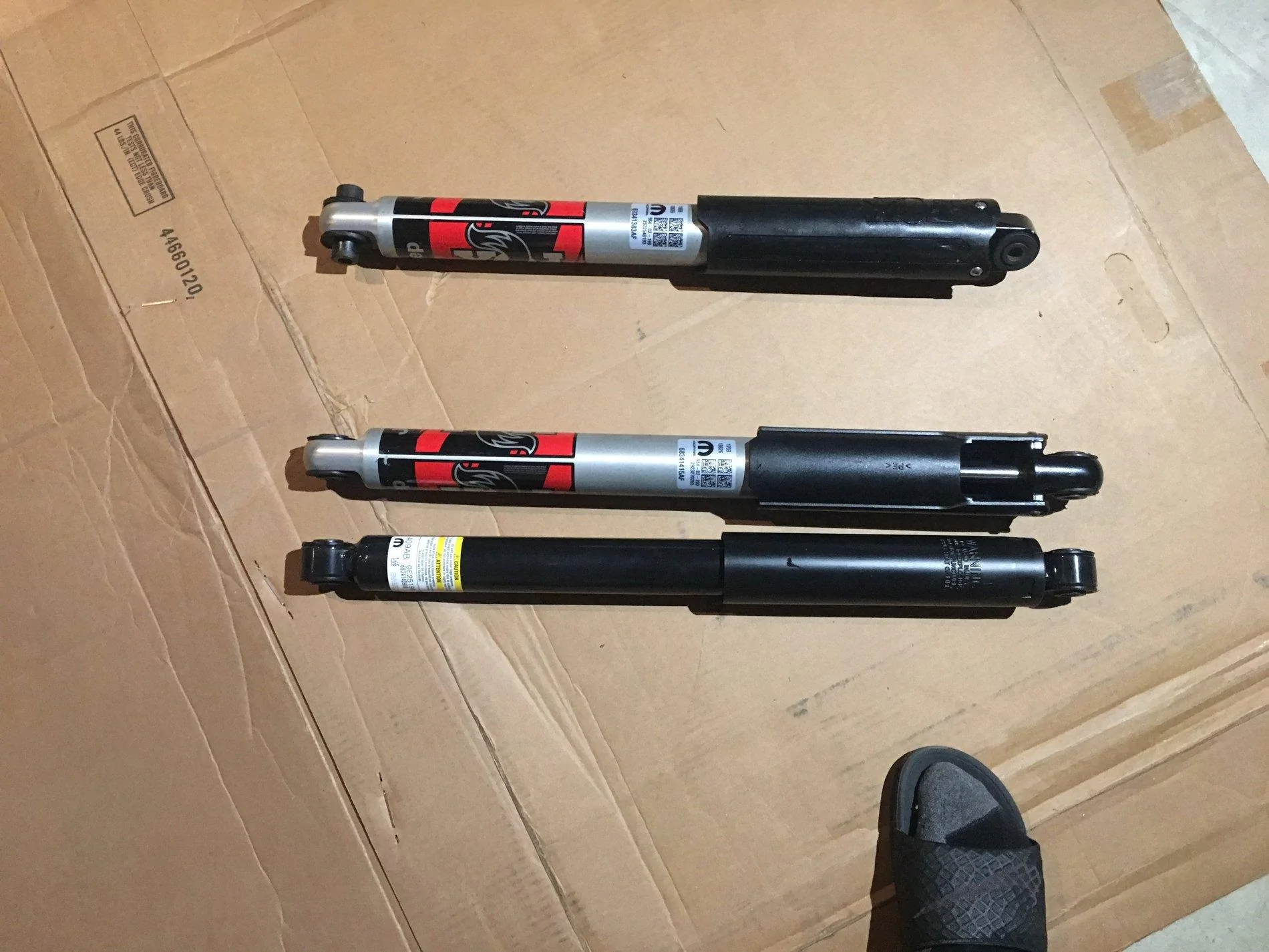

By not using shock extensions but using bump stops, you are decreasing your suspension travel compared to stock.
Yea I think you’re right here’s the shocks side by side Rubicon rear vs Sport max tow. Rubicon rear shocks aren’t longer!
I’m betting the front are not either...but I haven’t pulled them yet. Maybe tomorrow.
If they are the same length then extensions are probably the way to go.

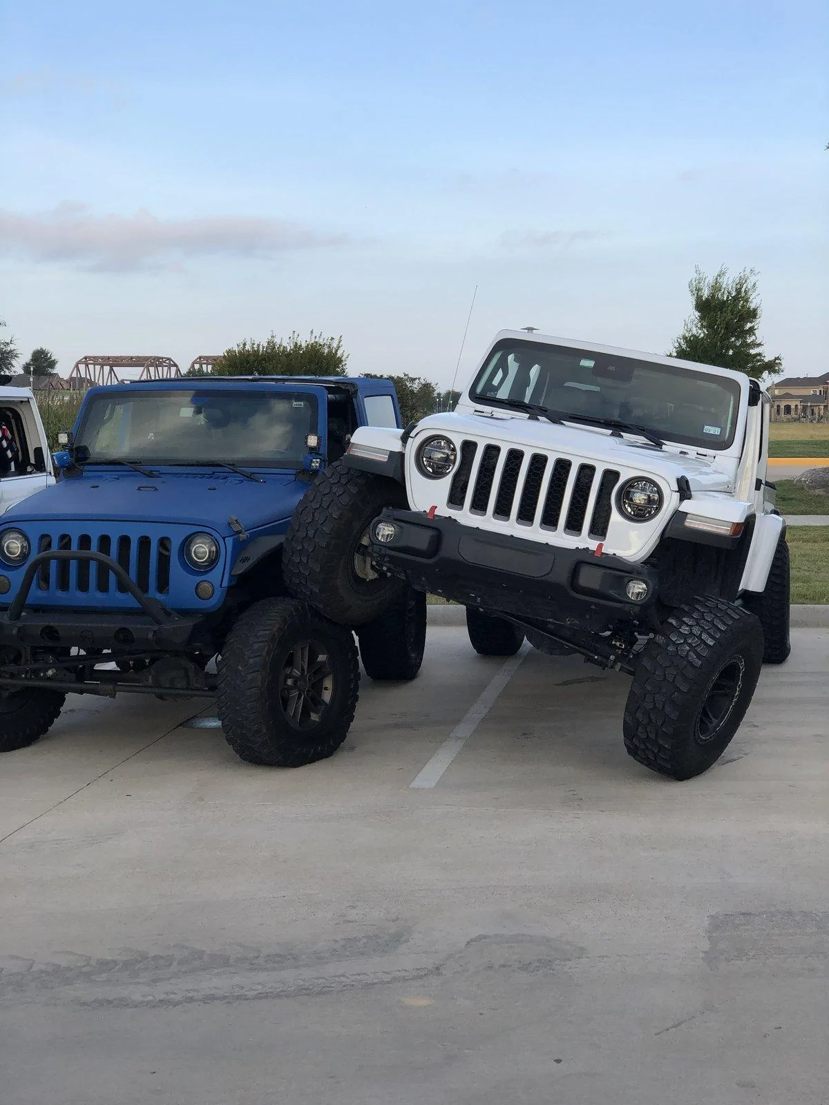

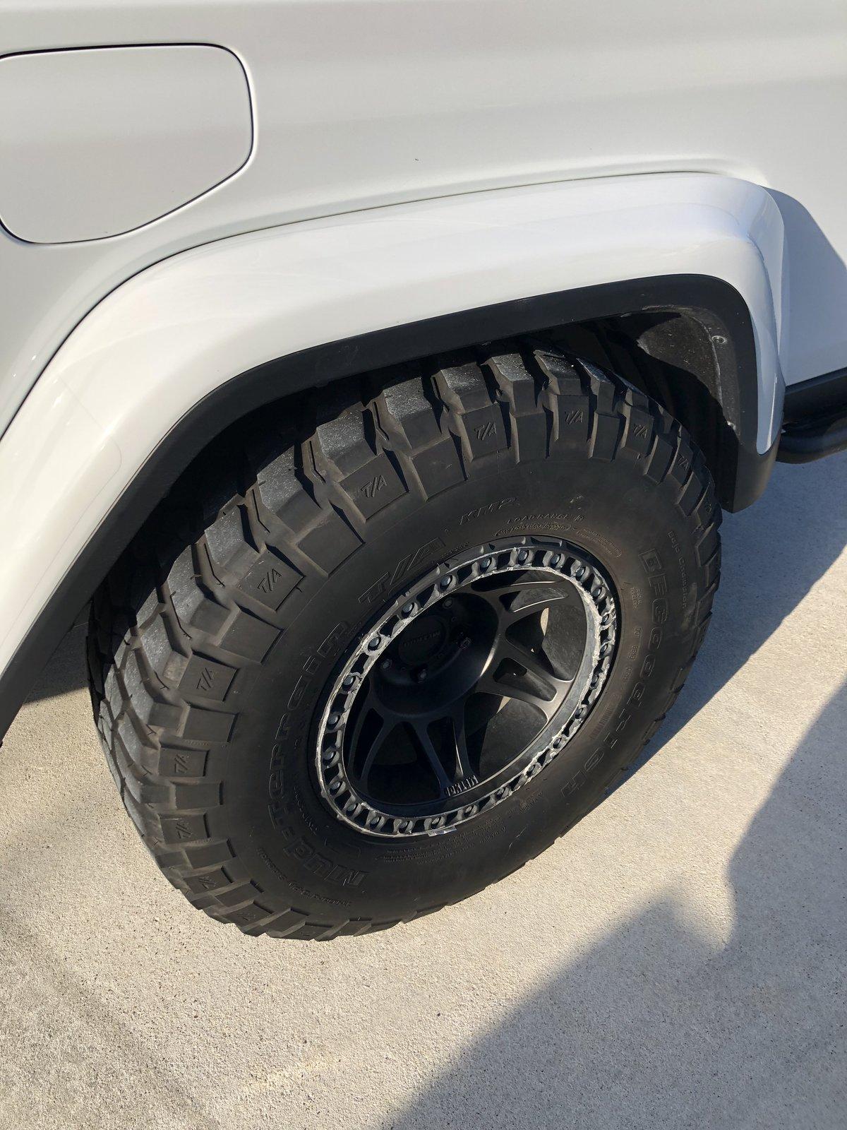

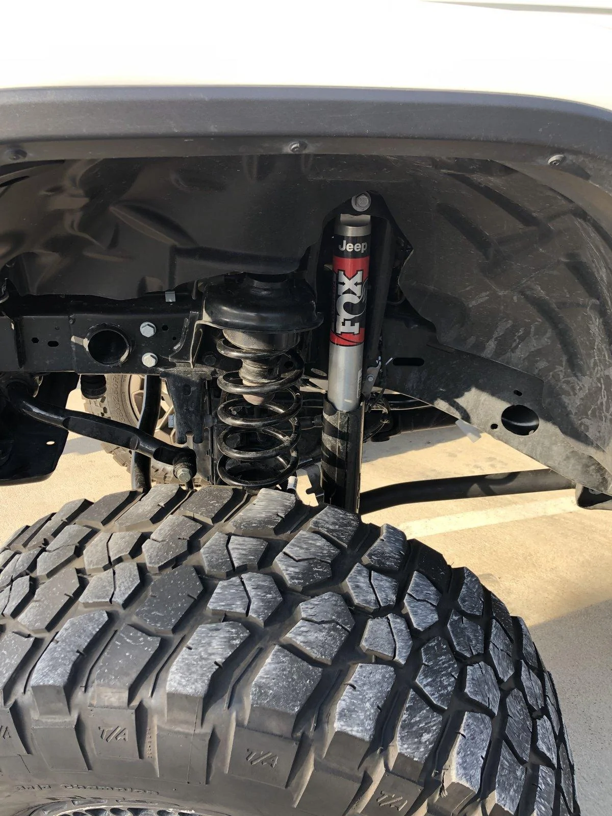

2020 Bright White Gladiator Rubicon
Would install the bump stops for the front. Here is mine with a 2" Daystar spacer lift and 35" tires. There is about 1/2" inch of space in the rear before hitting the axle. Front is against the bump stop.
