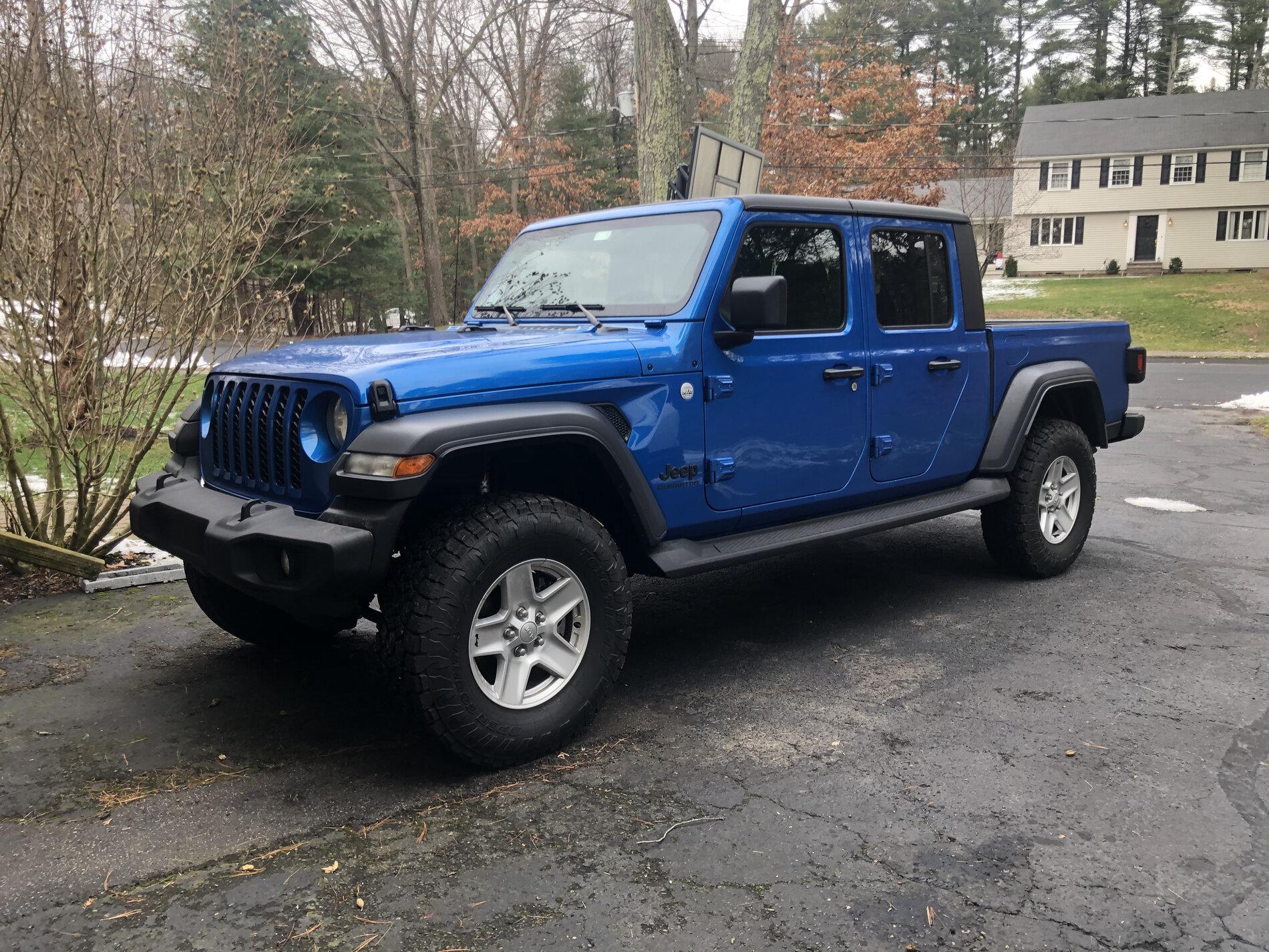

Jeep Gladiator Stock Wheel (17x7.5) All Terrain Tire (33-35) Guide D7D32937-66BC-44FB-82D5-431B362917CB
What suspension upgrades from stock do you have?

2020 JT Hydro Blue Max Tow
I ran them on my sport S max tow with stock suspension for a while, I had no issues or running anywhere. I raised my JT pretty much just for cosmetic reasons, the setup in that picture is 340 and 343 front coils with Daystar 1.5” front spacers Daystar .75” rear spacers I also have Fox shocks but that didn’t change the height at all. The coils and spacer raised the front 2.5”. I have Mopar LCA also which add back some caster. It rides and handles pretty well with the current setup.

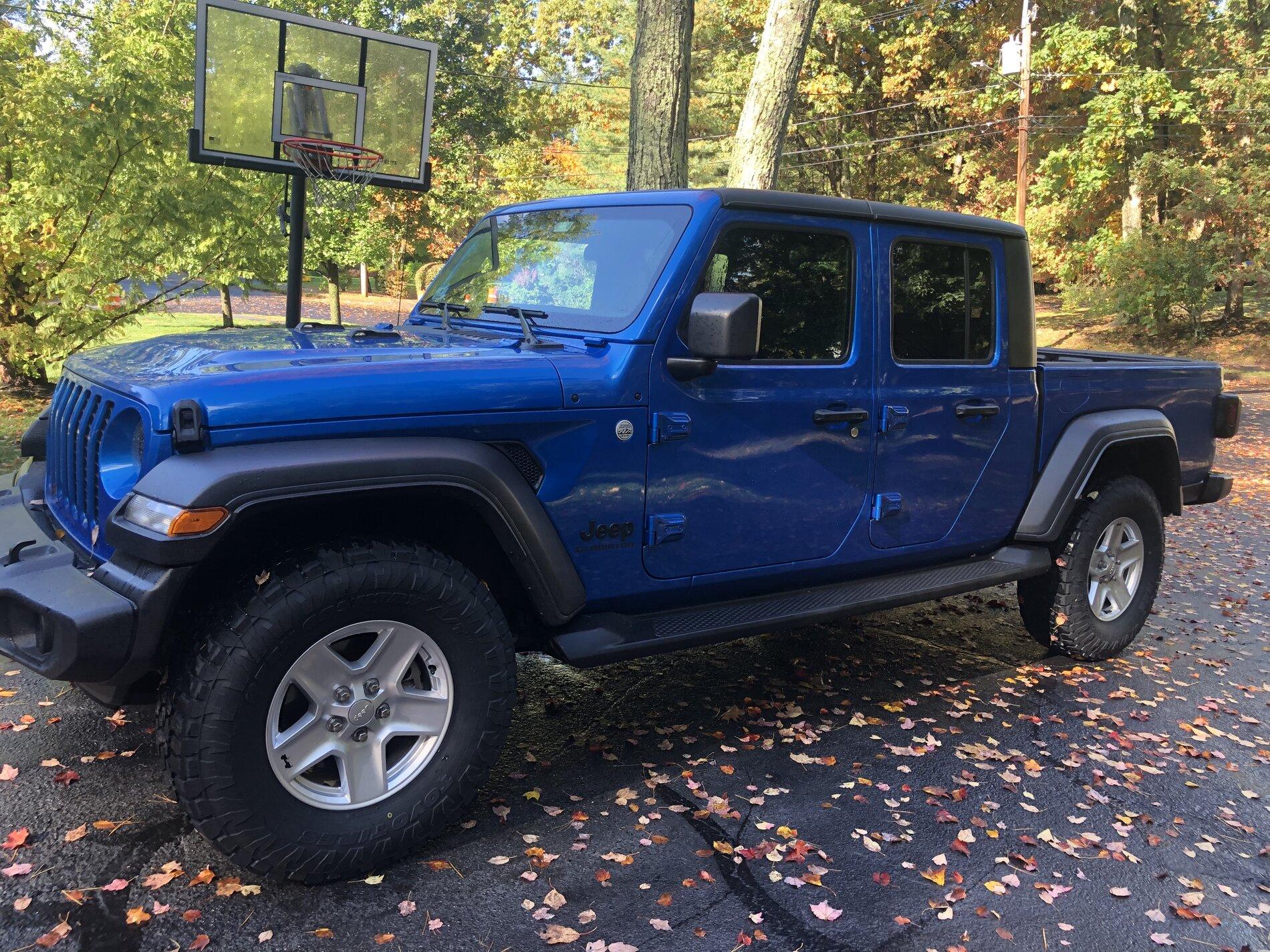

This picture is on stock suspension.

Are you happy with the ride so far?
You have other 285/75/17 listed though..
Happy so far but literally got them installed a couple days ago so not much time in the vehicle. It’s sitting on jackstands at the moment while I wait on a breaker bar from Amazon to loosen the control arms and install 1.5” level kit.. woops!

Jeep Gladiator Stock Wheel (17x7.5) All Terrain Tire (33-35) Guide 03961F54-013C-4D20-8D7F-91BE6DF1344C
That’s the same plan I have, looks perfect. Just curious, do you have an exact height measurement of the 285/75 mounted?

I do not, I can measure them tonight and reply with the info.
