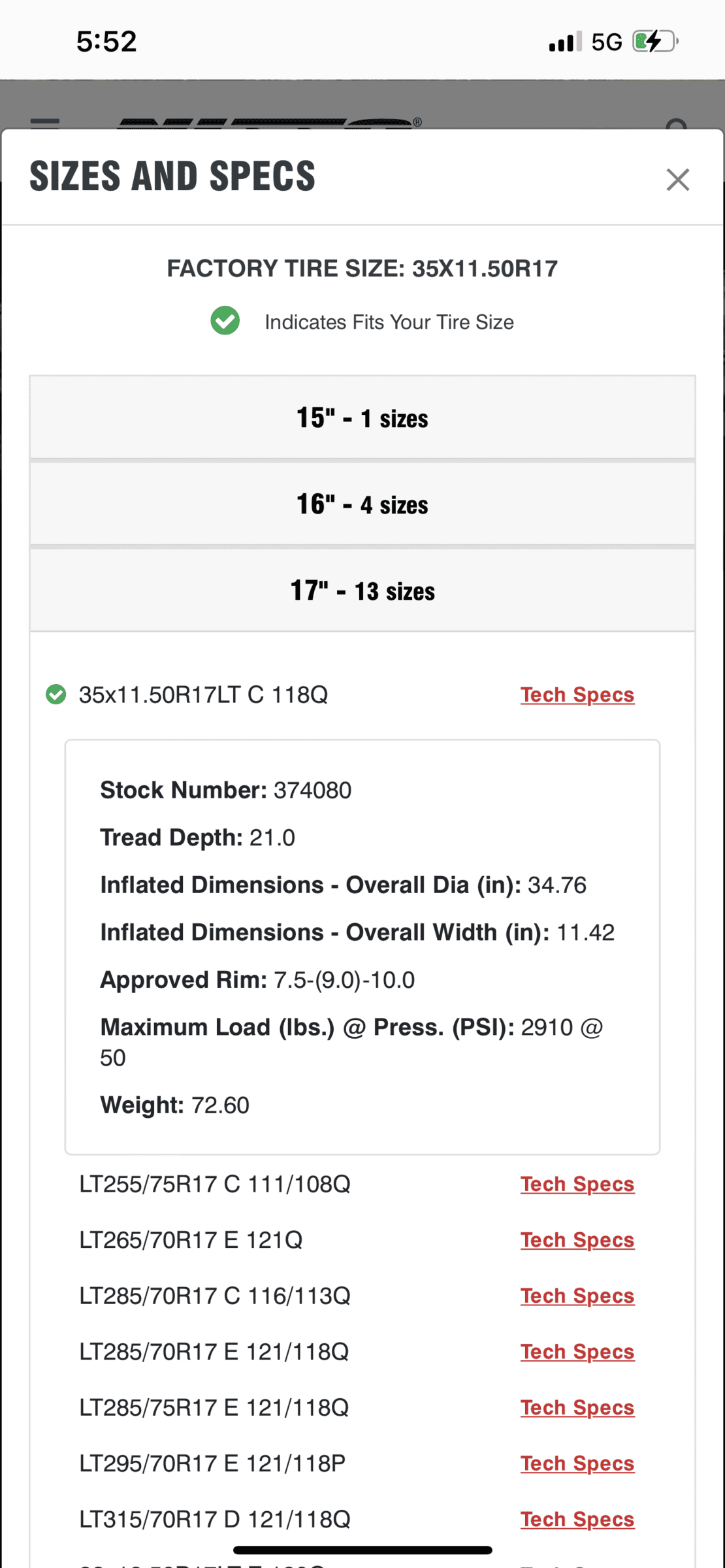

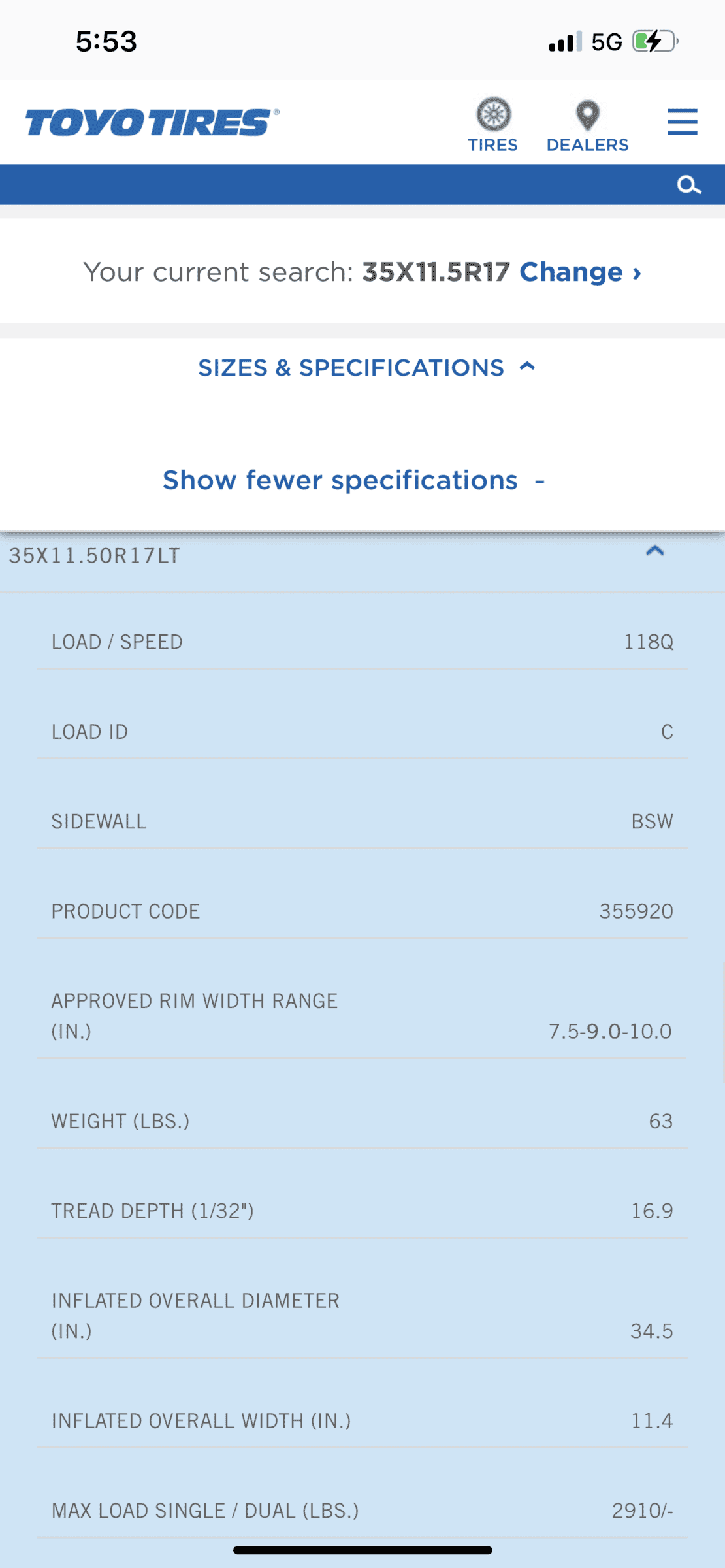

35x11.50r17 Nitto Trail Grapplers fit on the 7.5 rim and in spec with no worries of premature tire wear. Same with the Toyo Open Country AT3’s. I’ve had nothing but love for Toyo RT’s so whenever mine need changed I’ll probably try to find a set of those.

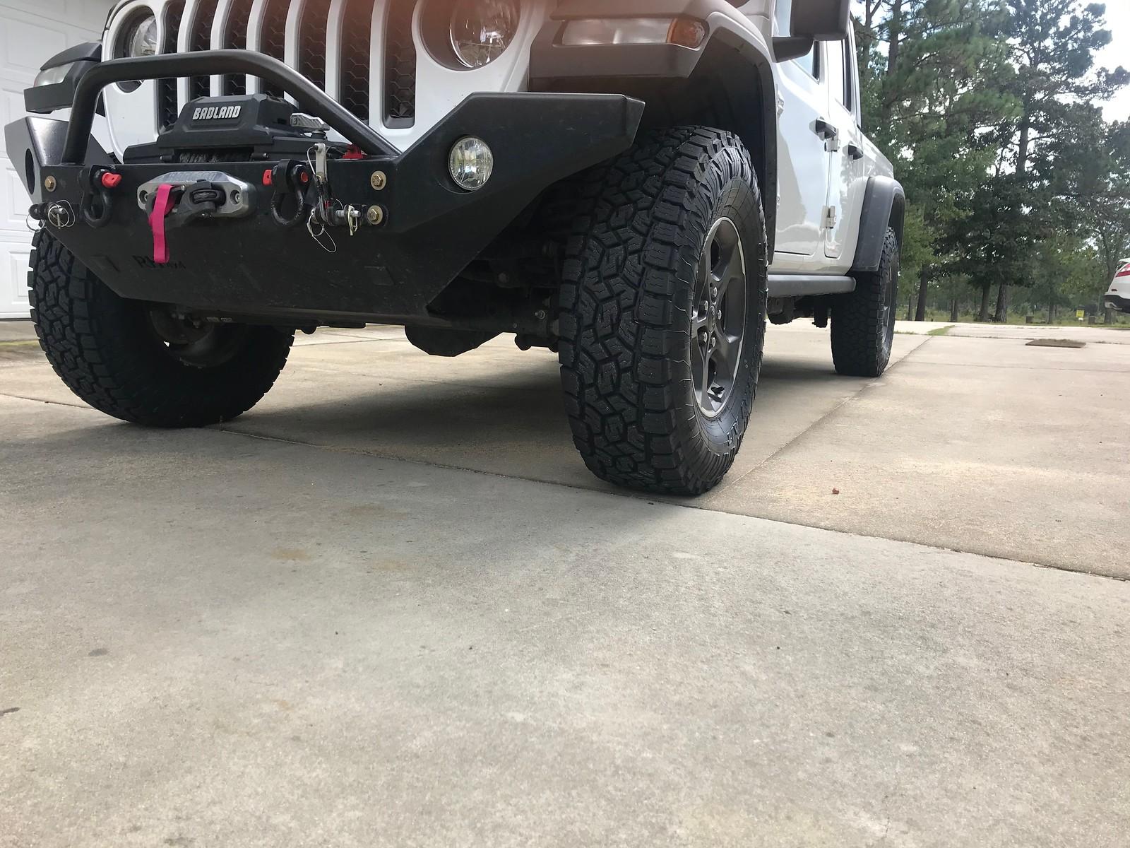

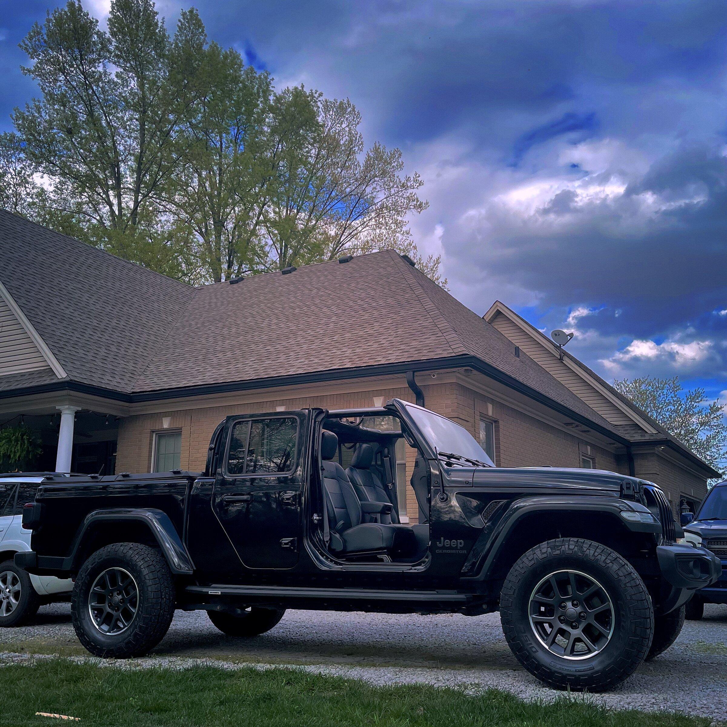

I use Toyo 35x11.5 all terrain tires on stock wheels, mostly because they fit under my fenders.
