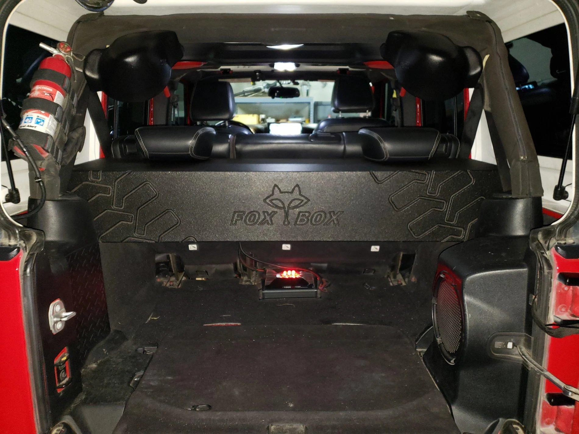

Yea I had 2 - 10's in a fox acoustic box that rested on the fender wells and fired down. It sounded amazing with the top on and still sounded pretty good with the top off too!!

That was the setup I had in my JK. How does yours sound with the top off?

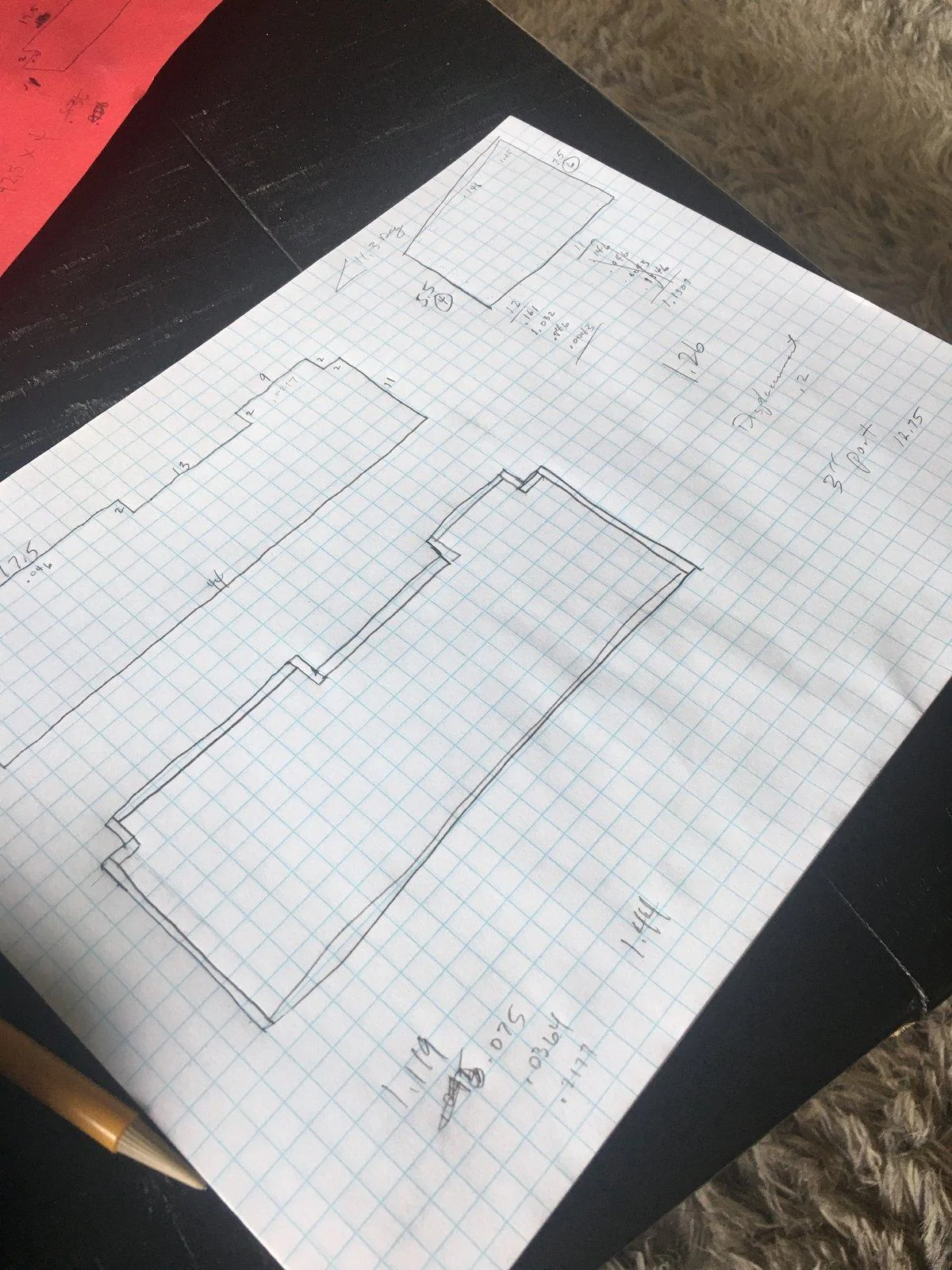

I'm almost done with my box! holding 4 sundown x6.5s (2000watts rms) and a ds 18 top with additional 4 8s& 4 super tweeters (1100watts rms)

Under the seat? I think I might start a fiberglass box soon and use an older JL 8w3v3 I have sitting around, but even that might be too tall
8s won't fit! only have 7.5 inches at front of seat and 8s require 9 inches to mount.
Are you sure? I measured 11 inches from the front of the rear compartment under the seat to the bolt storage box. Mounting depth is the real challenge.
yes if you are building a downfire box. Most likely need a shallow mount sub max internal dimensions are 4 inches at rear and 6 inches front
I think the cabin is small enough where it won't matter that much on orientation, but firing down probably would give you slightly better gain. I think firing up directly at the seat would be fine
yea i agree. Mine will be facing forward with port in middle.
