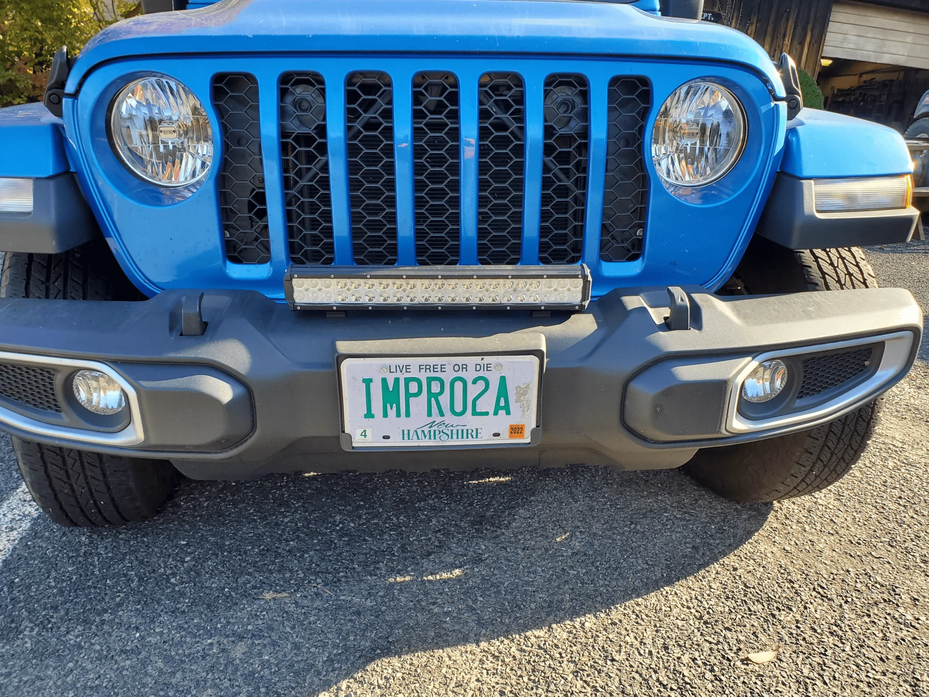

Looks good can you show a picture of the bar from above?

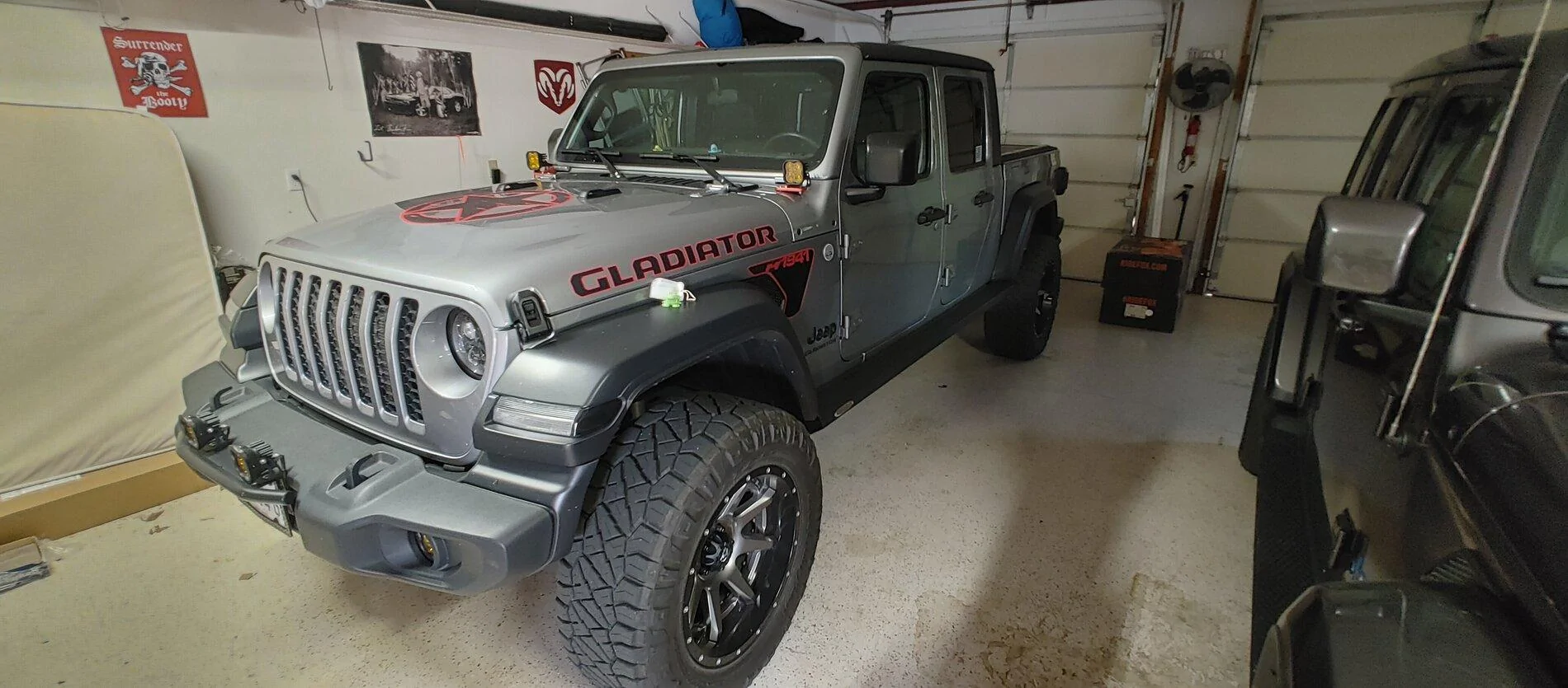

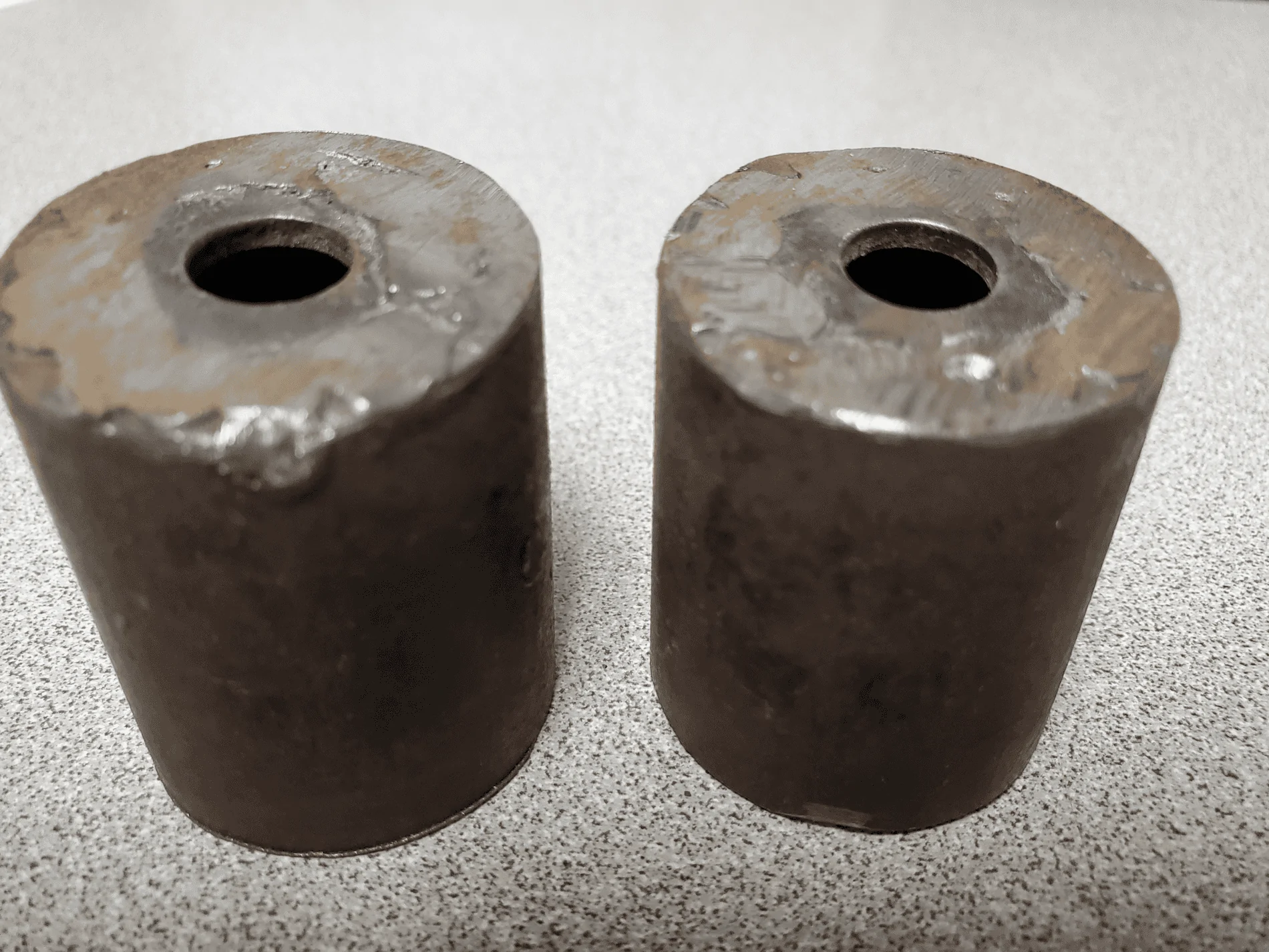

I welded up some metal spacers that go inside the bumper between the plastic and the metal support, and then used longer (2" I think?) bolts to mount the light. This is the only picture I have, I did paint them black before installing. You can't tell in the photo, but there is a slight angle on the top to match the plastic. I bet someone could 3D print something like this really easy and still be strong enough for support.
I don't ..... Got hit by a tahoe and now I have a rubicon steel stubby
