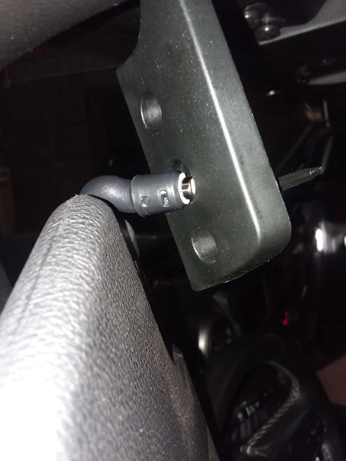

With 3000 miles on my JT, the driver's side sun visor pivot came out of the boss in the panel that bolts to the header. After removing the panel (two sheet metal screws, T25), I could see that there was a plastic ring broken off, which would normally keep the sun visor "rod" in place. The rod is actually a tube with wires through it, for the garage door opener switches.
A replacement is on order under warranty, but the dealer said it is back ordered until August 13. Of course, August in Vegas is when you most need a sun visor. Moreover, the cost is $500 for the assembly, so you definitely won't want to break one when out of warranty. Maybe Jeep Cares can help. I wish the design were easier to repair with cheap parts. I didn't think I did anything risky so worry that it could break again.

Good news! Within a few days of contacting Jeep Cares, my dealer had the sun visor and installed it promptly, also did a Jeep Wave oil change. Thanks to both for their fast and effective help.

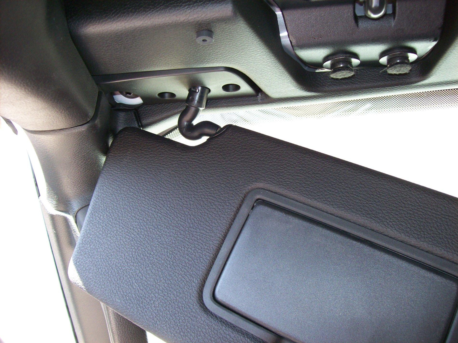

Looks like I'm not the first after all. Time for my first warranty repair.
Jeep Gladiator sun visor broken, $500 20200926_184708
