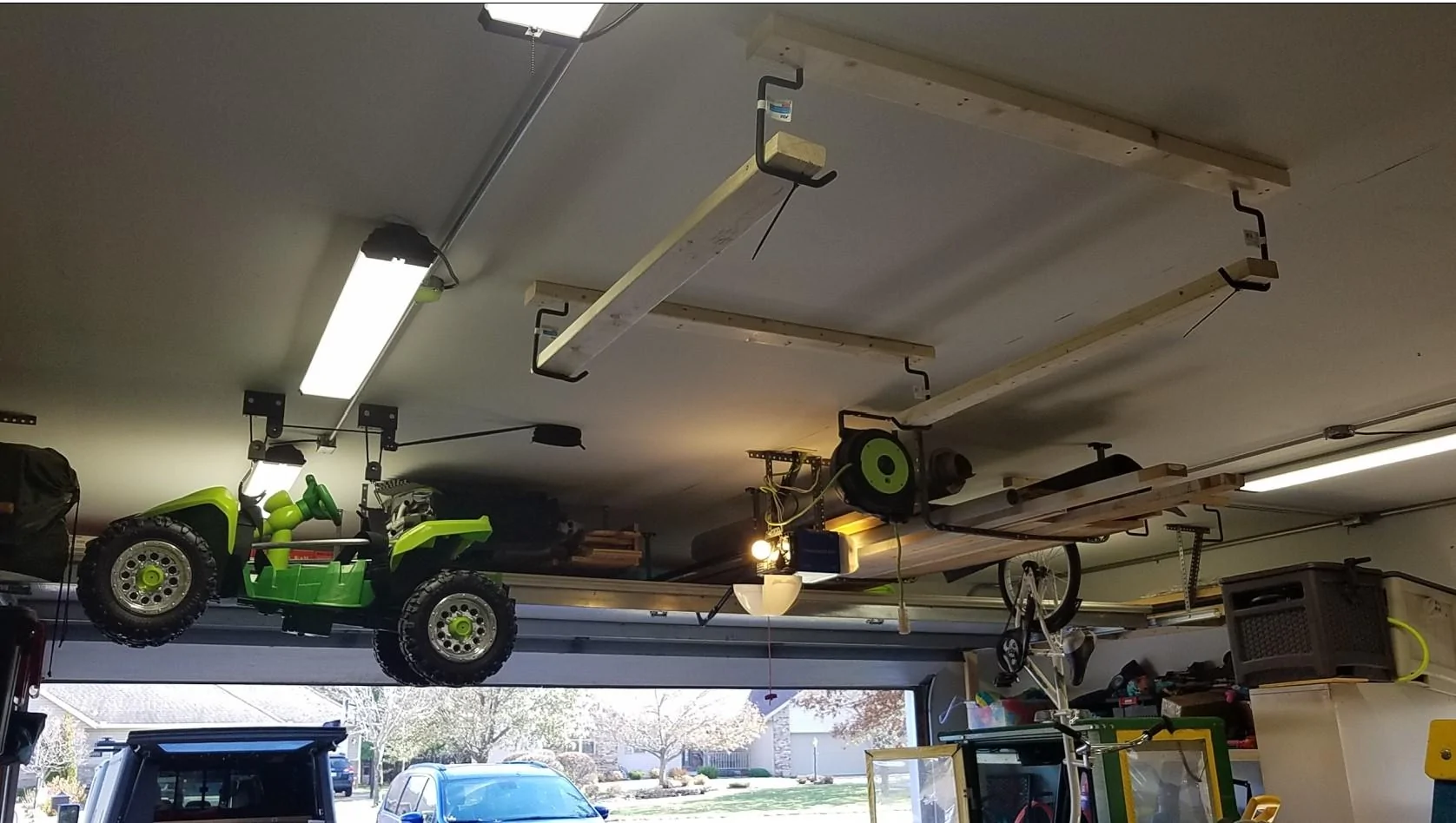

It dipped into the 30s in Wisconsin last week so i took the Sunrider for hardtop off, then it hit the 70s this week because #wisconsinweather. :facepalm:

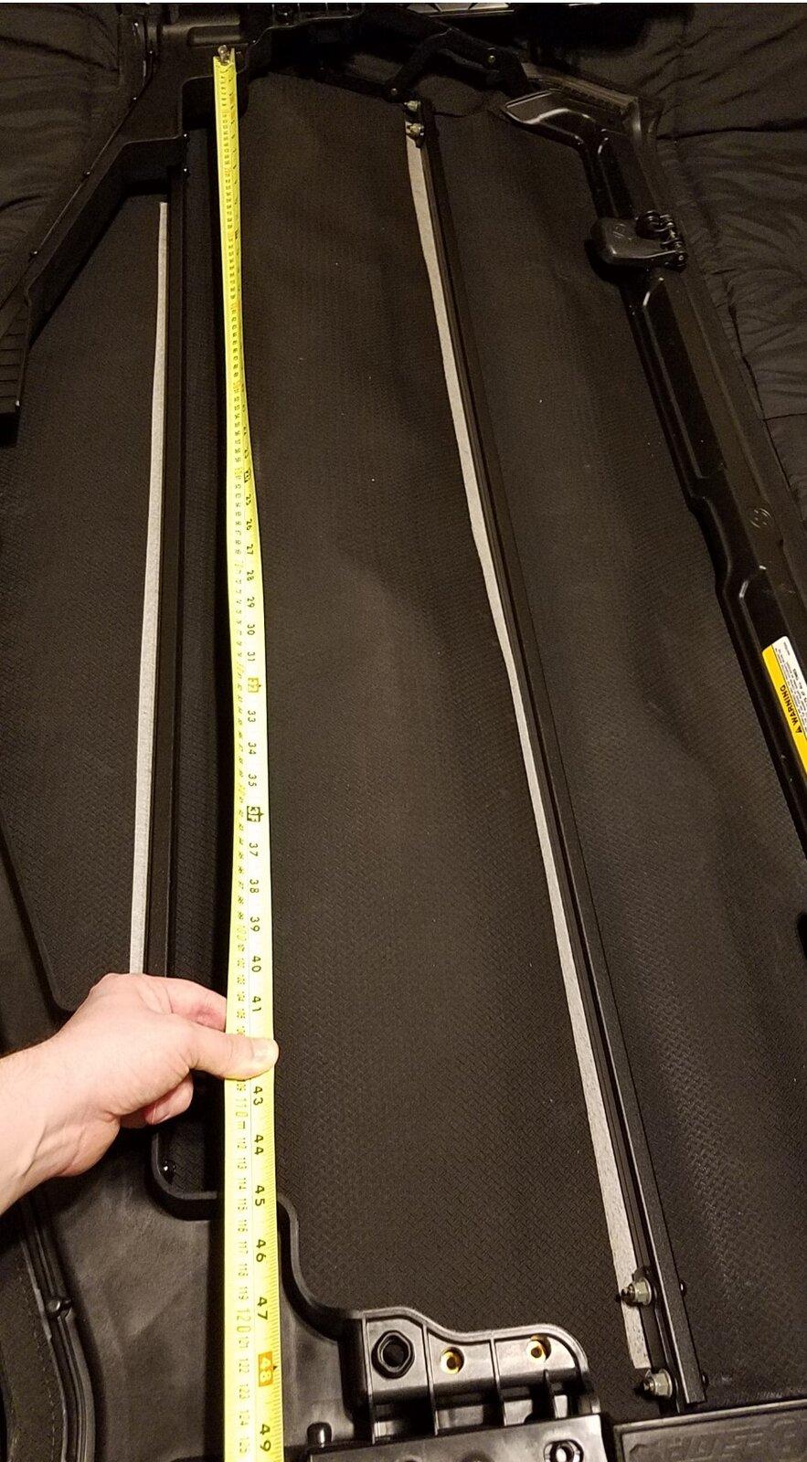

i've been trying to figure out how to store this thing unfolded, but its about 57" x 33". I know my rafters are 24" on center, so I measured between the two red circles and its about 46".
Jeep Gladiator Sunrider for Hardtop storage rack Screenshot 2020-11-07 230456
Jeep Gladiator Sunrider for Hardtop storage rack Screenshot 2020-11-07 224734
So in classic Steffen707 fashion I overengineered this thing. I should have just used 2x4 vertical legs instead of the hooks, but as often happens. Once i get an idea in my head that's all I can see. DOH!

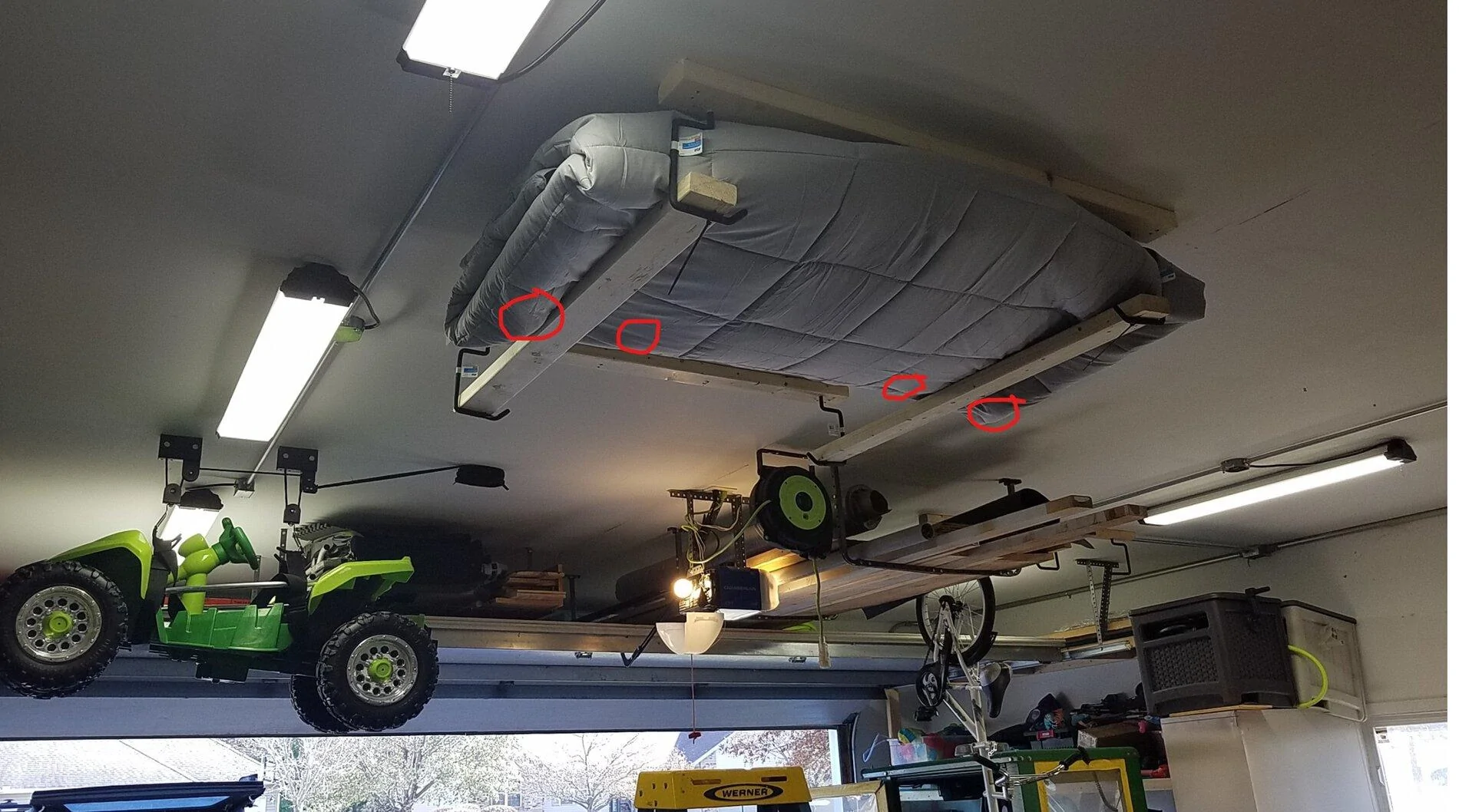

Anyways, I wrapped the sunrider for hardtop in a cheap king sized comforter from amazon to keep it a bit protected as I raised it up and also to keep it clean from my wood working.
Jeep Gladiator Sunrider for Hardtop storage rack Screenshot 2020-11-07 224910
I circled the same front mounting clamps in Red as I did for the first photo. you see the 2x4s sit between them. The softtop clotth is nearest to the ceiling, the plastic frame is all that's touching the 2x4s.
Hope this can help somebody else out. Next time I would just make it all from lumber.

Comforter seems like overkill... and cumbersome to manage - is there a contractor size garbage bag that would fit? Or perhaps the plastic bag that a twin mattress comes in... or even a cheap full cover zippered twin mattress protector if protection from dust and such is required. If someone is handy with a sewing machine you could put a zipper on a king bedsheet to custom fit a cover.
This would have been less expensive and smarter.
so if somebody does this, i would suggest a zippered mattress protector and make the distance between the bottom 2 boards at 46" and make the boards for the rafter at 48" on center as this will work for 16" or 24" on center rafters.
