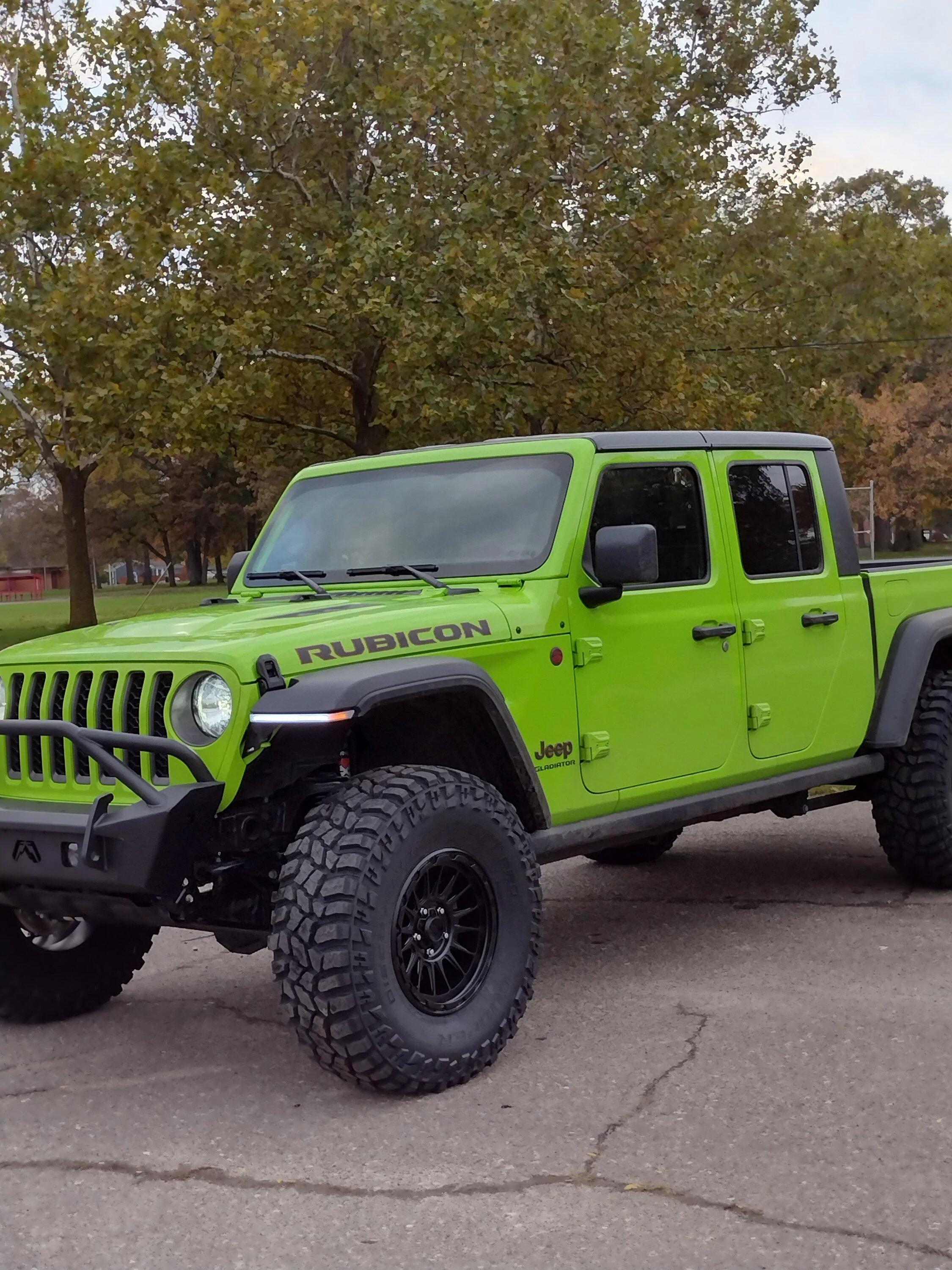

Here is a pic of my rigs 1st suspension . It's a Rubicon 37x12.50 on a 2 3/4" front and 3/4" rear . A non rubi would have similar fitment with a 34/35" tire .

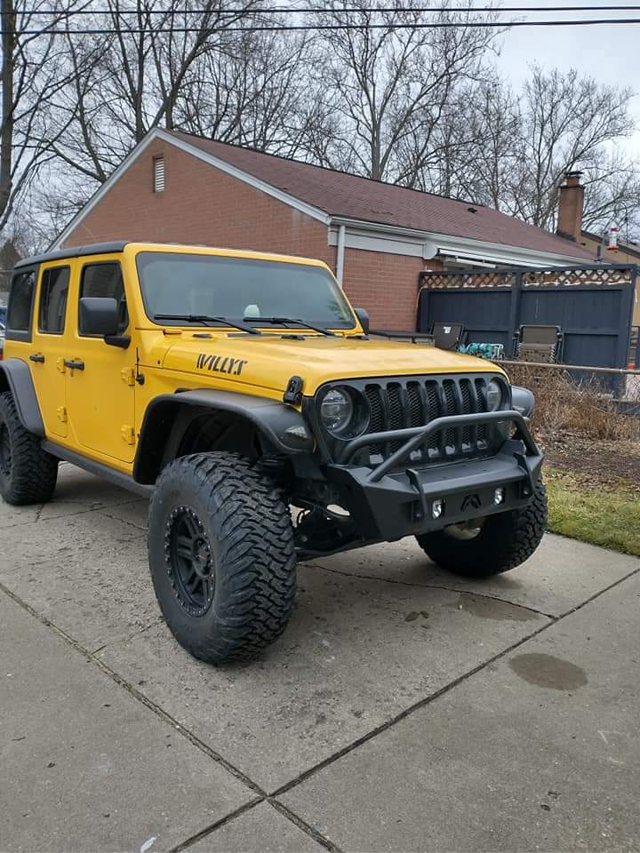

Here is our non rubi JL with aftermarket fenders and 1 3/4" front and 3/4" rear with 35x12.50s . It's all about the fenders .
