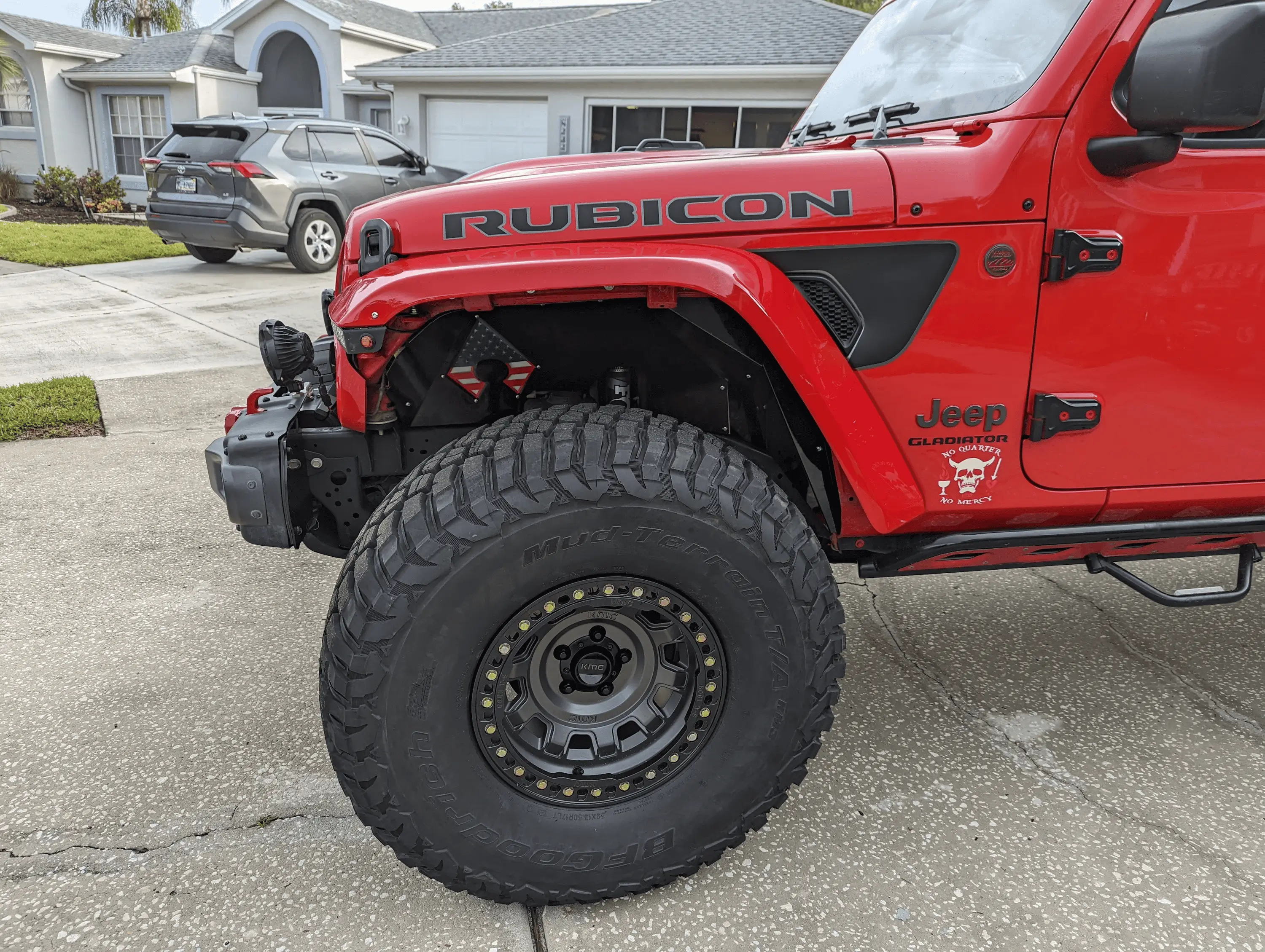

Have you thought about gutting the fenders? That gains you 3" with out having to raise up any higher. I moved to 39's from 37's and the fender chop really opened up the area despite only having the clayton 2.5 (really more like a 3-3.5).

I would consider gutting or adding flat fenders first if you’re happy with how it performs.
