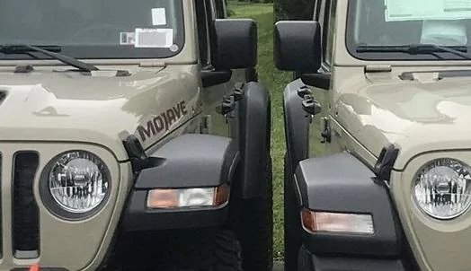

Mojave hood is not a swap, it is on a couple other threads, but you need Mojave side cowlings and also front cowling along vent. Mojave and Rubicon hoods both have nonfunctional hood scoops but can easily be modified to be functional.

You can see in this comparison. The area in front of the windshield hinge on the Mojave is flat going forward. On the Sport/Overland/Rubi it starts a bit lower and slopes downward going forward. Then on the side cowl piece in front of the a-pillar, again it is almost flat coming forward from the base of the windshield on the Mojave. On the Sport/Overland/Rubi it starts from a much lower point. These pieces would have to be swapped as well as the hood for the Mojave. (I believe this is the hood and setup they will use for the V8)
