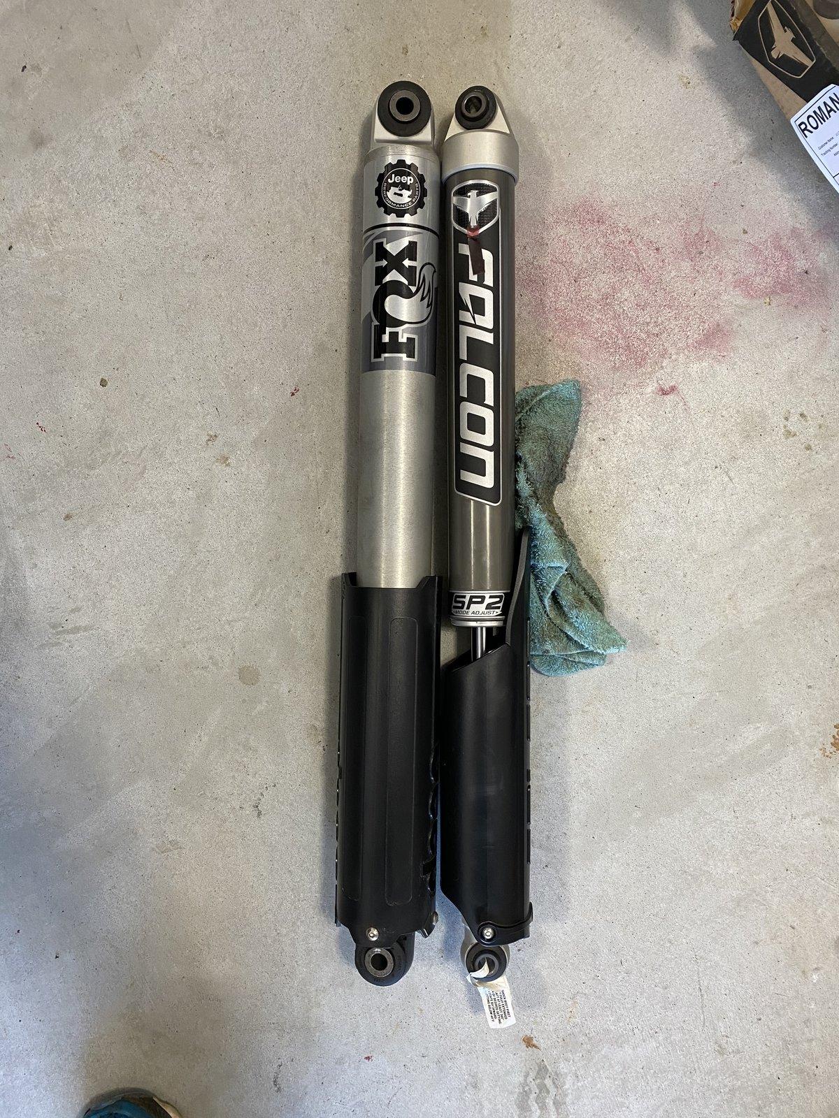

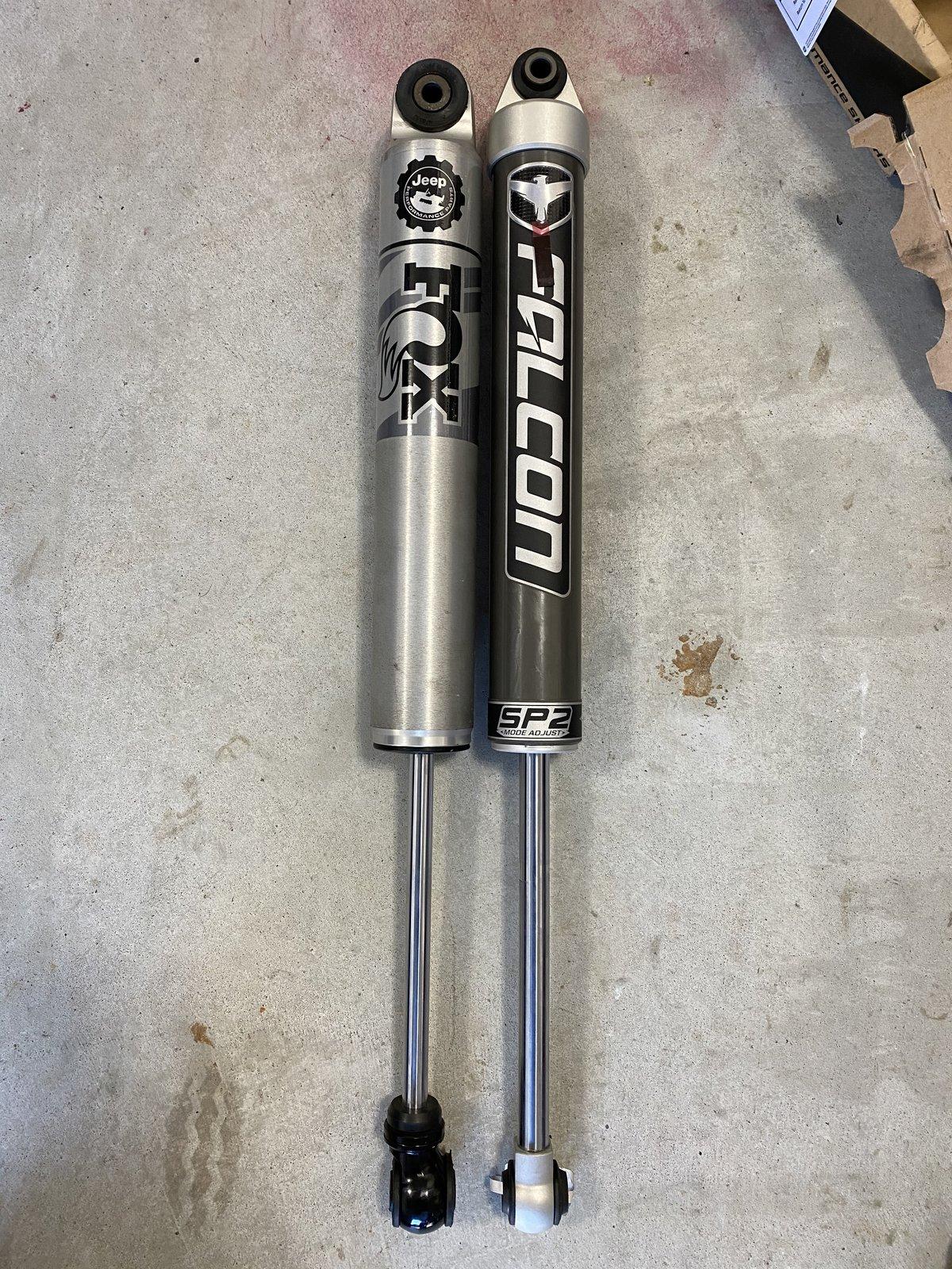

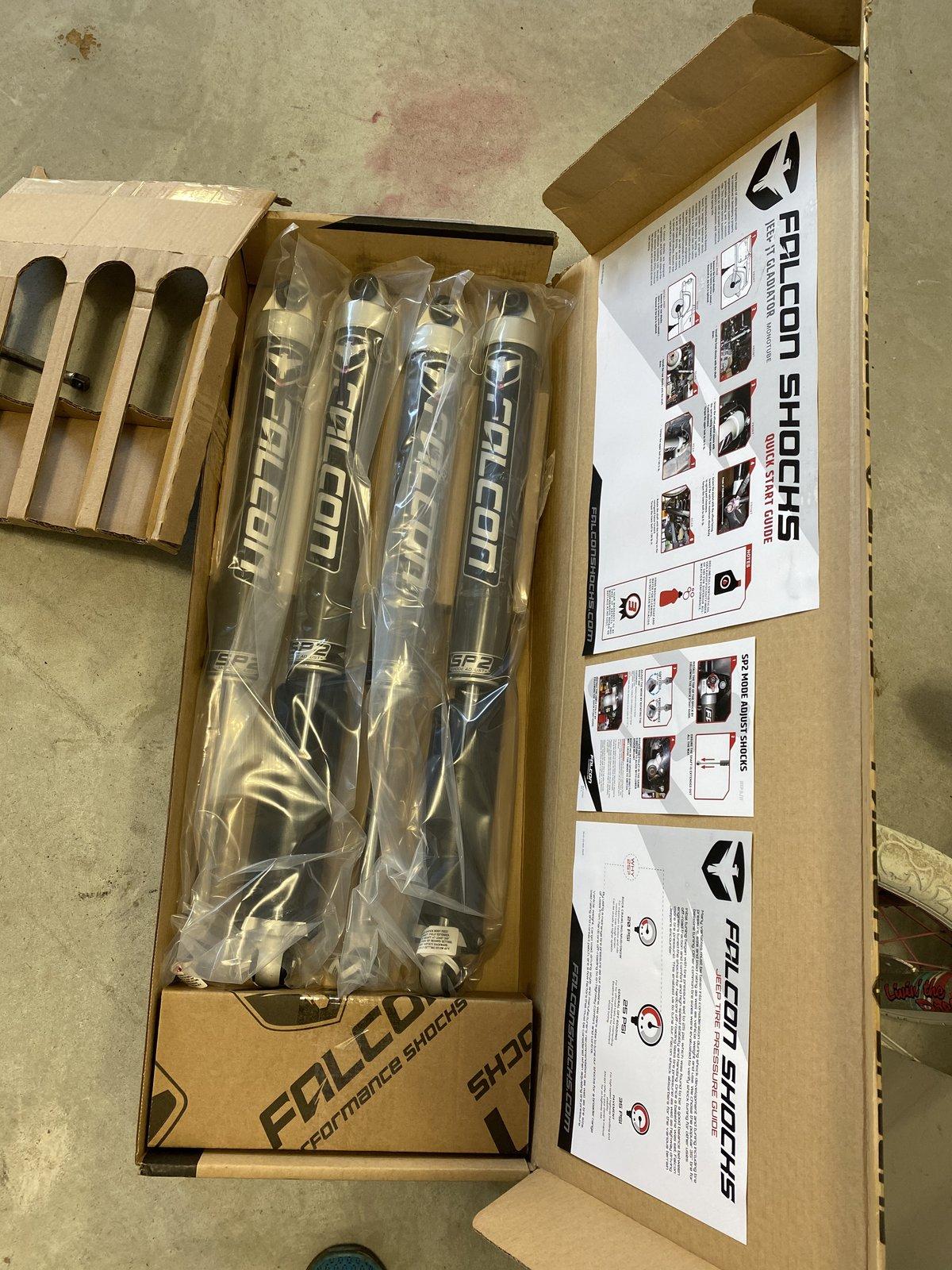

So I decided to switch out my Mopar Fox Shocks that came with my Lift kit over to the Falcon 2.1 SP2s just released for the JT by Teraflex. I have read a lot about how stiff the Falcons are compared to Fox or others but I always take others opinions into consideration but I like to formulate my own opinions.

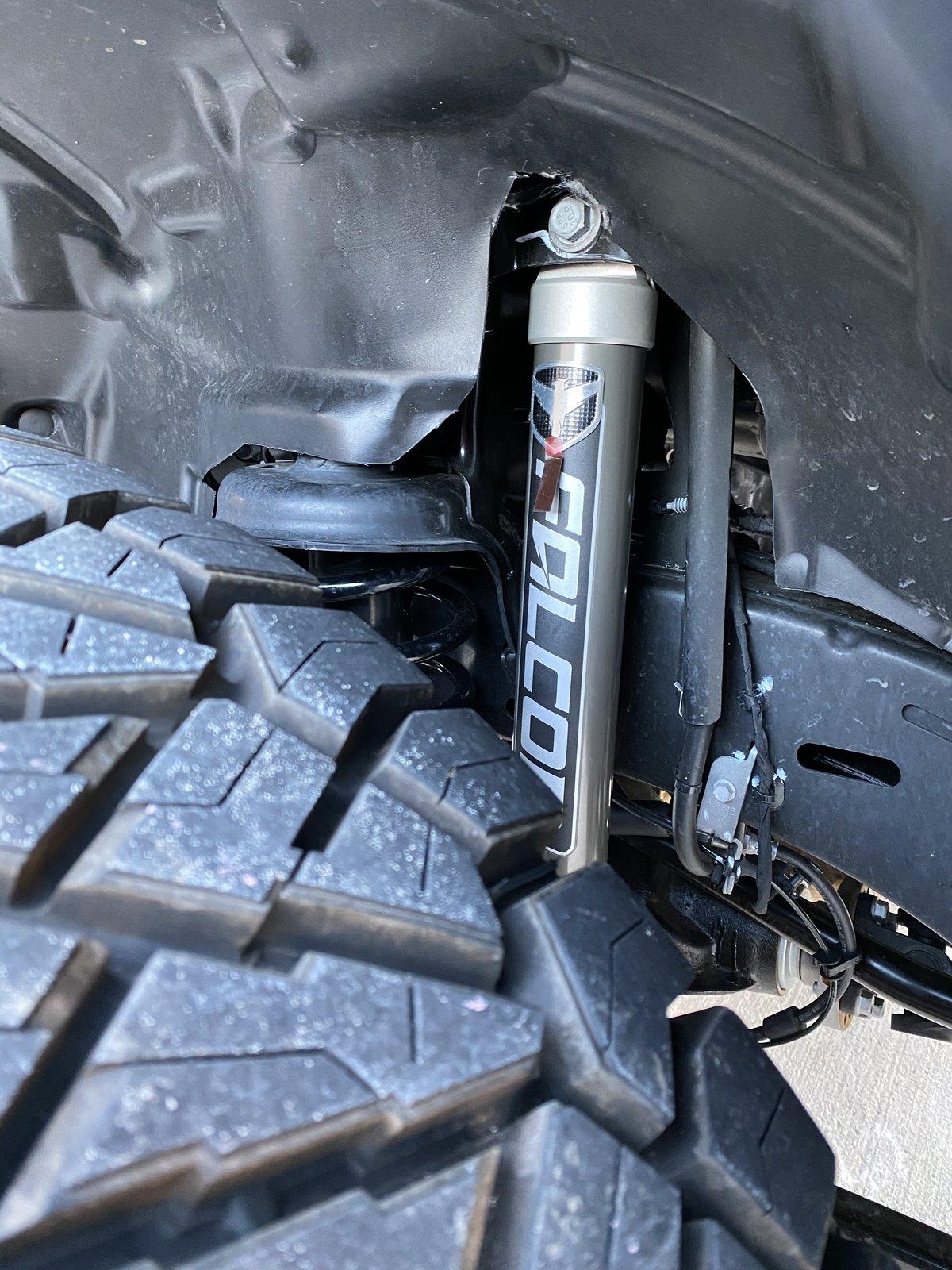

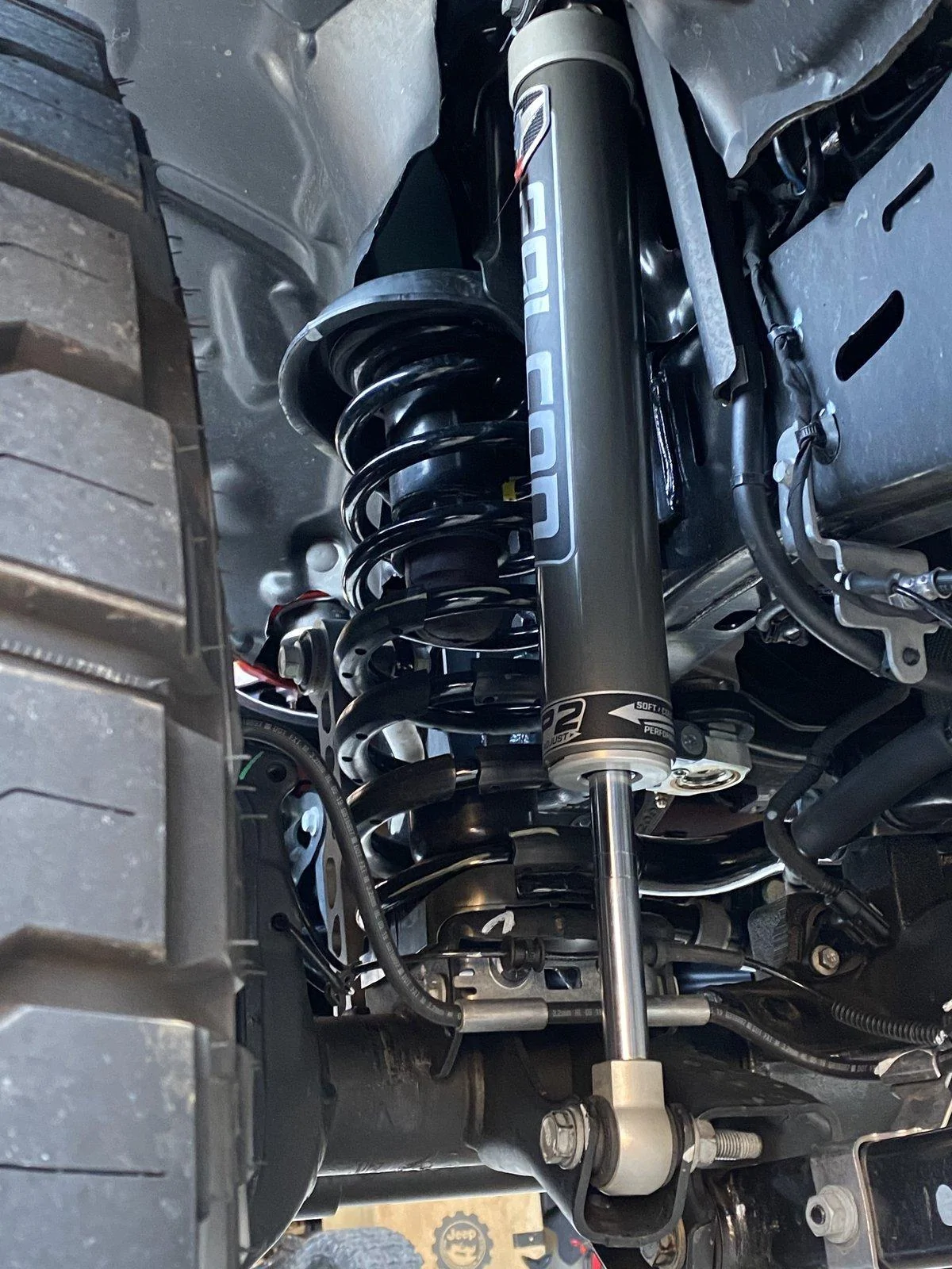

Install was super easy. Was done in about 30 to 45 mins in the drive way. I set all 4 SP2s to the Performance adjustment.
I drove around town for a few miles and the ride is great. Definitely different than the Fox 2.5s in the Mopar kit. I did a compression/rebound test before install on both the front and rear Fox/Falcons and the falcons would take a good 2 to 3 secs longer to come back up to full extensions (on the performance setting). The fox shocks would shoot right back up as soon as you let up the pressure.
Tomorrow I will get to try them out on my 60mile hwy commute. this is the ultimate test because its the majority of the time I drive the vehicle as its my daily driver. If I like it, I will sell the Fox shocks, if not I will have to figure out what to do with the Falcons. So far I highly doubt I will not like them.
Just sharing my .02cents on it. I love Fox as a company and their shocks are outstanding, I just wanted to try something different :)

How much stiffer are the Falcons than the Mopar 2” lift Fox, and are you able to compare the 2” lift Fox to the factory Rubicon Fox Shocks? I’m still on the Rubi Shocks with spacers and am curious about how the three sets compare. Thanks.
I should be able to after a few miles. I know so far I can very much tell they are stiffer but nowhere near in a bad way as some make the falcons out to be. Testing them outside of the vehicle by doing the compression rebound test was a clear visual proof of the difference.
As far as the 2” fox vs stock fox was pretty noticeable too. The rear end used to float and bounce so bad on stock fox that it felt borderline dangerous at high speeds. They were super soft. Softer than stock JL shocks actually. The mopar 2”lift fox are nicer but hard to explain exactly. Best I can say is they ride like stock but improved and the way the stock rubicon should have came with in terms of ride quality shock wise
I will follow up as best as I can. Hopefully I can provide more info for those who are interested in doing something similar have more info to make an educated purchase :)

Just to follow up again. I could not be happier with my Swap to the Falcon SP2! Jeep Drives so much better. The rear end doesn't feel like it wants to blow away on me on the Hwy and the ride is firm in a good way. No my bones aren't jarring or rattling away as some say the Falcons do to their jeeps. That is a major f'n exaggeration on their part. It has made a big difference on my daily commute and I would recommend these to anyone upgrading their stock stocks with zero lift or those who want to lift and pair them up with these shocks (be careful with spring rates tho, if you get them too stiff plus these shocks, I can see the ride becoming maybe a little to rigid)
