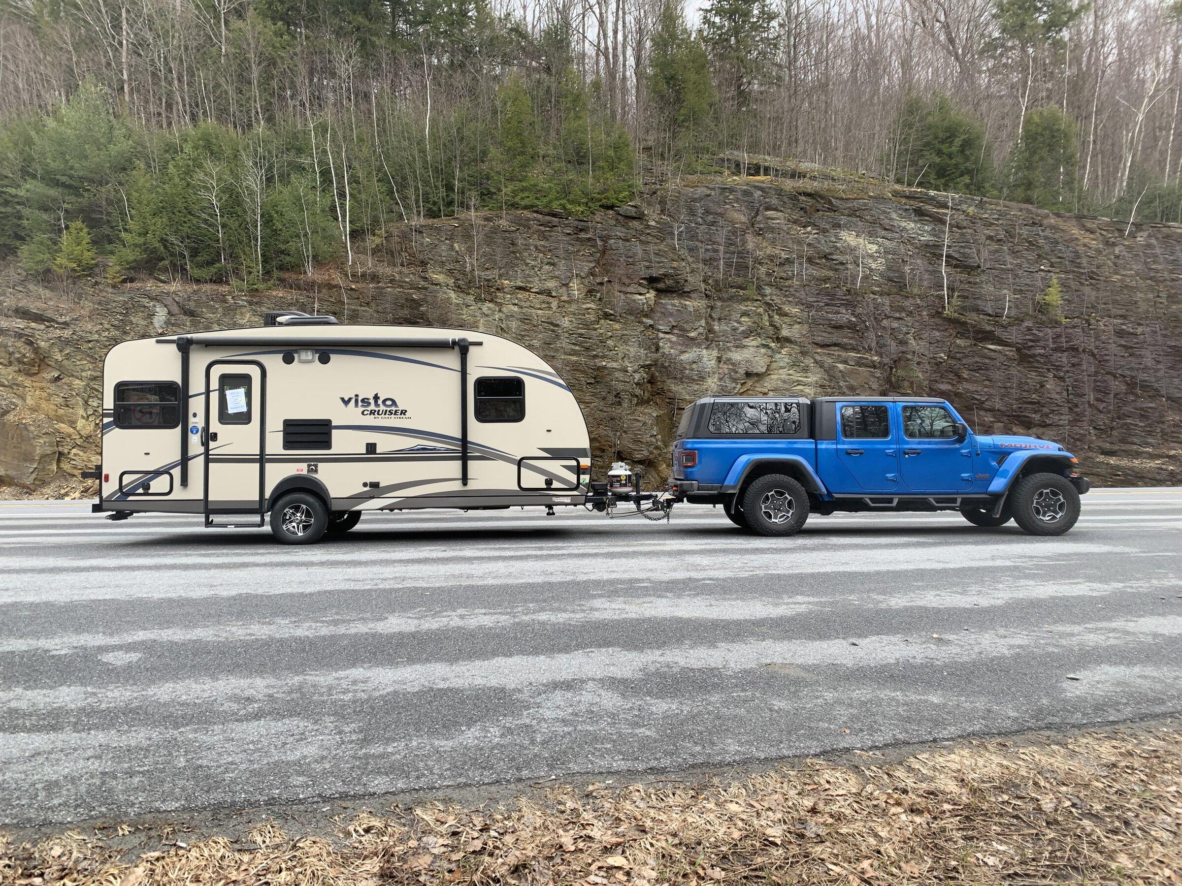

Electrical Manager
Absolutely, I have a 23’ long camper 3200lbs. Dry and 4100 GVW, used a Blue Ox combination WDH called Sway Pro worked great, talking to Blue Ox factory the bars have to be the right rating, I have 500lb. bars which I should not exceed, next step is 750pounds. Just towed it not set up perfectly for 6.5 hours tried some sway movements on empty straight highways and was very impressed. Whatever WDH someone has will be the best, so yup, mine is the best!…..Jack

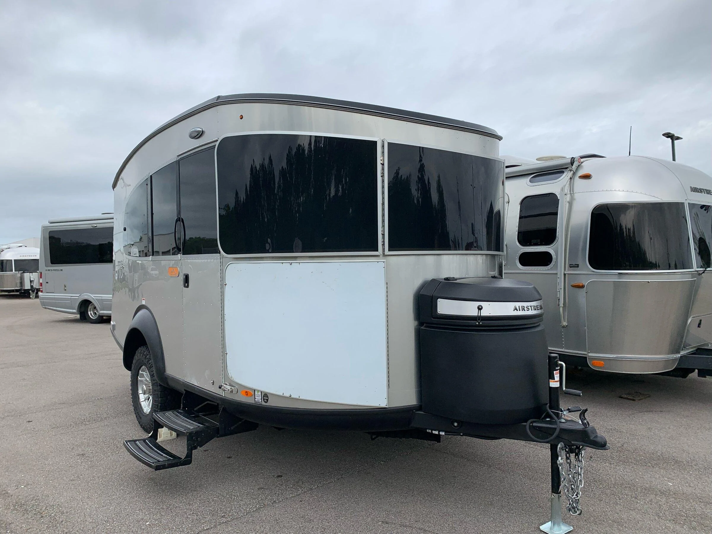

Here it is...
Jaxmax
Jack
Jun 28, 2020
1,906
2,709
Bally, Pa.
Electrical Manager
That is nice ,very aero, going to tow great, I would still do the WDH though. Enjoy the camper!.....Jack
