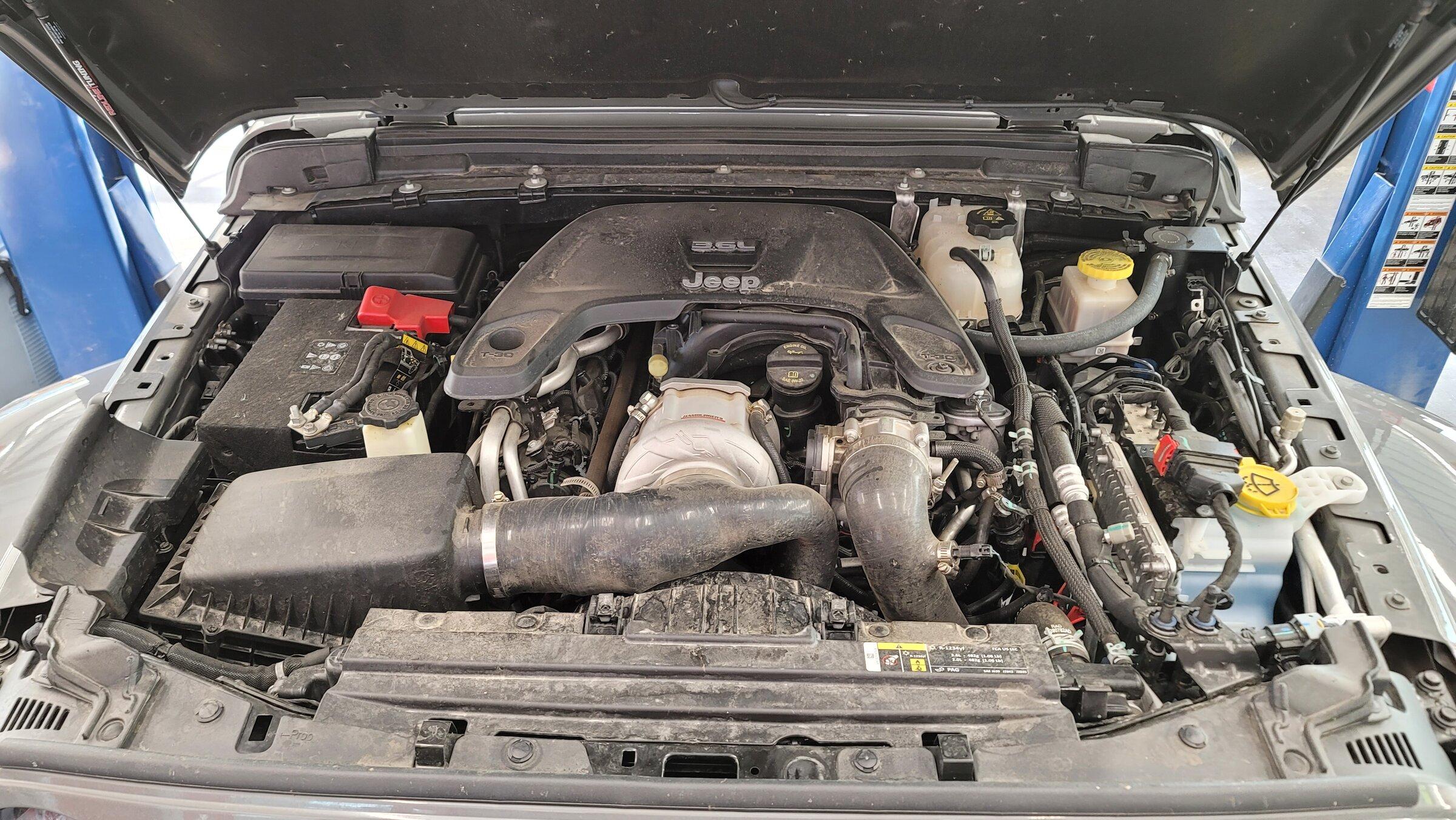

I hope this post doesn't pour gas on the fire, it is not the intention.
I have had my Gladiator for about a year and a half and supercharged most of that time. When I made the decision to go Hamburgers it was because of the driveability issues shared by owners of the Magnuson kit. Ever since the install I regretted not going with a PD supercharger. The Hamburger kit has been great for driveability and it screams up top but for my use, the torque profile is not ideal.
I recently contemplated a hemi swap but after reading @DAVECS1 posts and watching his progress, I decided to try the Magnuson. I get the kit in this week and will likely install in the next couple weeks.
I'll share my unbiased feedback of both kits from install to daily driving. My intent is not to put the two kits against each other but to help others make informed decisions for their use case.
I'll be selling my Hamburger kit once I get the swap complete for those who may be interested.

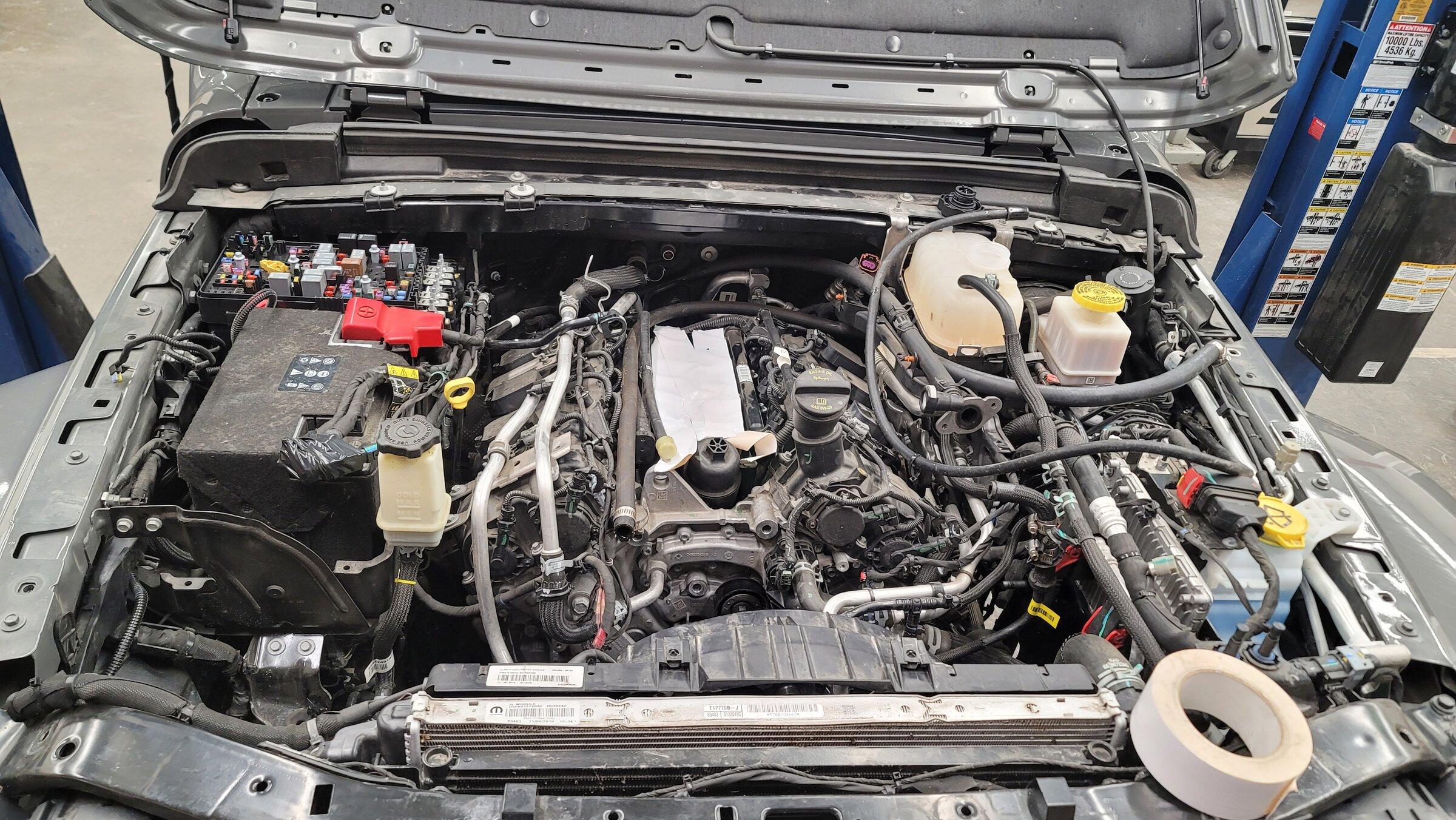

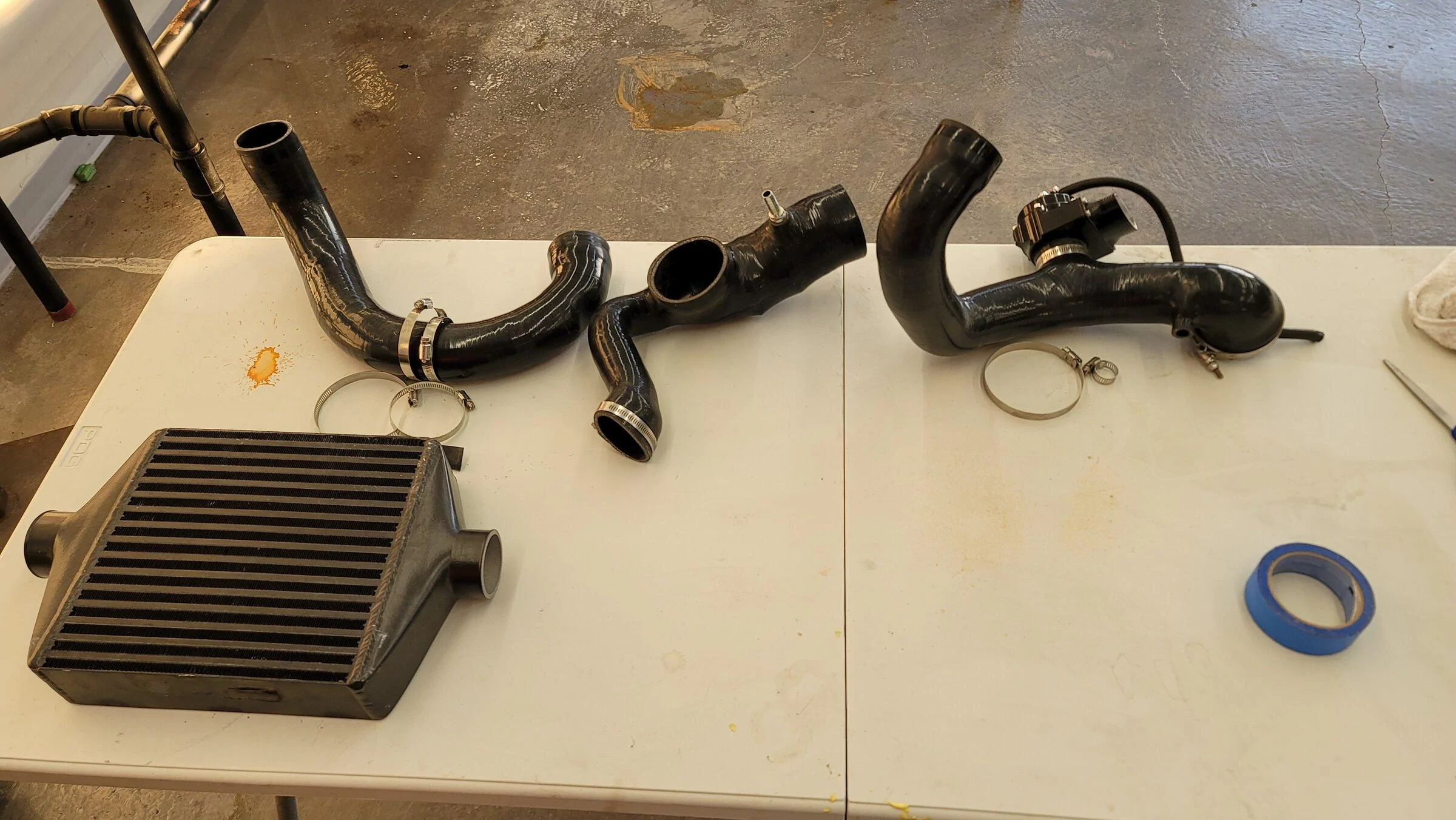

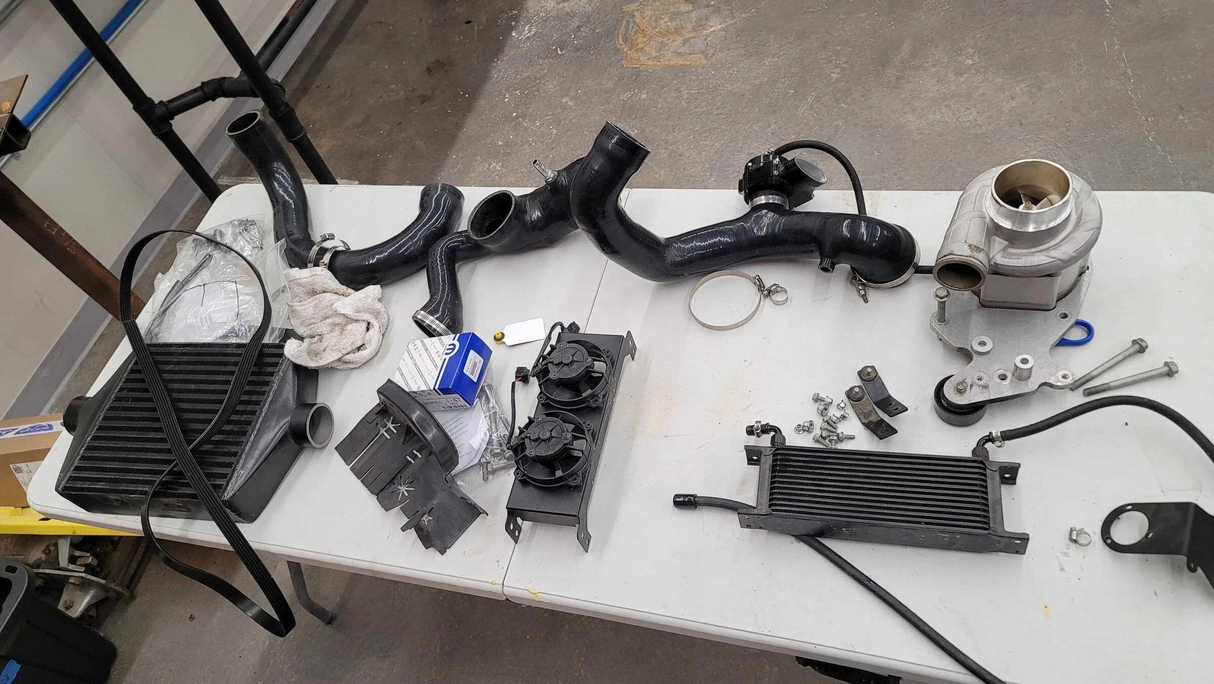

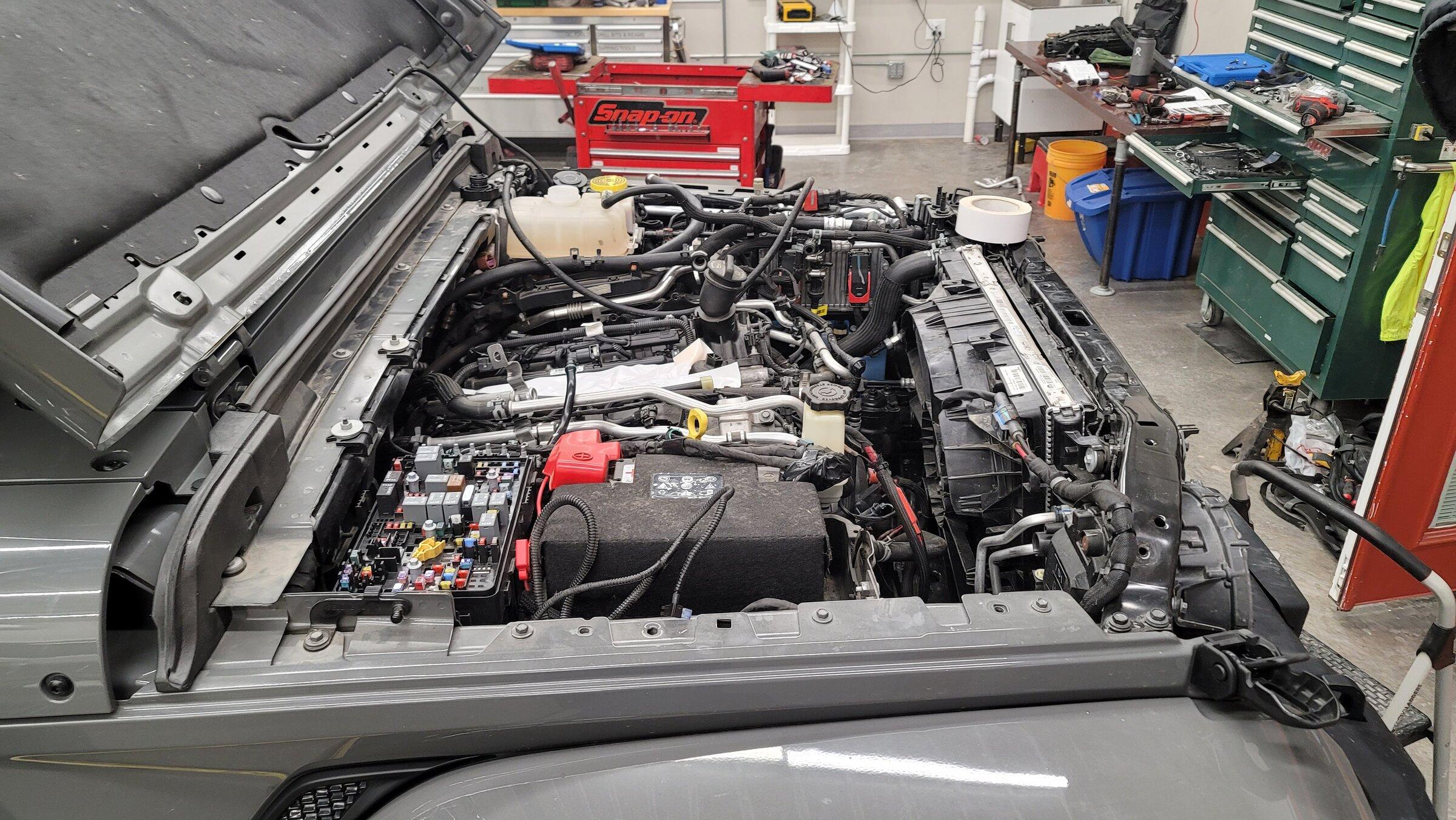

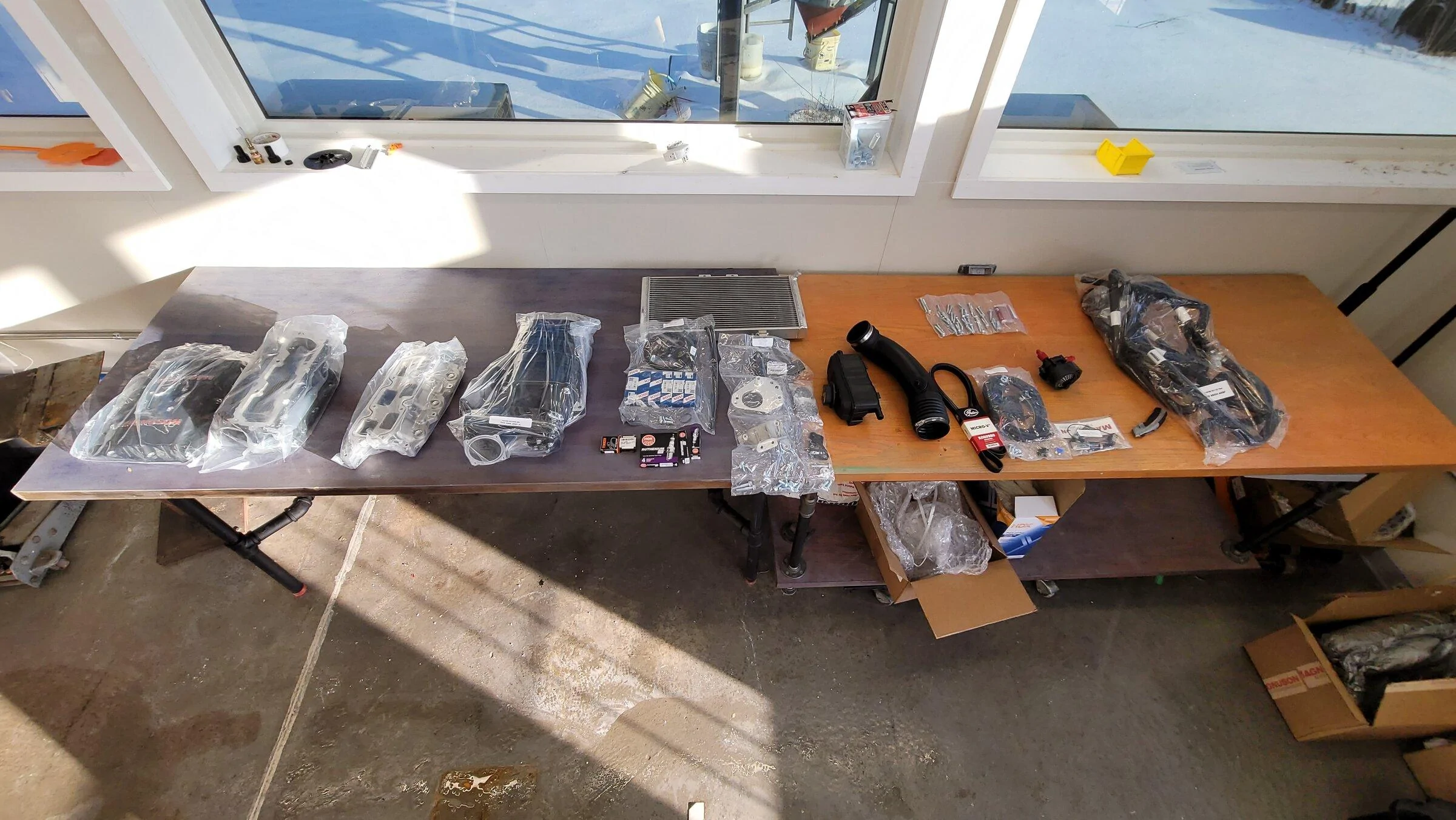

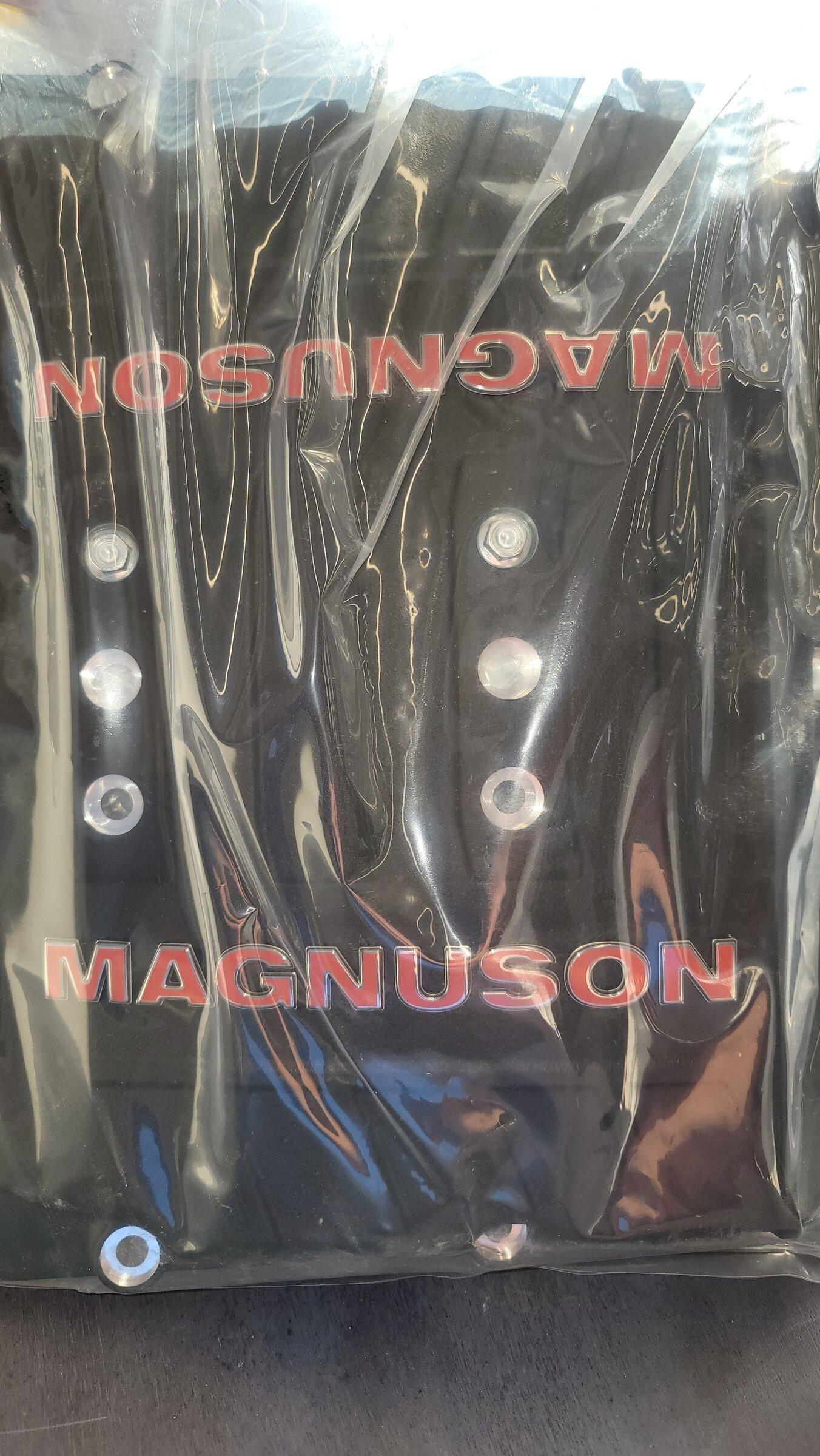

The process begins! I am really impressed with the Magnuson kit, packaging and professional wiring and hoses! I hope to get the existing kit off today and Maggie installed tomorrow. :jk:

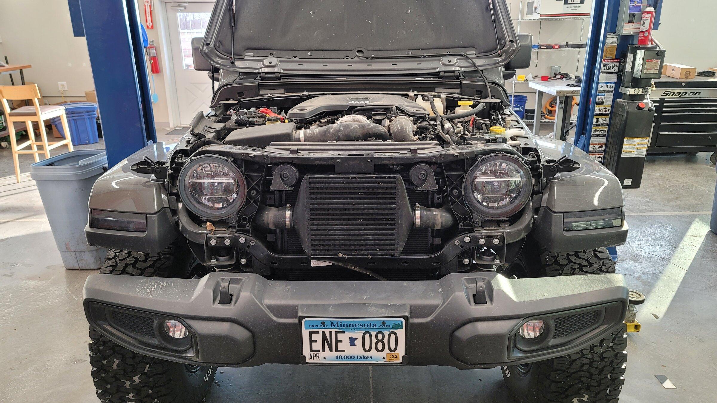

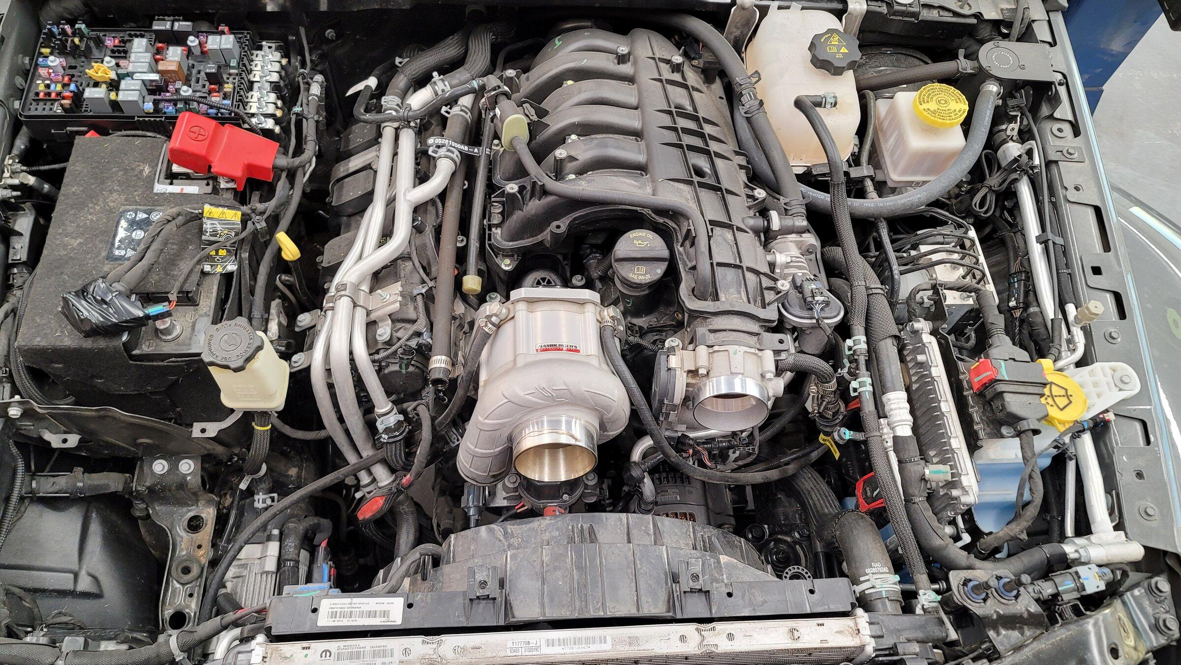

I made some progress today. On track to finish tomorrow unless something pops up. I give the Magnuson instructions :like::like::like:. I'm glad I removed the FMIC, I was probably only 5k miles from wearing through the AC condenser. A cautionary tale for anyone who puts a heat exchanger in front of the condenser... be careful!
