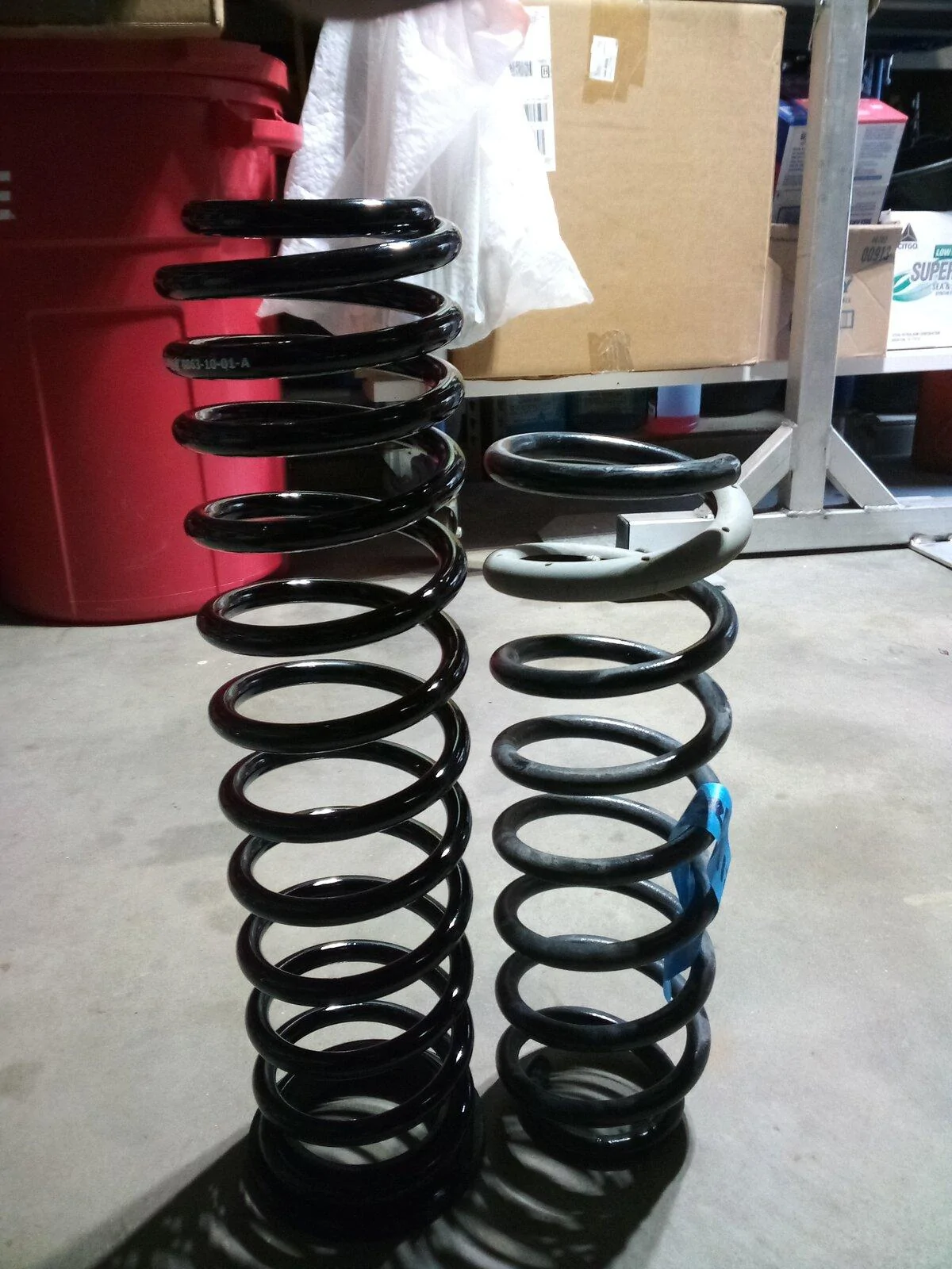

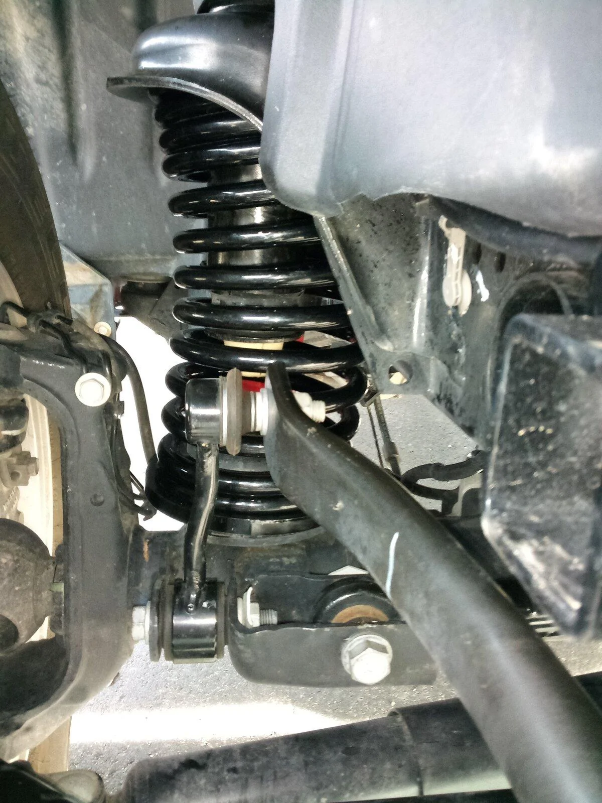

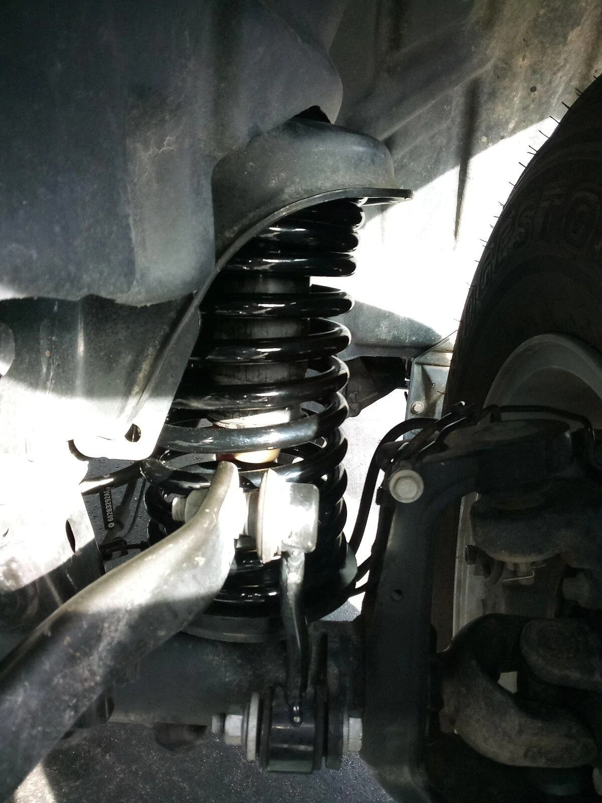

I wanted a one inch lift contacted them told me that's what I'd get , also they state there springs don't bow
Installed quite surprised with the difference in height from the OEM spring at 17 in to the synergy spring at 21 1/2 yet only got a Net height increase 1/2" & Bowing springs
Contacted was told " never seen that with our springs " didn't offer a resolution to correct .
Took them off and installed a teraflex 1" spacer , got a 1" lift
With the interaction I had with synergy I wouldn't recommend their springs , my thought was to install a spring rather than a spacer get a little bit better of a product but not the case

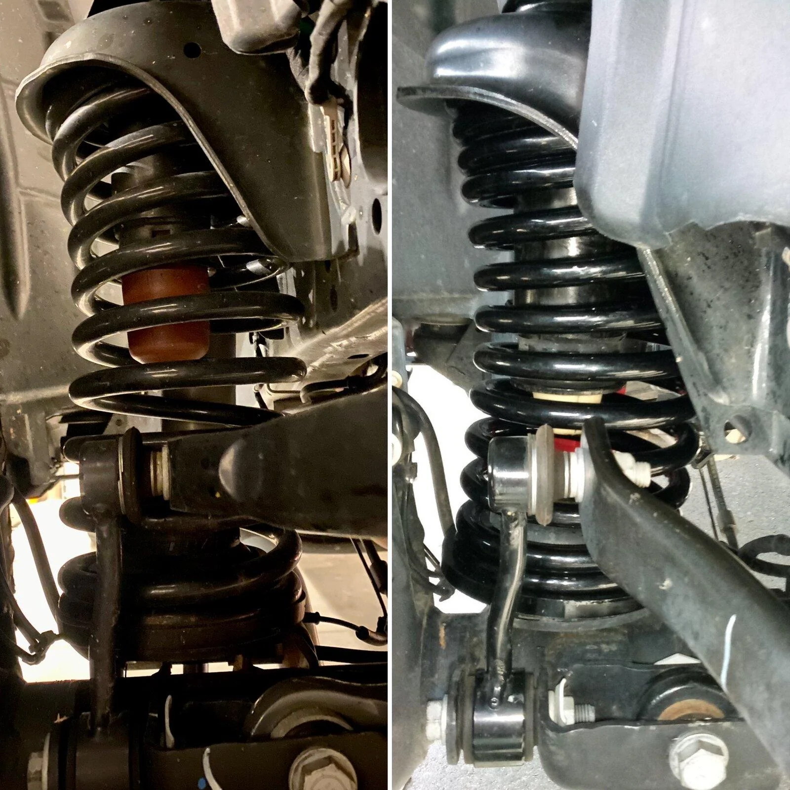

do you have an adjustable track bar? What are you running on the front? I’m running a full width ARB and 10k Warn. My spring is on the left and yours on the right. I have little to no bow. Synergy is essentially the same spring rate as factory rubicon springs. They have an insane amount of range. I netted 1-1.5” and with a hard top, arb, warn, and Eezi Awn rack.
I have zero complaints and their stuff is made in the USA.

Glad your happy with them , find it odd the spacing between your coils & mine as
Mines a Willy's sport diesel soft top , with added factory steel oem bumper , Grimm winch plate & a sx 12k rope winch, plus my plow brackets
& No adjustable track bar ( if a spring co requires it they should mention , as it adds cost)
Thanks for the information

Ding ding ding…. The issue is you’re diesel which is heavier and heck even the factory springs are bottoming out on the bump stops bone stock.
Gohan2374
Paul
Feb 18, 2021
69
49
Michigan
2017 titan xd, ordered 2021 gladiator
Maybe you miss this I contact of them before I bought these by email to confirm that they would work with my diesel gladiator netting a 1" lift = Yes
I haven't had a problem with my factory springs bottoming out
