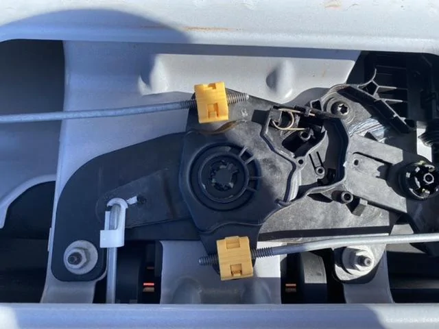

Found the culprit. The mechanism was popping up allowing the plastic part to slide of the locking and unlocking mechanism. I used a t25 to take the long panel off the tailgate. Then I tightened the rods and it appears to have worked. Driveway testing only. Will see how it works later today as I drive it.

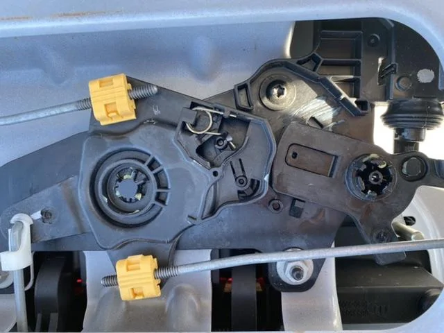

Hi folks. I ran into this issue with my 2020 Jeep Gladiator JT Rubicon. Truck bed was inconsistent in locking. Worst case, pulling the locked truck bed door handle could be pulled a few times and would open eventually.
Opening the door panel, the locking mechanism was not seated properly and needed to be snapped back in place (As previous poster mentioned). Hereā€™s a video of the issue and how I fixed it.
Thanks for the post. Had the same issue.
