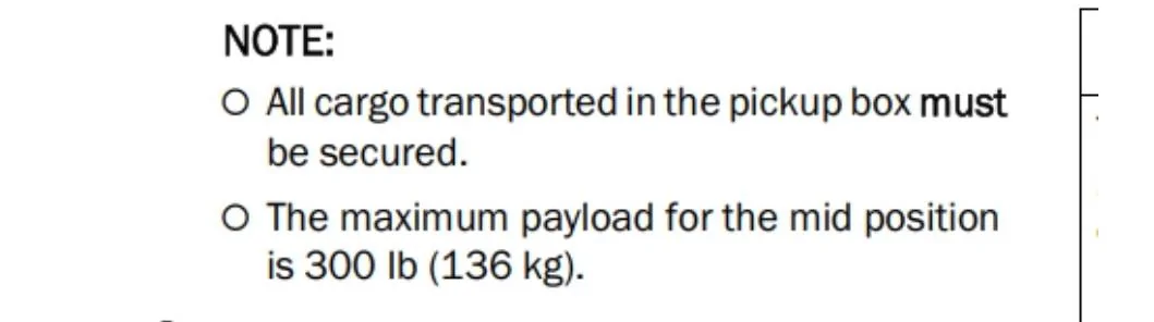

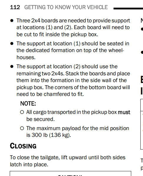

I suppose the point is moot at this point........... but 500 is incorrect -
Jeep Gladiator Tailgate weight capacity/ Halfway down 1679533525054

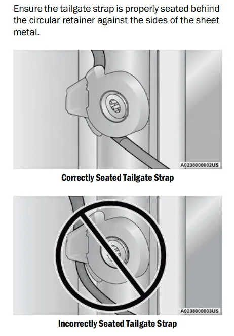

And if properly secured, they shouldn't break. Common mistake is not forcing the cable into the proper position. It takes some effort to force it hard against the side of the tailgate opening -
Jeep Gladiator Tailgate weight capacity/ Halfway down 1679533603154
Properly loaded, I can't see most loads being that much weight on the tailgate alone. Supported at 3 points (both 2x4s and the tailgate) the weight would be distributed among all 3 support points.
Tailgate flat, I can't see ever hitting 500 pounds! Most weight will be on the floor of the bed.
At half-open, much of the weight should be on the 2x4s setup in the bed and on the wheel wells to support 2/3 of the weight.
How did you end up with that much weight just on the tailgate?
It would mean half the load hanging out the back.
Says right there that it's 300 not 500 pounds.

My fear is the cables bent in that manor and not that plastic brackets are the real limit.
If you are braking the brackets you are either doing it wrong (cables not routed correctly) or overloading it.

It's the fact that too many shove the cable behind those half-way points and don't get them shoved hard against the inner-most part. It takes some force - at least on my 2022 - to get those cables back into the strongest areas as shown in the book.
Have only 2 of us ever looked at the book? Guess not since the internet experts say it's 500 pounds, contradicting the book's 300 pounds.
Steel cable at the radius these are subjected to by using the tailgate half-way down point isn't a huge deal. You still have plenty of capacity even if it's reduced a bit from that ~1,000 pounds each cable. Knock it down to 750 pounds each due to the radius, if that's even necessary (where's our engineers!) and you still have 1500 pounds between the two.
Tailgate full down - don't sweat the cables.
But you have the weight spread about, not concentrated, in any case.
That 1,000 pounds of 2x4s isn't all on the tailgate if you load the truck properly.
