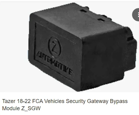

Im using the extension cables with a Tazer Lite, so I have to pull the dash panel and reinstall the cables to the gateway everything....PIA. Isnt there a bypass that you can use to take the Tazer out and put into another little black box to reconnect the gateway service, and let the OBD port work again
mrmo
Mrmo
Jan 26, 2021
51
819
501
East Tn
2022 Gladiator
nuke
Im talking about this, unplug the Tazer, install this, and then the OBD port is good. Just connect the extension cables and shove em up inside the panel, and when done, reverse the steps.
