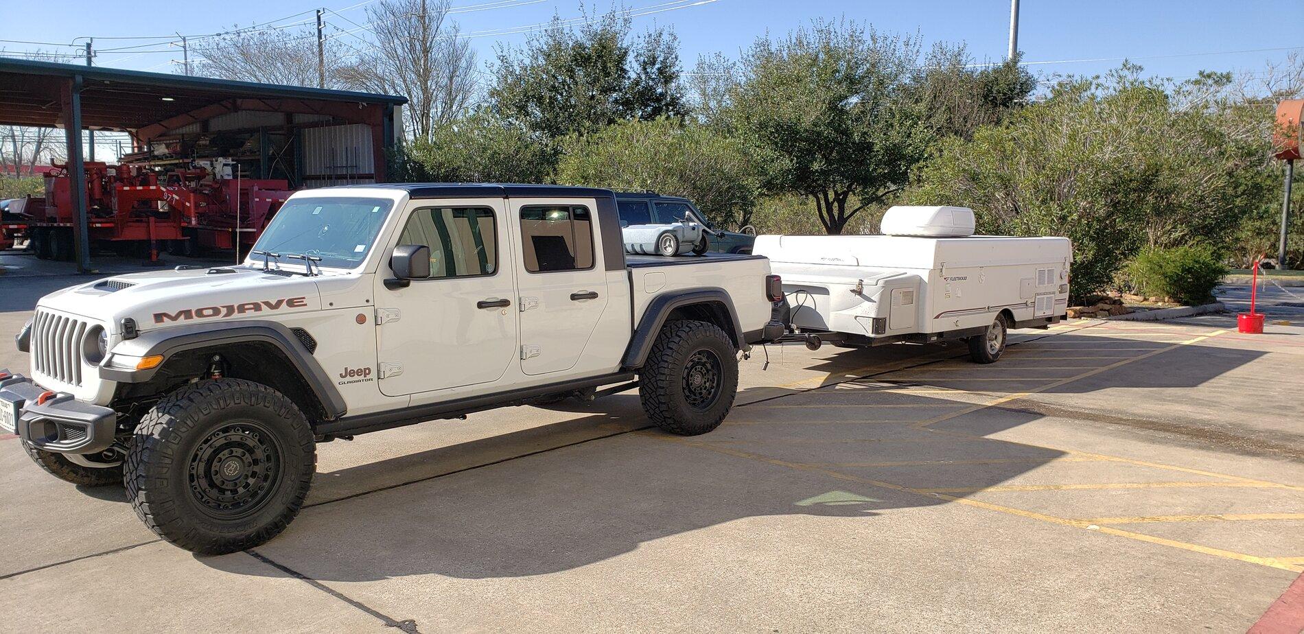

I need some quick advise! Here's a time line of events leading up to the current situation:
Bought a new pop up camper yesterday and left the trailer light connection hooked up over night. Came out this morning and the truck was deader than a door nail.
Jumped the truck off:
The "service start/stop system" display came up along with the @! symbol.
This was affecting my uconnect as well not letting me set the ac to any specific temp just taking it from whatever temp straight to hi or low.
Tried letting it run for a while, then tried disconnecting the battery hoping for some sort of reset (was reading 14.x volts at the time before the battery disconnect).
Some genius at work said you have to touch the positive and negative leads together to completely clear the computer.
As soon as he did that and I saw the spark between the leads I told him that was a BAD idea as there was a secondary battery (for the start/stop system) still active on those leads.
This is where the fun began.
Now I'm reading 11.x volts, the battery light is on as well and I'm getting the message that the vehicle will be shutting itself down soon.
I take the pop-up camper attached and park it in a safe place at the shop, then as I'm pulling away from it to park the truck next to the shop, it starts to die.
I threw the truck into neutral to coast to a stop, then put it in park.
When I hit the start button to turn the truck off, the display was telling me that the vehicle was still in gear (it was not). Couldn't turn it off (engine wasn't running, but the ignition was in the "run" position). Front windows down, Tazer still installed and married, and my only recourse that I can think of is take it to the dealership.
At this point, I can remove the Tazer but can not un-marry it. What the heck do I do now?

Could you have shorted out the battery or a cell in the battery?
Iā€™d take the battery out and get it tested.
Iā€™ve seen electrical systems get real funny when a battery has issues.
I donā€™t know much about the second start/stop battery in these things, but it could also have an issue.

Just take the module off if you can't unmarry it and don't mention anything if they ask if you did anything just say no I really doubt they will even know you did anything with a Tazer

all modern car do stupid shit( really cazy behaviors) when battery is low charge or going bad.. charge battery over night, should fix your issues

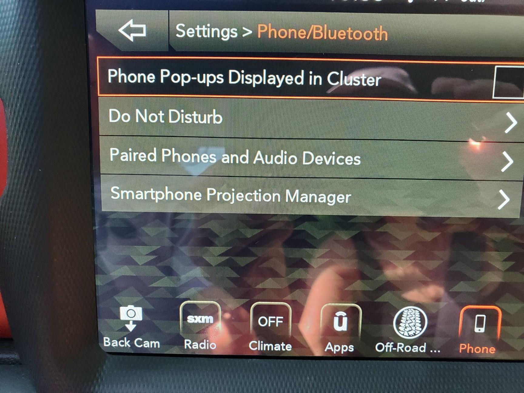

Right - the dealer stuff leaves NO TRACES, especially not in the uconnect. It's not bluetooth to the radio. And other updates can be done via USB........ it's not fun but the consumer can do radio updates via a USB drive (4 gig I believe is recommended)
I've unpaired my phone twice and still to this day uconnect doesn't deal with new text messages. It will if I unpair and reconnect or turn my phone's bluetooth off and back on while in the truck, otherwise the truck doesn't like to do my phone's texts. I even talked to the dealer - they cleared everything and re-paired my phone. It worked while I was there then the next day my wife texted me while I was out with my truck - she wanted some grocery items - it didn't come through.
So I've just resigned myself to the fact uconnect and my LG phone will never work together for texts. My wife's GC - works perfectly every single time. She has an identical phone.
180
29,411
34,977
@ShadowsPapa
To my knowledge, only, the 8.4 can be updated using a thumb drive..
My guess is that your issue with your LG is that your LG(s) is a dinosaur of sorts... Move to a newer Smartphone for a better experience lets say with the JT's, UCONNECT... 8-)
LOL - it's only about 2 years old, it was only a year old when I got the truck.
When I got it, it was the highest rated phone on the android market (best camera for sure)
My wife and I both get new phones roughly every 2 to 2.5 years. We get identical phones to keep it simple. We also keep the OS and apps updated. My truck is the only thing that has a problem with it.
My wife's Grand Cherokees have always worked with BOTH of our phones.
This is the first Jeep that's ever had problems like that.
Even my hearing aids, OBD apps and so on work fine with that phone. I can be OUTSIDE with my phone in the house and catch calls through my hearing aids - and even hear the alert that a text has come through. So if they work - and my wife's Jeeps work, why not the JT?
So why does a 2018 and a 2021 Grand Cherokee work flawlessly with both of our phones (phones are identical) and the JT not? Sounds more like a JT issue to me.
