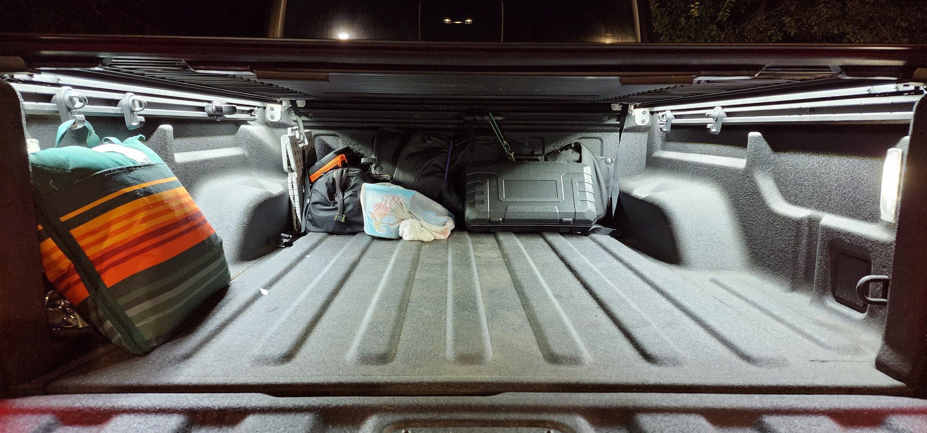

Yep, I use the unlock button x3 all the time with Tazer so that the light stays on long enough to be usable. Wired in some LED light strips to the bed lighting circuit and it's wonderful for loading up and looking for stuff under the tonneau cover
