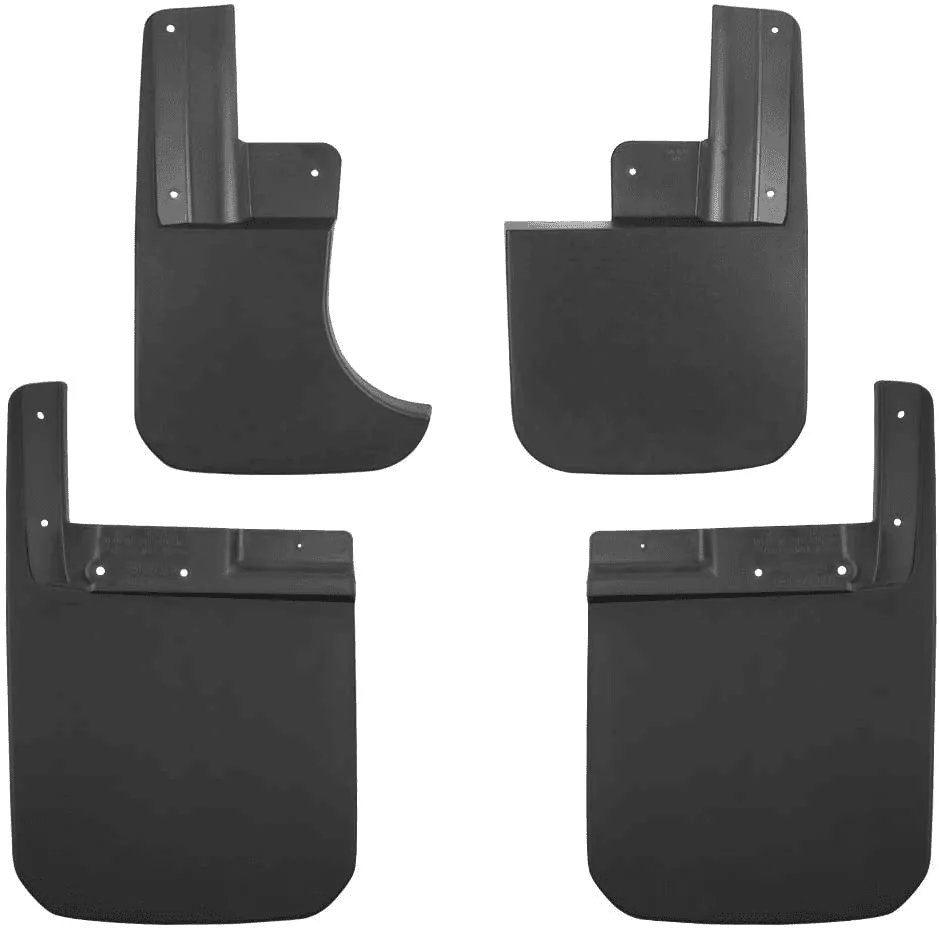

Special thanks to @AC_1960 for turning me on to these mudflaps.
  • They look factory, no dumb logos
  • big but not too big
  • $47, Amazon Prime
  • easy install

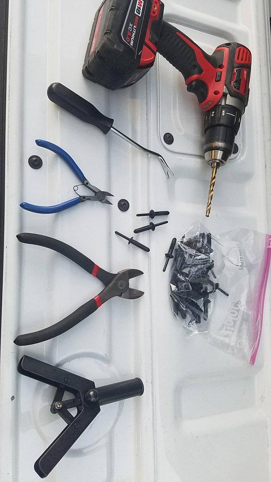

Total Cost - $94 but you get mudflaps, small side cuts, a plastic rivet tool and 34 spare 1/4" plastic rivets, 2 door panel pry tools
1/4" drillbit
large side cuts to remove the xmas tree thingies
Parts: Mudflaps $47
https://www.amazon.com/gp/product/B081CF7DKM/ref=ppx_yo_dt_b_search_asin_title?ie=UTF8&psc=1

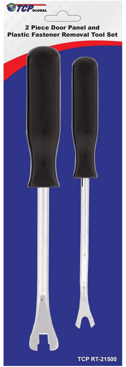

Door Panel Pry tools $9
https://www.amazon.com/gp/product/B01LWCORV4/ref=ppx_yo_dt_b_search_asin_title?ie=UTF8&psc=1
Jeep Gladiator Teccom Mud Flaps Install 1591237041772

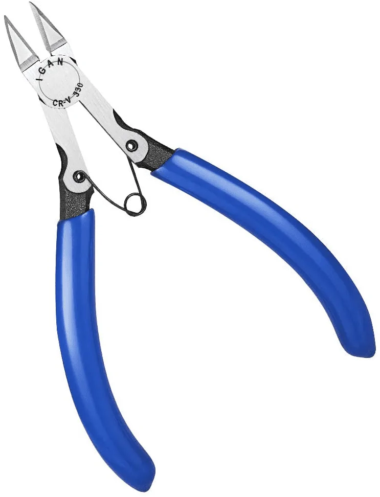

Small Wire Cutters $7
https://www.amazon.com/gp/product/B07RW8VTSX/ref=ppx_yo_dt_b_asin_title_o03_s00?ie=UTF8&psc=1
Jeep Gladiator Teccom Mud Flaps Install 1591235491980
Plastic Rivet Tool $20
https://www.amazon.com/gp/product/B007QV2E50/ref=ppx_yo_dt_b_search_asin_title?ie=UTF8&psc=1

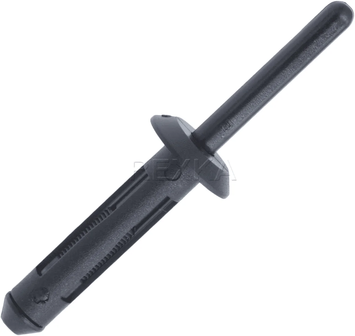

50 1/4" "Chrysler" plastic rivets $11 - Not sure what makes them Chrysler
https://www.amazon.com/gp/product/B07D6JXC4Q/ref=ppx_od_dt_b_asin_title_s00?ie=UTF8&psc=1

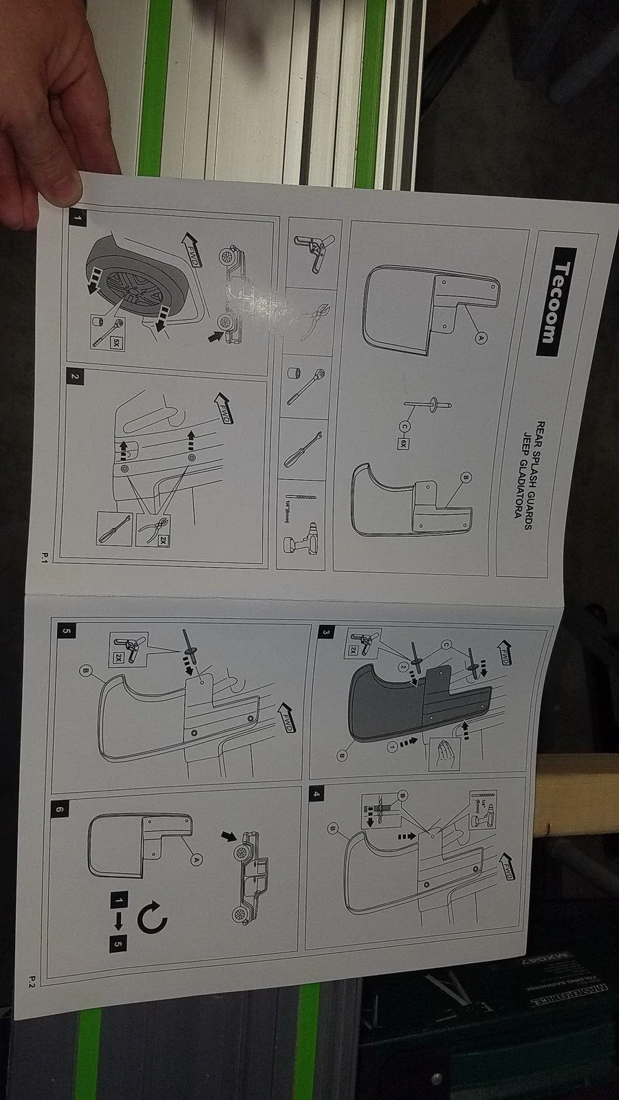

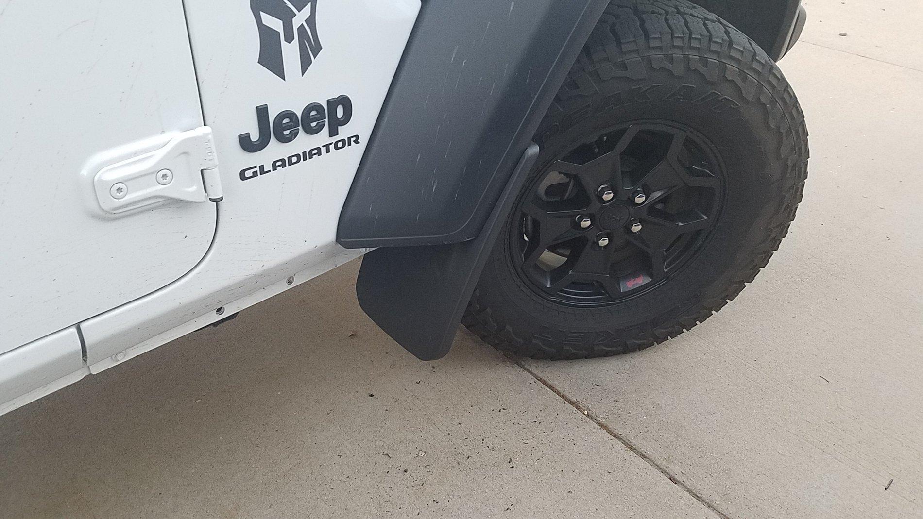

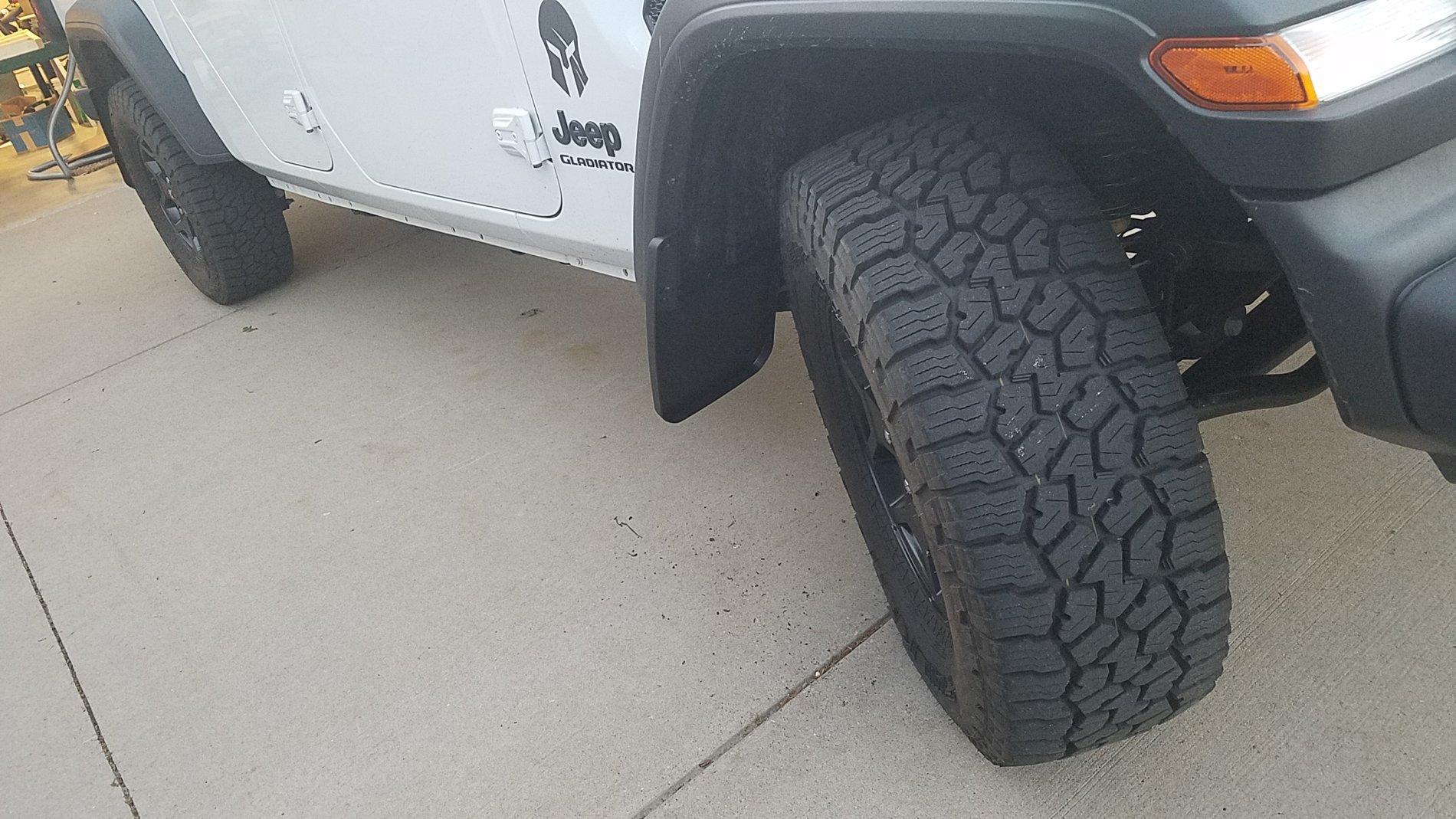

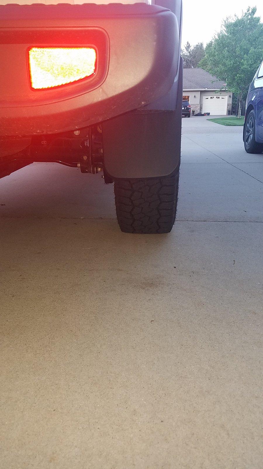

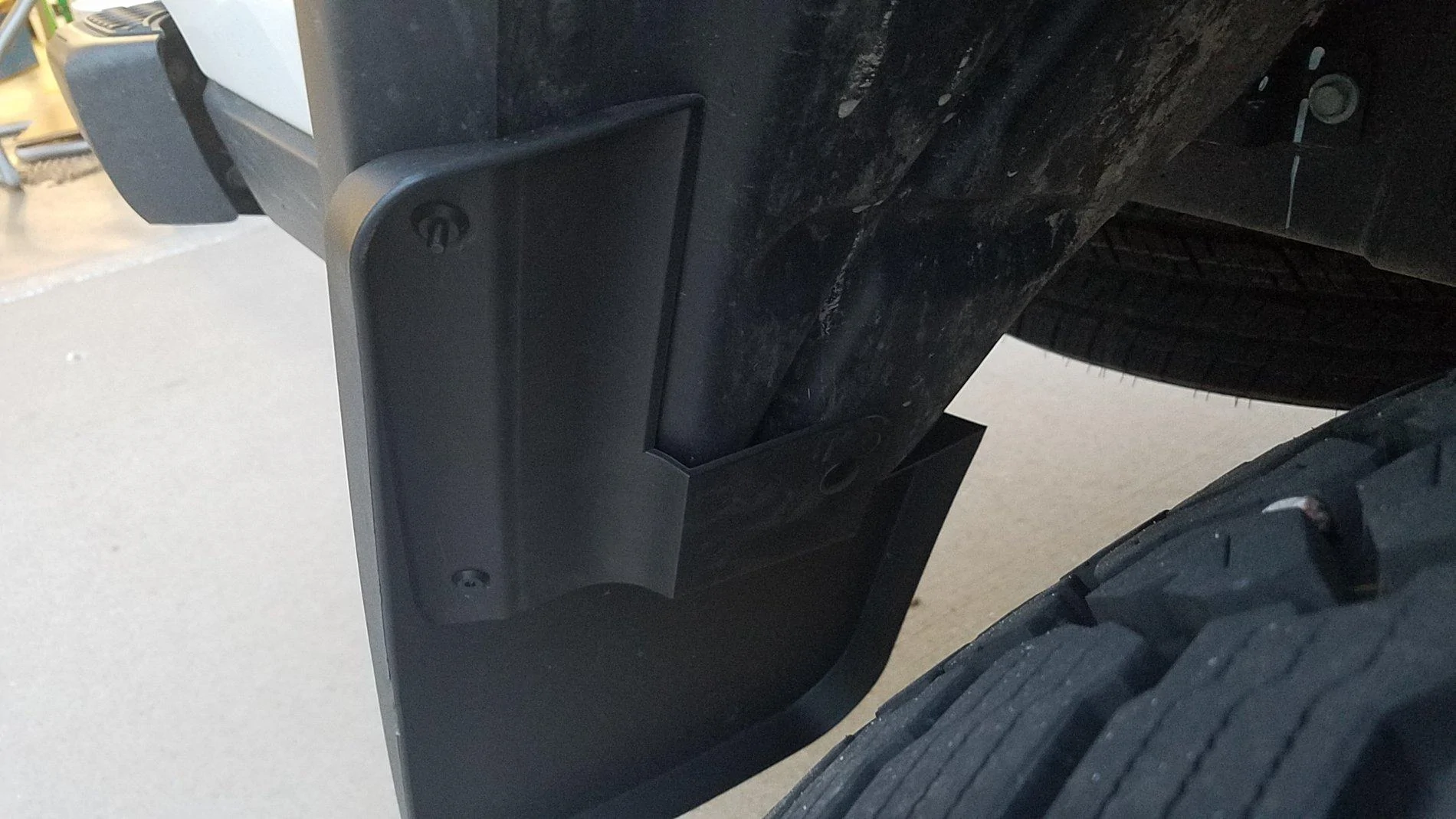

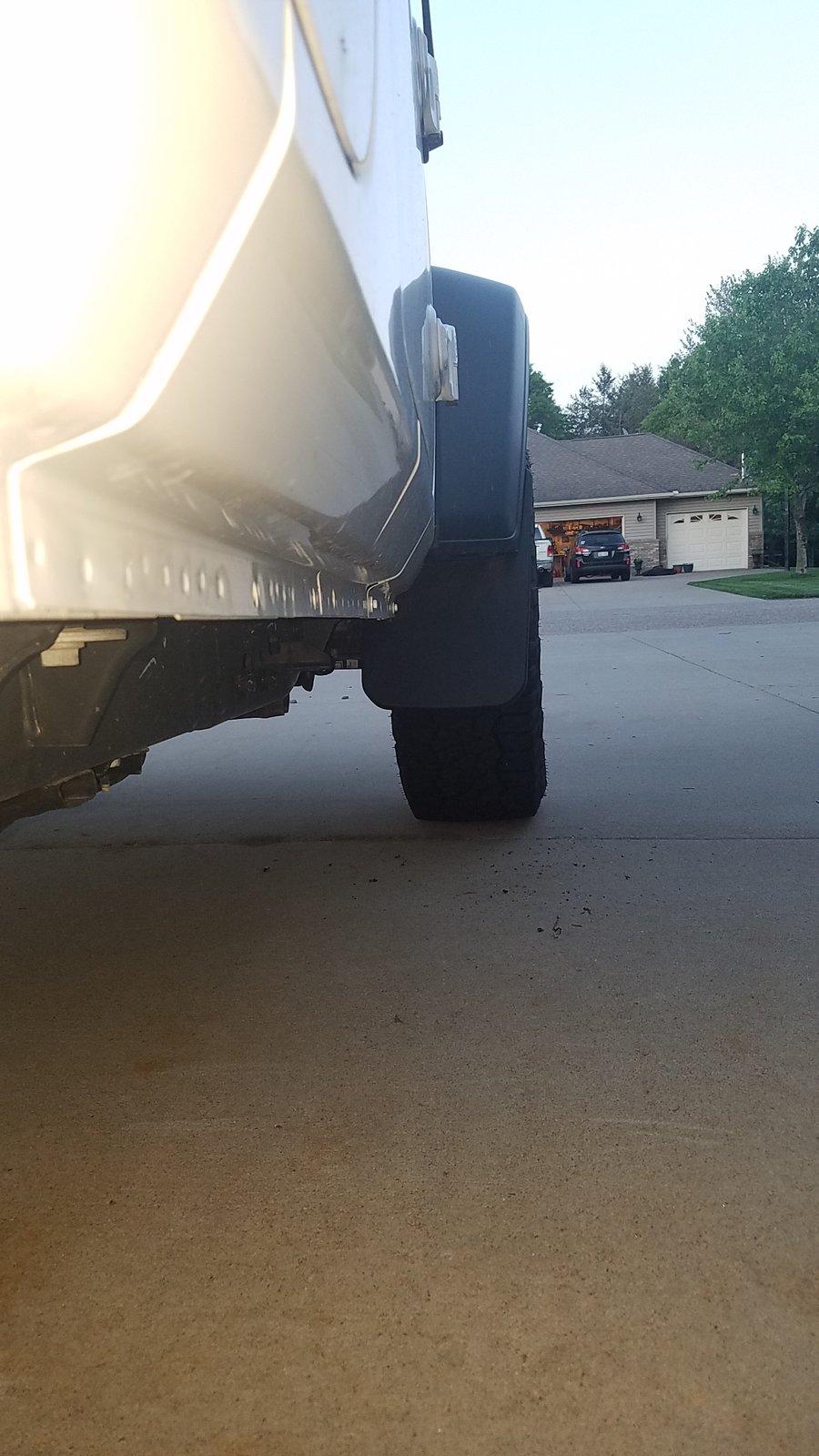

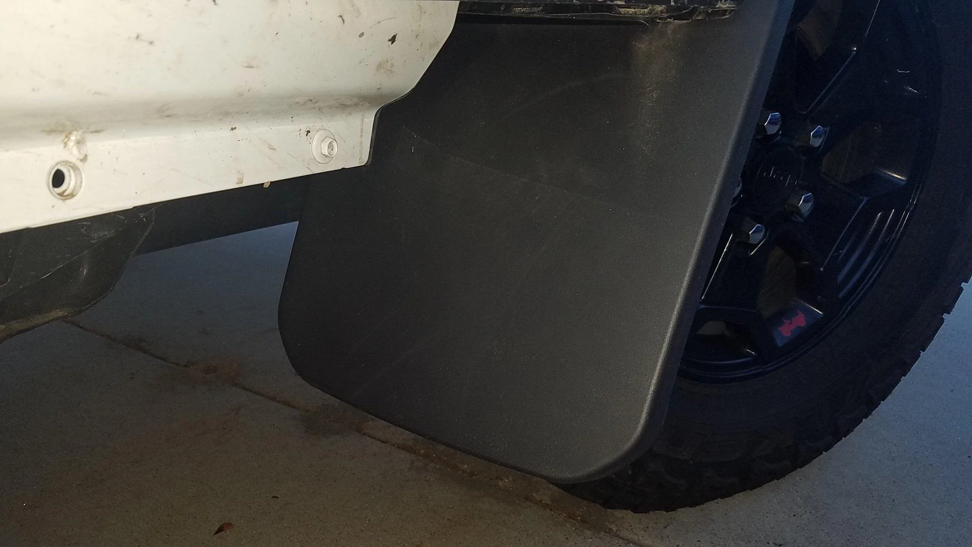

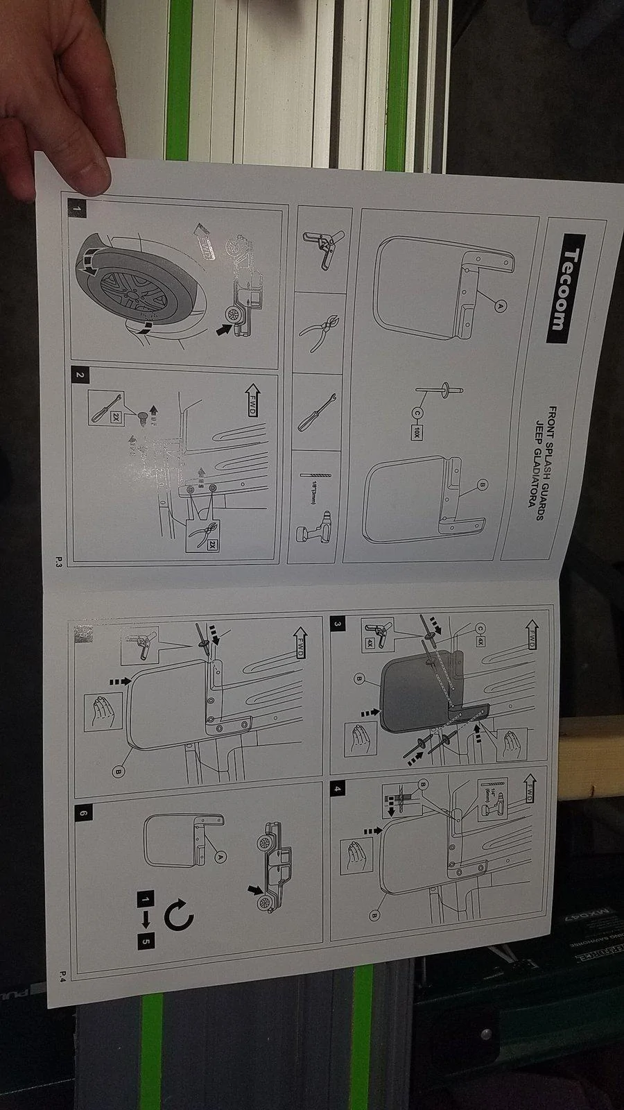

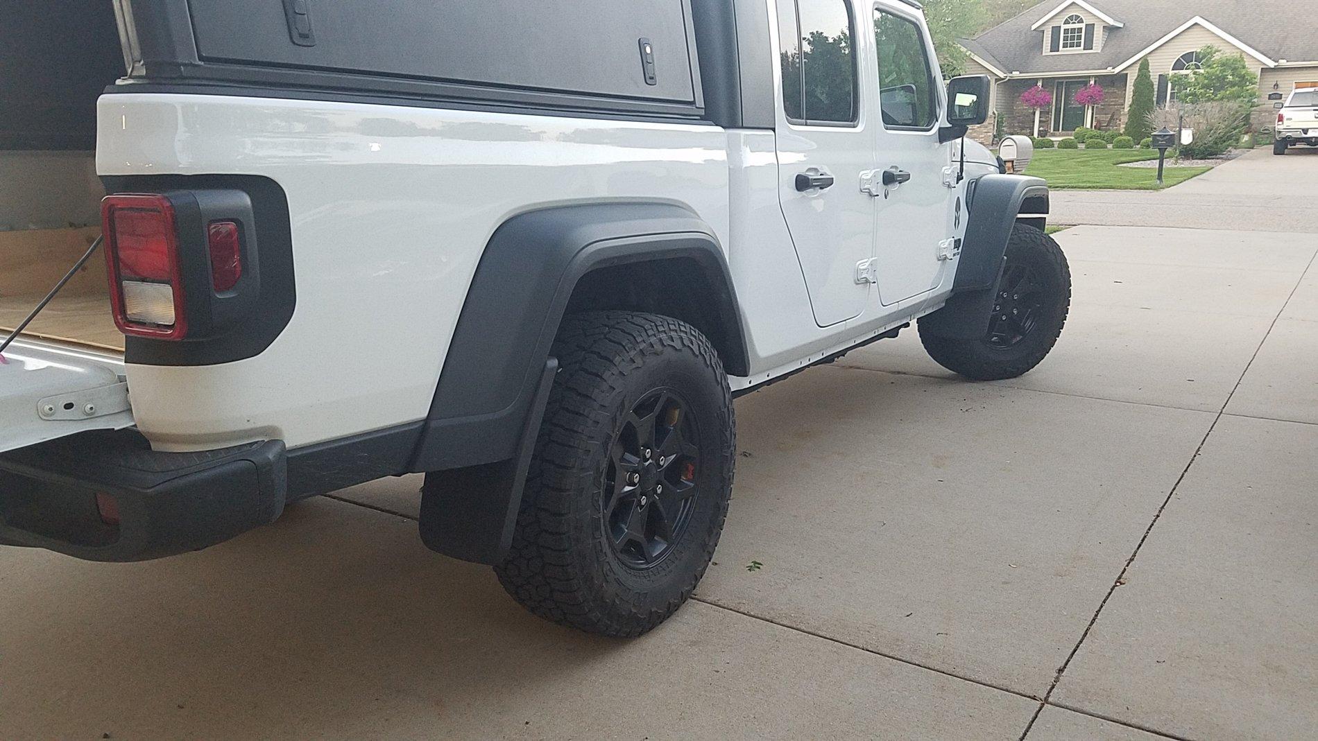

You need to remove 2 plastic rivets from the rear fenders and drill 1 hole. Can't drill or operate rivet tool unless you take wheels off rear.
Front can be done by turning wheels lock to lock. Take out 2 xmas tree things, secure with 2 rivets, drill 2 outside holes, install 2 rivets, move wheel to other lock, drill 1 hole, install rivet. EASY PEASY! :bandit:
Jeep Gladiator Teccom Mud Flaps Install 20200603_202949
Jeep Gladiator Teccom Mud Flaps Install 20200603_202956
Jeep Gladiator Teccom Mud Flaps Install 20200603_203010
Jeep Gladiator Teccom Mud Flaps Install 20200603_203032
See the nub that's left over from the rivet, use the small side cuts to snip them off. CLOSE YOUR EYES OR PUT YOUR HAND IN FRONT OF THEM. They will FLY!!!

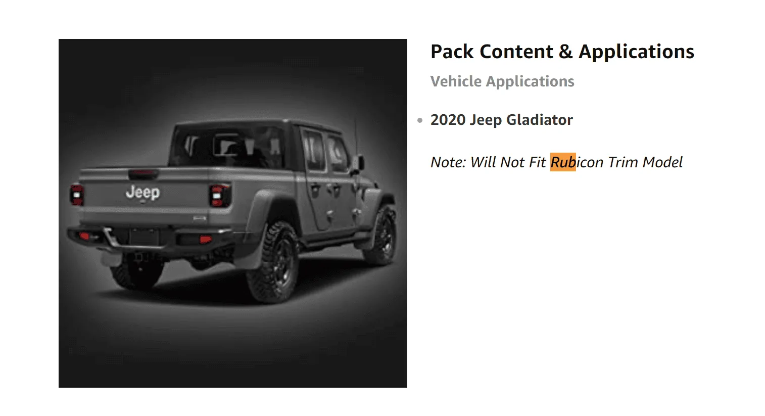

Nice-
i’ve been wanting to get a set of flaps but they either look ridiculous or they’re way too expensive for a piece of plastic.
Do you know if they’ll work on a real Jeep (I.e. Rubicon)? ;)
Real nice Smlo, bite the hand that feeds you. lol
Guess you'll have to invest in some Sport Fenders to use these flaps. :CWL:
Jeep Gladiator Teccom Mud Flaps Install 1591239826337

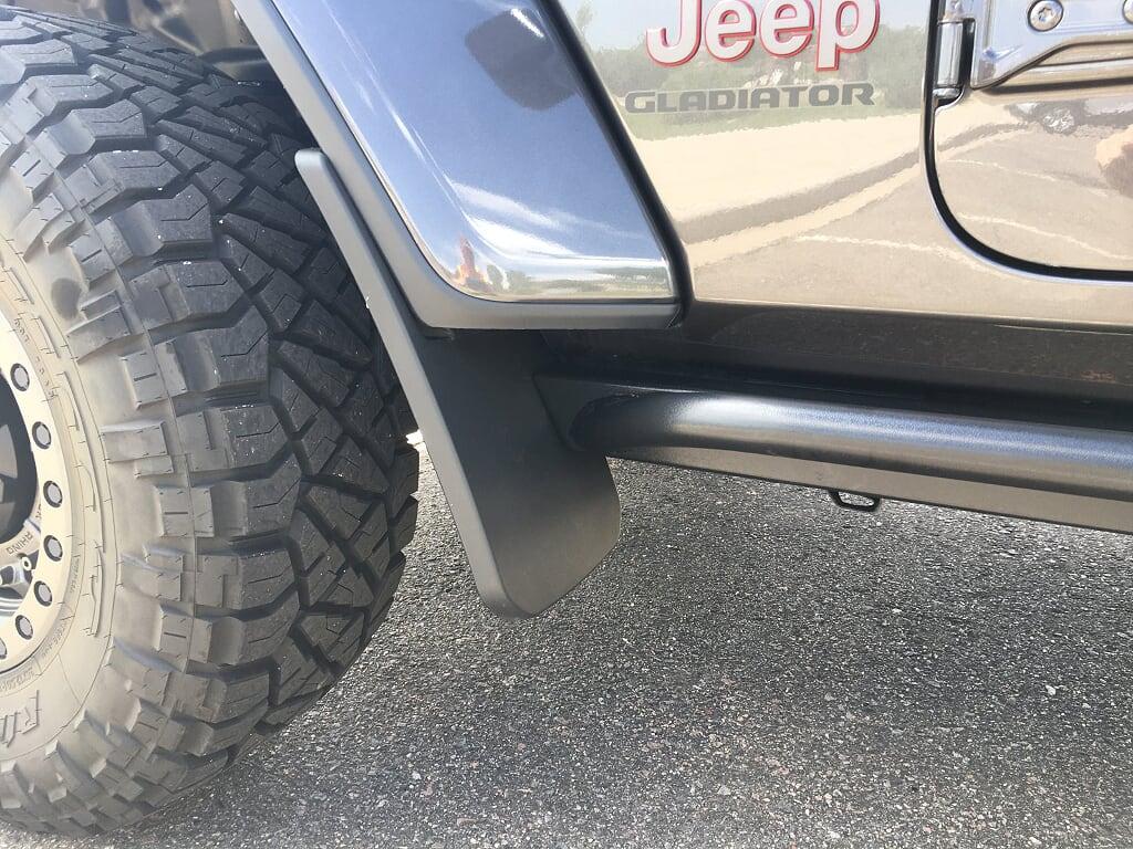

The only reason they would not work on a Rubi is the stock rock rails (they extend too far forward past the end of the pinch seam). Mine is a Rubicon and they fit fine, but I removed the stock rails and installed the Rockhard 4x4 Patriot Series rails (see photo below).
