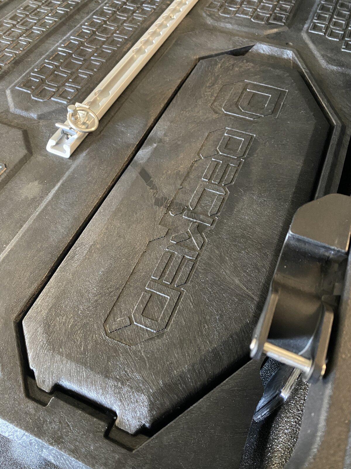

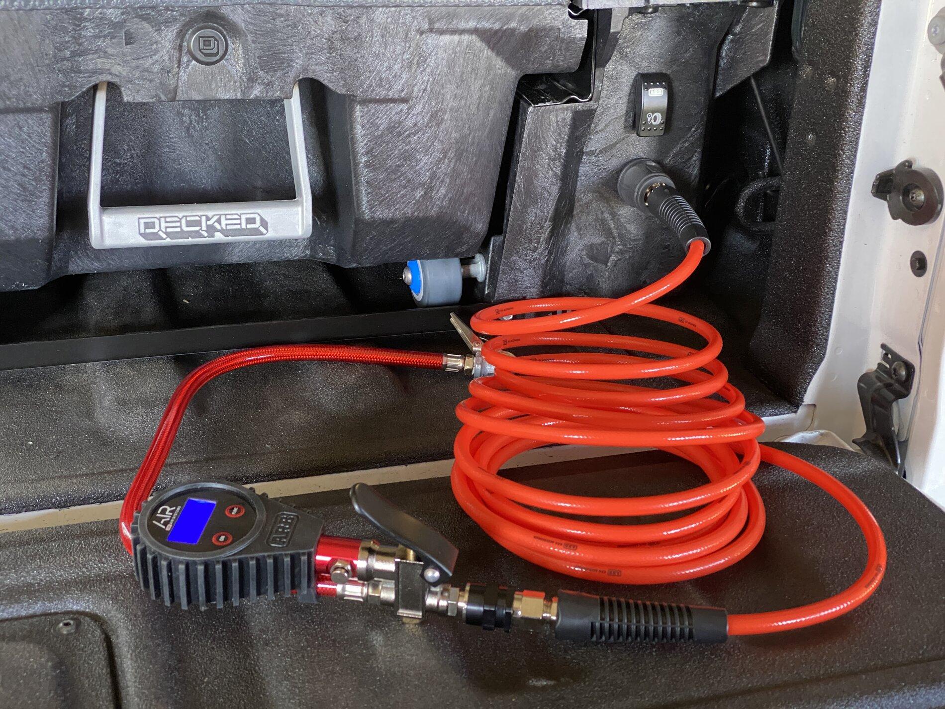

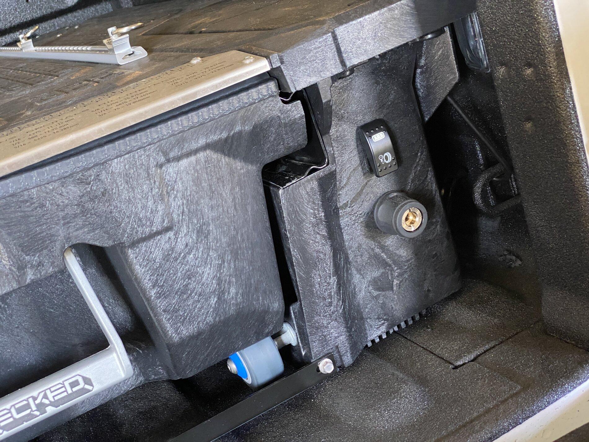

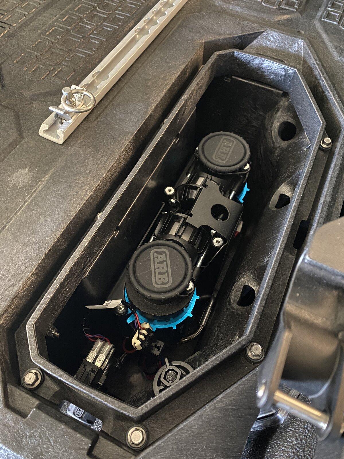

Got my DECKED three months after getting my JT.
Totally dig it. Only time I hate is when a friend asks if I can help him move large objects. I'm like, FCK!!!
Like the OP stated, I too added a Dual ARB compressor in one of the Ammo Cans.

I'm now playing around with the idea of putting a power inverter and an outlet in the other Ammo Can.
