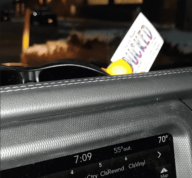

Today is Friday - and it happened again. 4 trips, stops in between, the last stop was back home for 2 hours then back out.
Temps ranged from 55 to 87 on the display, outside it was 18 to 22 degrees.
Last trip I drove into town to eye doctor and realized - it was COLD in that truck.
I took the HVAC out of auto and it jumped to AC mode. I turned off AC and it still didn't kick out warm air. It was a chilly drive back home!

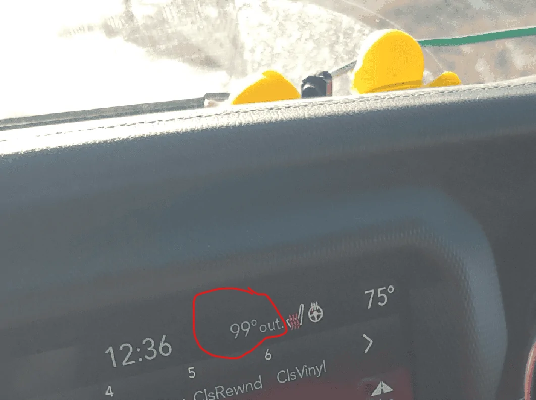

First time - Christmas. 0 degrees out, temps from 70s to 101 on the display. Cold in the truck, my wife said her feet and legs were getting cold and setting the temp to 75 made no difference.
It settled down the next day and worked great - even the HVAC kept us warm when the display worked.

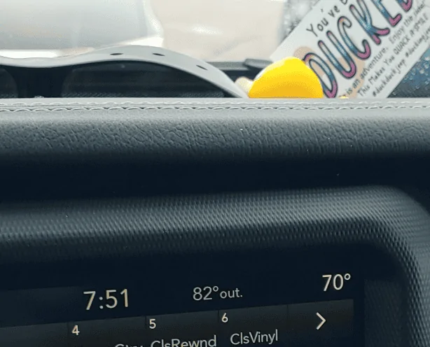

Today - first trip out, it was 18 degrees - this is where it stayed for a while - 50s and 60s -
Today - 22 degrees out, cool air coming out of HVAC. It said as high as upper 80s -
The higher the display read, the less the HVAC kept warm.

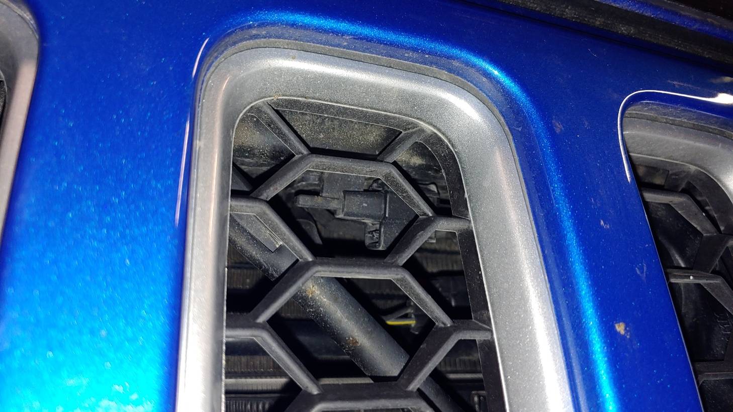

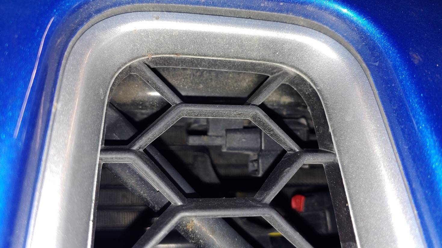

He spend a good 30 minutes with it and said the temp sensor is up behind the grill and wondered- did it only act up with the plow on? Well, it's possible. But then it happens even before the engine warms up, it's wrong when I first start it (he said if it's stopped for more than 4 hours it's supposed to read the current temperature where if it's stopped for less than 4 hours it would take a while to catch up - several minutes of driving over 40 mph. Dang, that service advisor is smart)
Anyway, I told him I had planned on dropping the plow off either today (LOL, right, not with dealing with a new Jeep for my wife) or tomorrow and I'd log everything I saw or observed.
He wondered if there was a dead air space, even a vacuum, caused by the plow.
He shocked me then by saying if we find a pattern there, he can look into moving the sensor so it wouldn't be less likely to be impacted by the snow plow. I can imagine some dealers might say "not our problem, deal with it" or shrug it off. Not him.

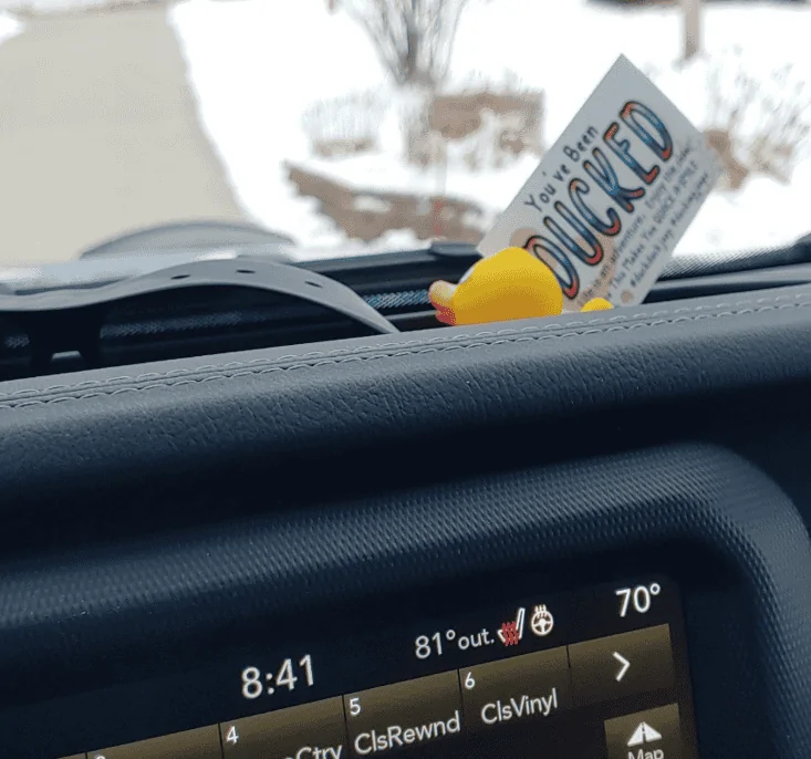

Another test. My wife didn't want to get "her Jeep" dirty or put miles on it so we took mine to her MRI this AM. I told her - plow on front, if the plow is causing the temp sensor issues, it's gonna be a danged cold ride across the county! The response - then you'd better warm it up inside fast.
LOL - so across town we go and this time the temps were off but not by a whole lot. I stayed in the 30s, then 40s, and hit a max of 57 by the time we got there (is was 6 degrees out) so we didn't get too cold inside.
On the way back home later the sensor had warmed and it said 67 by the time we drove the 40 minutes back home.
I decided to brave the cold and take the plow off after we got back. It was still reading high when I removed the plow.
A miracle, I decided to take it for a drive up the road after I dropped the plow off the front and watched as the temp slowly dropped down to 7 degrees (it had warmed up a lot outside by that time)
So, it appears the snow plow is creating some warp in the space-time continuum or some black hold vortex and sucking air from the engine compartment forward - even as you drive VERY slowly, like 25 mph. Really?
Even sitting still, that temp sensor reads incorrectly when the plow is on! What the heck? How can that be!
Plow on, temp sensor reads wrong, drive it and it reads even wronger, and the faster you drive the more wronger it gets. Remove plow and drive it a bit and it settles down.
