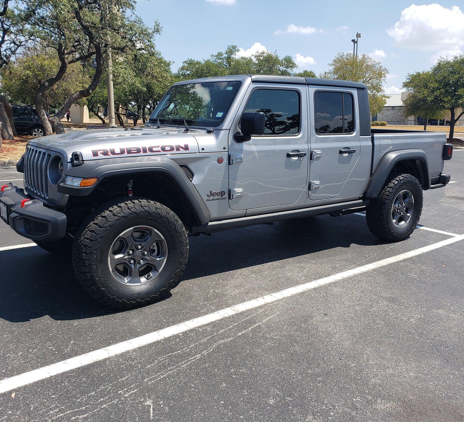

I installed the Teraflex kit a couple weeks ago. I just used the 1" spacer. No problems thus far.
I just installed the 1.5" Teraflex as well. used all the spacers. steering off a tad so off to damn Dealership today for alignment! smh
